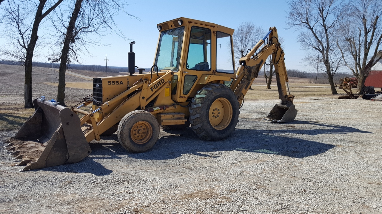

I've got $8,500 in this machine. Bought it 7 years ago. Have put hundreds of hours on it.
