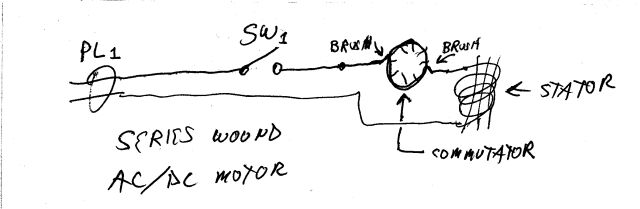

Son-in-law's Ryobi Plate Joiner quit, so he sent it to me to see if I could fix it. The obvious problem was that the red wire from the stator to the front brush got against the rotor, rubbed the insulation off and frayed the wire. Wasn't hard to cut the little bad spot out and splice the wire back, and everything else "looks" like new, but it still doesn't work. I've done the obvious for an amateur; i.e., checked continuity through the switch and wires to the brushes, but know very little about electric motors. Anyone have any guesses as to what might be wrong or what I could do to make this motor run again?

Bird, You didn't say if it was series wound (most likely) or shunt wound. Anyway, I think I followed what you did. You didn't say that you checked continuity through the brushes or ... oh well.
I assume you have an ohm meter with test leads to check continuity. Did you check with your ohm meter across the "hot" and "neutral" prongs of the power plug while turning the switch on and off? You should get essentially an "infinite" (real large) Ohm reading with the switch off and a lot lower value with the switch on. You might give the motor a spin with the switch on while checking continuity in case there is something "funny" with the commutator/brush contact. If this high/low resistance with the on/off switching doesn't happen then there is an "open" somewhere. An open could be bad brush contact, an armature or stator wire burned out from the short or something else.
The ohm meter should show a fairly low reading when placed across the stator winding (lower than with the rotor and stator in series) Likewise the rotor windings can be checked individually for continuity and should be approximately equal to each other. If one is open then it has a broken or burned out wire. Here is a couple ways to test the rotor for continuity with your ohm meter: 1. connect the ohm meter leads to the brushes and slowly rotate the motor. You should see a series of readings that are about equal, maybe with "glitches" in between since the brushes break contact with one commutator plate and connects to the next as you rotate the shaft. 2. If the rotor/armature is removed you can touch your ohm meter leads to opposite pairs of commutator plates one at a time and they should be about equall in resistance. If one is way high it is burned out or broken. If one is way low it is shorted.
Another test, with the armature out in your hand, is to ohm between each of the commutator plates and various places where there is bare metal on the armature. Continuity (a lot lower ohm reading than "infinity") between any commutator plate and any bare metal of the shaft or armature indicates a winding or commutor plate is shorted to the armature core laminations or the shaft.
These are repairable conditions if you don't mind carefully unsoldering the winding on the armature, unwinding it, counting the turns, and replacing it with new wire or if able, insulating a short or connecting an open.
These motors are fairly high speed but with care you can put the same gauge wire back or otherwise not unballance it too much when fixing a short or open. At worst you will fail, but so what, you don't have a working tool now,do you? Maybe you can fix it AND it won't vibrate too much from being out of ballance.
Let us know what happens. I would be happy to try to help further if you like.

Thanks to all of you for your help. Patrick, I think you've got it. <font color=blue>series wound (most likely) or shunt wound</font color=blue>. I have no idea what that means or what the difference it, but from your sketch, I'm guessing you're right about series wound. On this tool, the white wire from the power cord goes directly to the rear brush, while the black wire goes through the switch to the stator, then a red wire (the one that was badly mangled) from the stator to the front brush. I had noticed initially that neither of the brushes seemed to be making contact all the way across their face (scratches in the middle of each one), although they show every little wear.

Bird, Is there more than one way to put the brushes back in? They may eventually wear to fit but the process can be speeded up by lifting a brush and placing a small strip of fine emery cloth over the comutator, lowering the brush down to it, and rocking the armature back and forth to shape the brush while pressing down firmly on the brush. Also when "cleaning" the commutator use extremely fine emery cloth or the induced roughness will cause increased sparking. Make sure NO GRIT is embeded in a brush or commutator to cause accelerated wear.
If your motor looks like my schematic then it is series wound (it could be on the quiz). When you ohm the individual coils of the armature by contacting opposite pairs of commutator plates the resistance values should be nearly equal. If not you have a problem with the armature.
