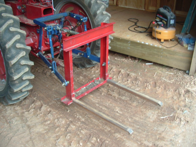

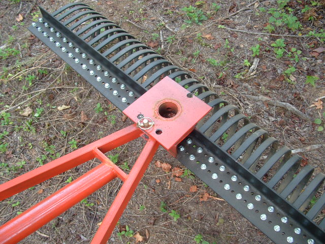

I build a lot of the stuff I use on my tractors, and generally from whatever I have laying around. Here is a landscape rake, and a set of rear forks that I made. I didn't have any plans but I knew what they are supposed to look like .
HTH, Later, Nat

would you by any chance have pictures of the other side of the forks that everything hooks up to? What did you make the forks out of?what kind of steel?
   / In Need Of Advice #6
tailpipe, I had 2 pieces od 4" chanel iron about 32 " long that I made the uprights from and the bottom is a 32" piece of 5" chanel, top crossmember is the same. The forks are two pieces of 2x2x1/4 tubing. I cut 2 pieces of 2x2x1/4 angle 2" long and then hammered them closed till they were the same width as the tubing and welded them on to the end of the tubing so they wouldn't get packed with dirt. I made the uprights 26 " outside to outside and the bottom pins are 10 " up from the bottom and the top cross bar is 28" from the bottom. I then welded 2 pieces of 2x3/8 flatbar with a 3/4 hole in it for the top link.
I don't have any other pics now and it is raining, but will take some when it clears up. I'll also take some if my plow and disc incase they may help' later, Nat
