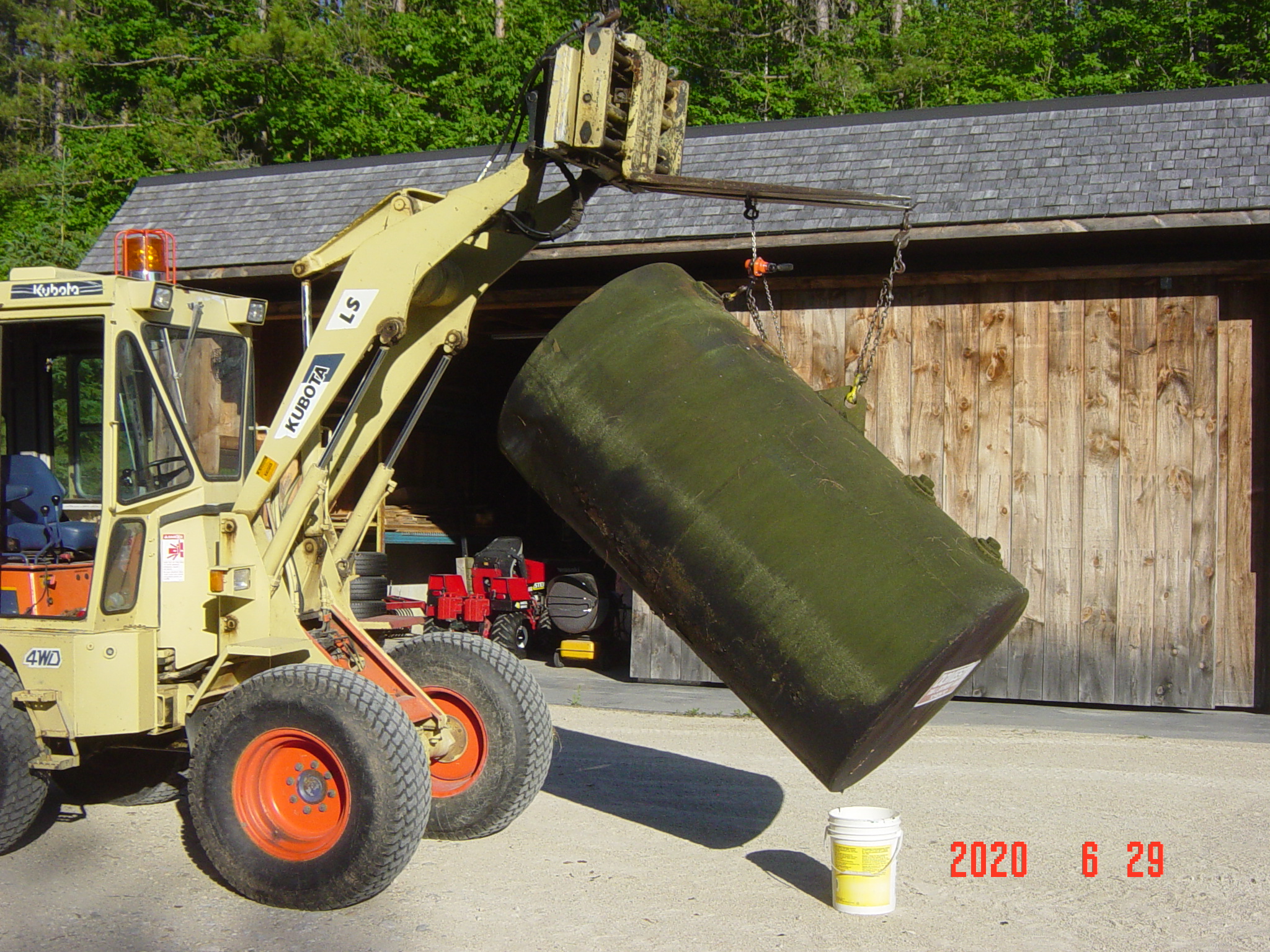

DSC02176.JPG Different machine and forks/bale grapple. Used this arrangment for decades now to transport brush. Handles much, much more than a normal grapple, you can compact it repeatedly when handbombing branches and it doesn't dig into the turf like a normal grapple. Downside is, the forks are almost useless for normal service. Grapple comes off with four bolts but it's a hassle.

View attachment 679005 Different machine and forks/bale grapple. Used this arrangment for decades now to transport brush. Handles much, much more than a normal grapple, you can compact it repeatedly when handbombing branches and it doesn't dig into the turf like a normal grapple. Downside is, the forks are almost useless for normal service. Grapple comes off with four bolts but it's a hassle.
You mean the pallet forks are also hyd adjust?

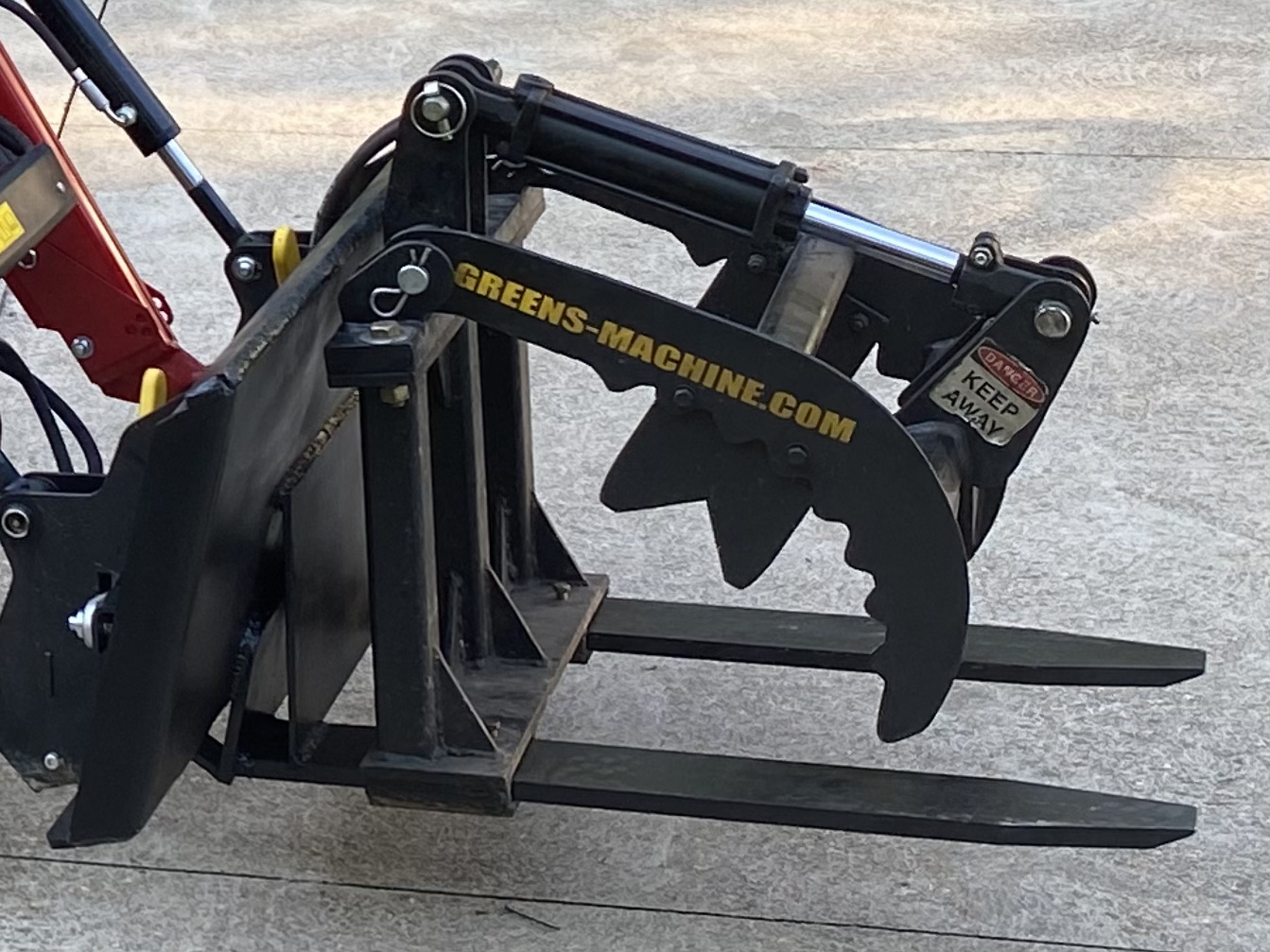

Pallet forks with PT adapter plate is getting welded up now.
After that is done, I would like to add a removable grapple to the pallet fork implement.
I think this one would work nice?

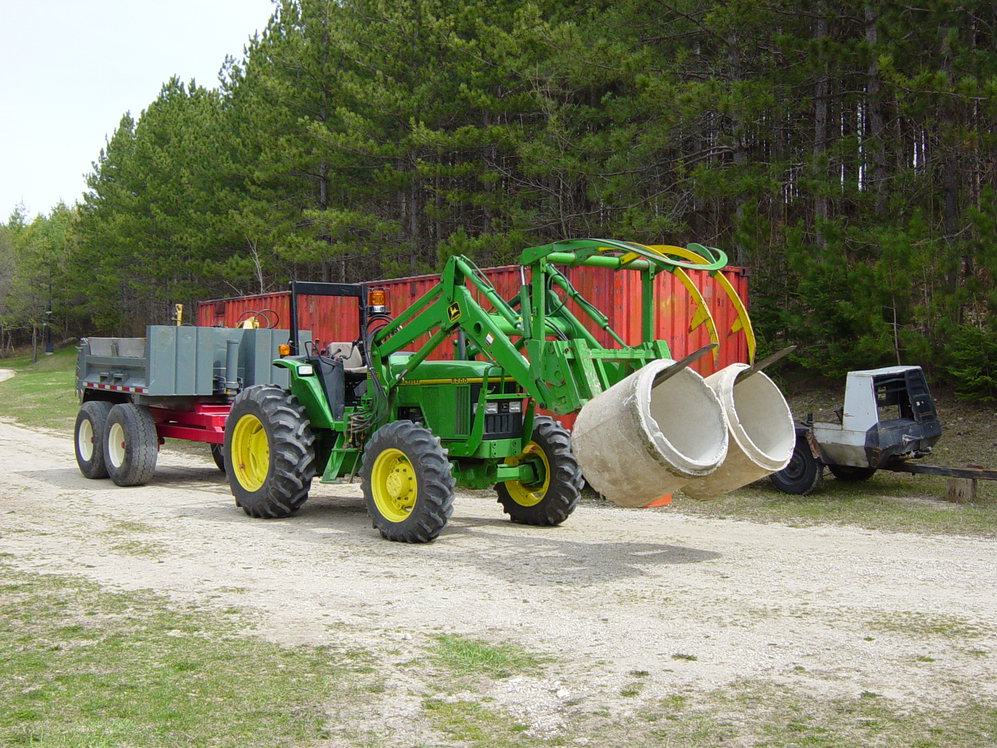

This is what I made for my power Trac when I had it. The attachment plate has since been cut off and the forks welded to a SSQA plate so the THUMB can be used on it. It is made so the grapple is removable.

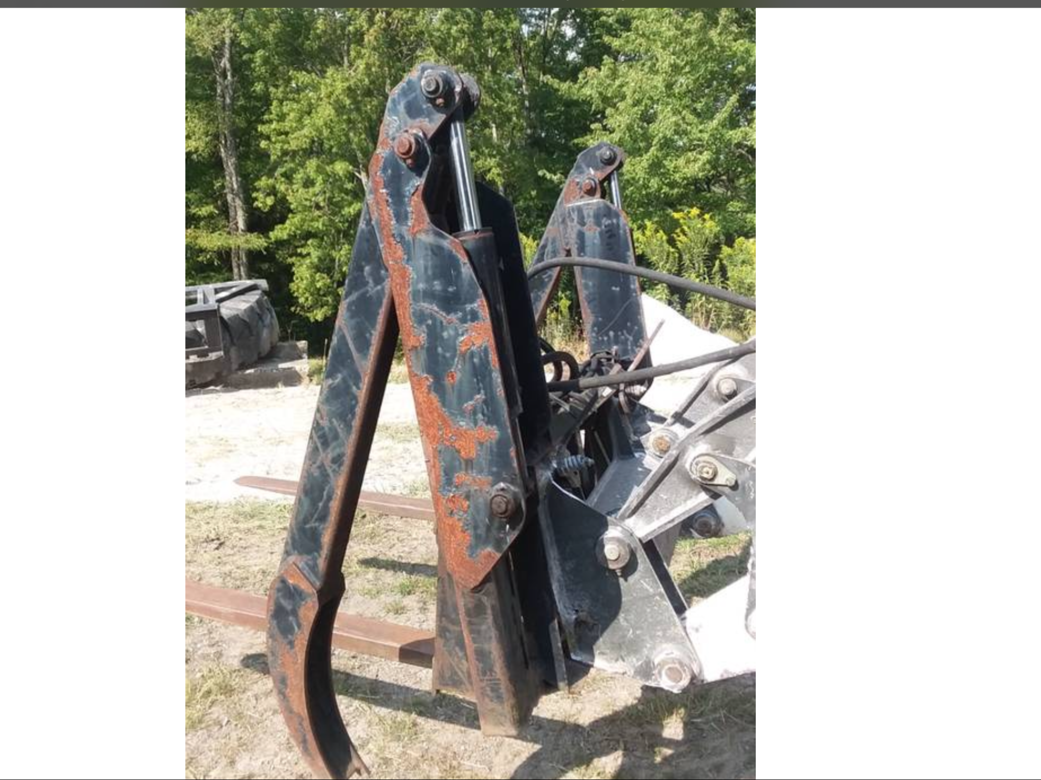

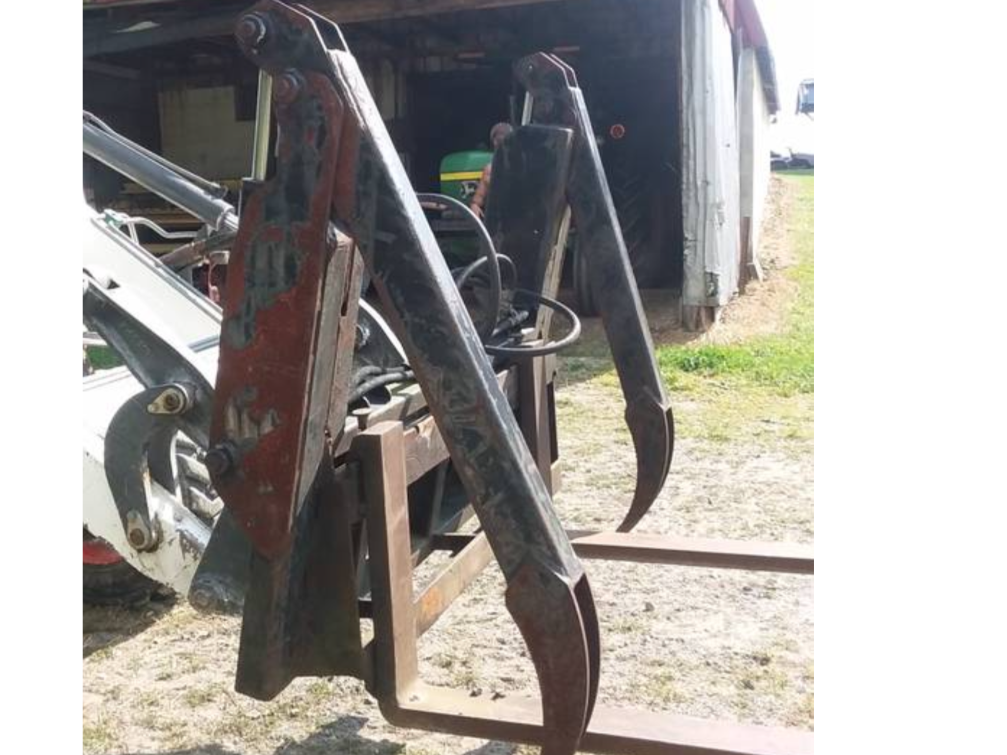

Used Bobcat 48 inch
asking $3000

   / In honor of MossRoad sugesstions. Pallet Fork Add a Grapple #18
Seems like a killer deal if it included a functional Bobcat on the end of it.
Yeah I thought he was asking a little much. Said he was open to offers.
Bobcat attachments fetch a pretty good amount. They are well built heavy duty attachments
