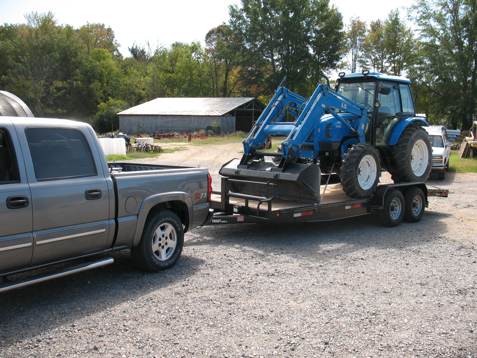

IMG_1135.JPGAre you wanting 10K for each axle or 10K combined. I bought my trailer in Conroe, it has twin 6K dexter axles with electric brakes on each axle. Here is a photo of it with my LS P7010 loaded on it.

10k each axle. Either gooseneck or pintle hitch. I won't be loading 20k on the axles the load will be more like 15-16k on the axles depending on the weight of the trailer.
