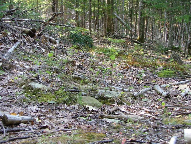

Thank you all for the input. It seems that most of you think it will not work too well. I guess I will use some gravel as fill and as CHARLZ said I may just try to rent a back blade and see how it works before laying out the $$$. I LOVE WORKING IN THE WOODS so it will not be a chore. The trail itself is mostly done by hand tools. It is just so nice to walk out there with a bow saw and a small ax to clear some brush and fallen trees. I used to haul out wood with an ATV and I regularly go for walks on it. I cleared a wide enough path to make it passable for an ATV and a 3.5ft wide trailer. The way it shaped up was: wherever I could go without cutting down trees, because I hate to just waste the forest for my convenience. I will try to post a few pictures I took this morning on my regular walk with my son.
The first picture is the bridge I built over a very soft area. I used to drive the ATV with the loaded trailer over that thing. I will reinforce it before I do the same with the tractor.
Second picture is a section of the trail that I recently improved using the FEL and gravel for filling.
The 3rd is the ATV I sold to pay for a good portion of the tractor and the 900lbs capacity trailer I made that is still in use. this picture is from last year.
Have you considered building the trail using mulch created by chipping/shreding the downed tree limbs etc. visible in picture 2? Mulch is MUCH better for the trees becuase it cushions the roots and eventually breask down into nutrients for the trees. It makes a great walking path.
To do this you could use a PTO driven chipper/shreder and simply mulch in place the downed material to the sides of the path as you go.

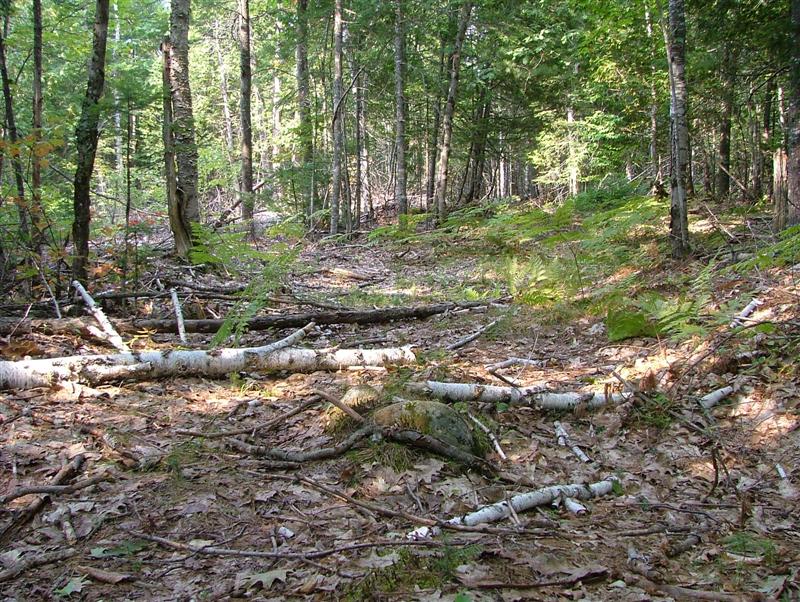

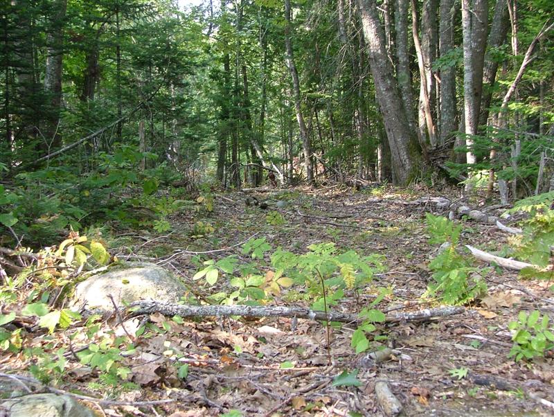

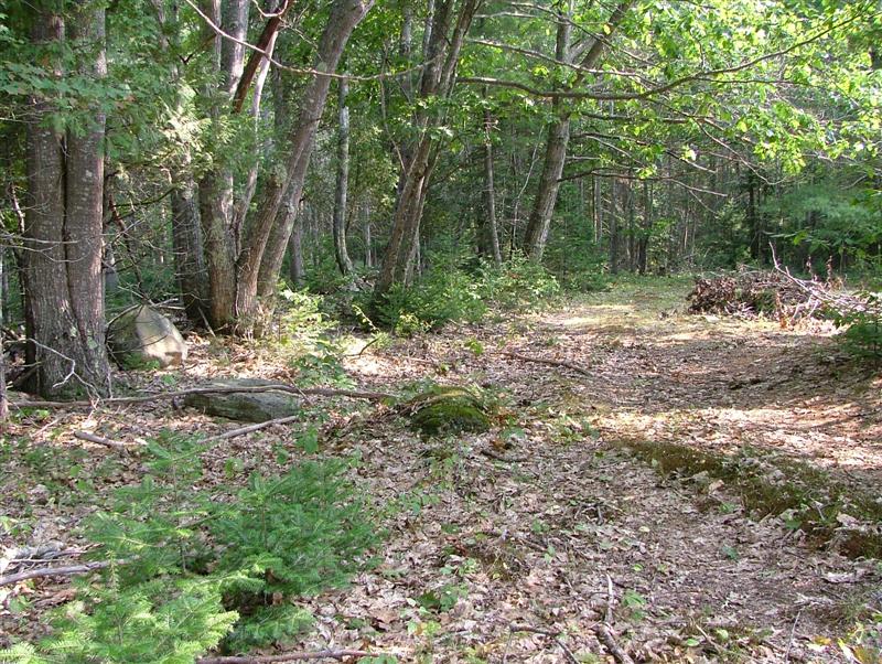

I am sure your blade works fine on your soil. But hear in Maine things can be a little different. Here are some shots of a few trails I am restoring on my property. I don't think easygo would make much progress with his B series tractor and a back blade on trails like these.:D:D

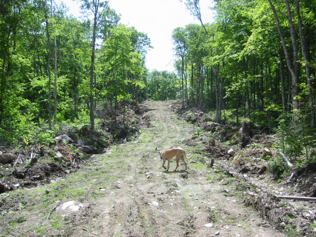

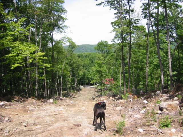

I agree with GaryE and atgreene! I had a large Linkbelt and medium JD dozer come in and put the roads in on my land 3 years ago-see pics. I just figured out now that my B7800 isn't a dozer and while it can do some maintenace what I could really use is a Bobcat track loader with a blade on the front of it!
