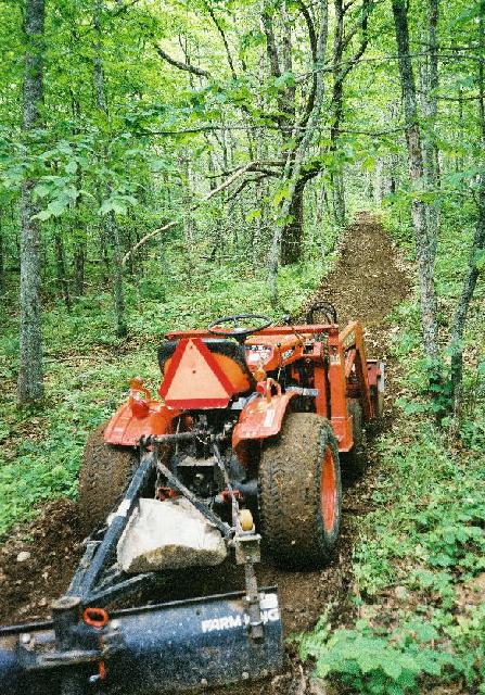

Using the bucket and a back blade will work. It's easiest if you have gauge wheels on the back blade.
Picture of a trail made by bucket and back blade.

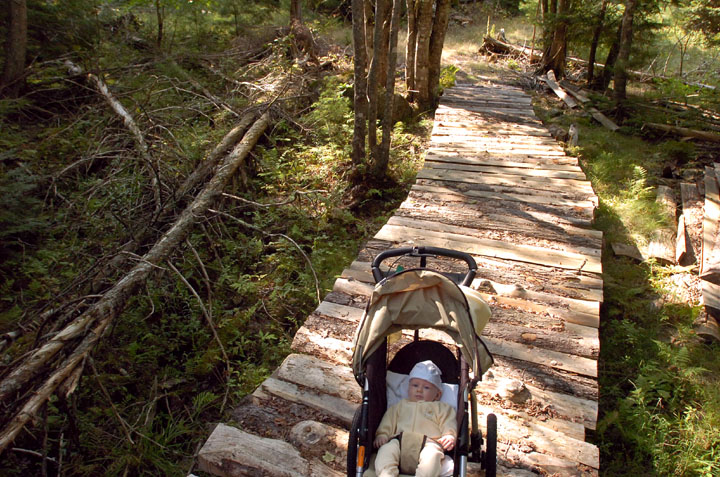

The first picture is the bridge I built over a very soft area. I used to drive the ATV with the loaded trailer over that thing. I will reinforce it before I do the same with the tractor.

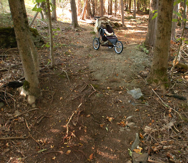

Second picture is a section of the trail that I recently improved using the FEL and gravel for filling.

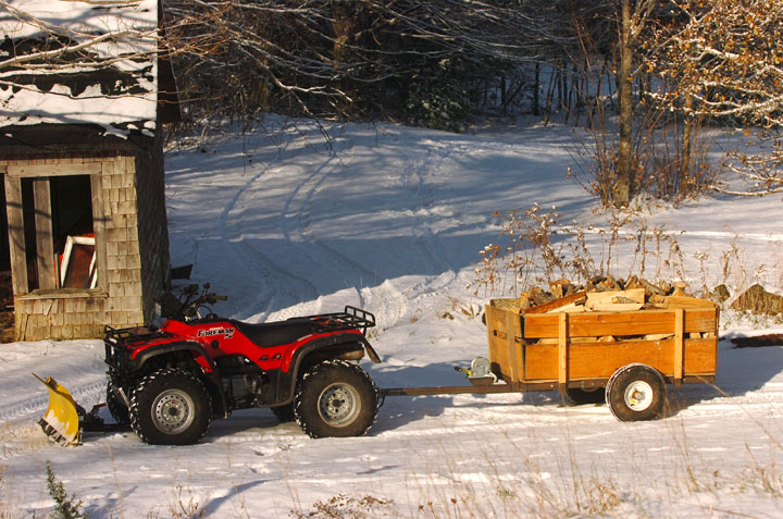

The 3rd is the ATV I sold to pay for a good portion of the tractor and the 900lbs capacity trailer I made that is still in use. this picture is from last year.
