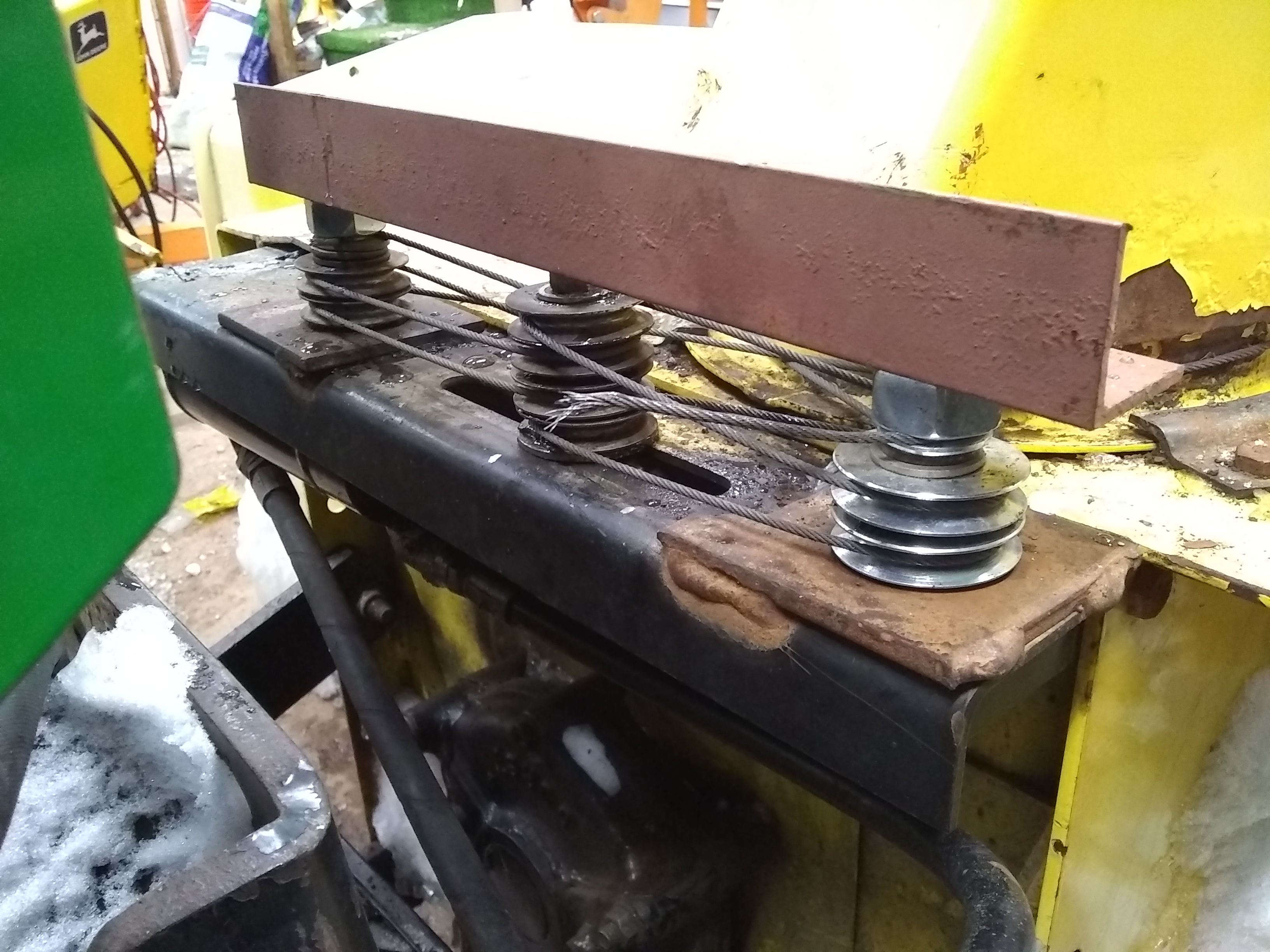

I got tired of only having 180 degrees of chute travel so I bought an extra two pulleys and bushing and some wire rope. By adding two more pulleys to the center and anchoring the cable to the static shafts I get enough more rotation to just kiss the grill guard on my 4300 when fully lifted. Just used it for the first time tonight and it is MUCH better now in the wind and coming up to doors.
Figured I'd share in case others were interested. Should be possible on most Deere front blowers.

Nice job. I bet it is handy to use. It also reminded me of a thread years ago where someone did the same thing on a smaller Deere 2 stage blower. I wish I could remember more about it so I could find it and reference it here to inspire inquisitive minds. He had a truck load of pics and detailed instructions.
   / Improved chute rotation mod for 59 snowblower and others.
I meant to take more pics, but by the time I started doing it I was done!
Of the top of my head, you'll need
two of these: M85382
one of these: M85614
two grade 8 3/8" x 3" bolts
one grade 8 3/8" x 5" (might be +/-5") bolt
A bunch of 3/8" washers
two 5/8" nuts (I used them as clamps to hold the end of the cable, they slip over 3/8" nuts and then another 3/8" nut and washer forces them down to clamp the cable.)
I also have a piece of angle iron added across the top to help hold the pulleys from bending the bolts if the chute freezes.
So far so good, I've used it a few times now. The cable has loosened up a bit since initial installation, I'll need to tighten it up.
