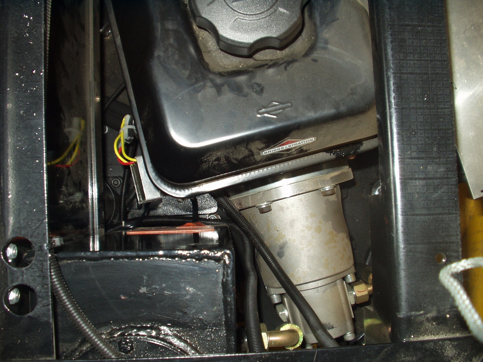

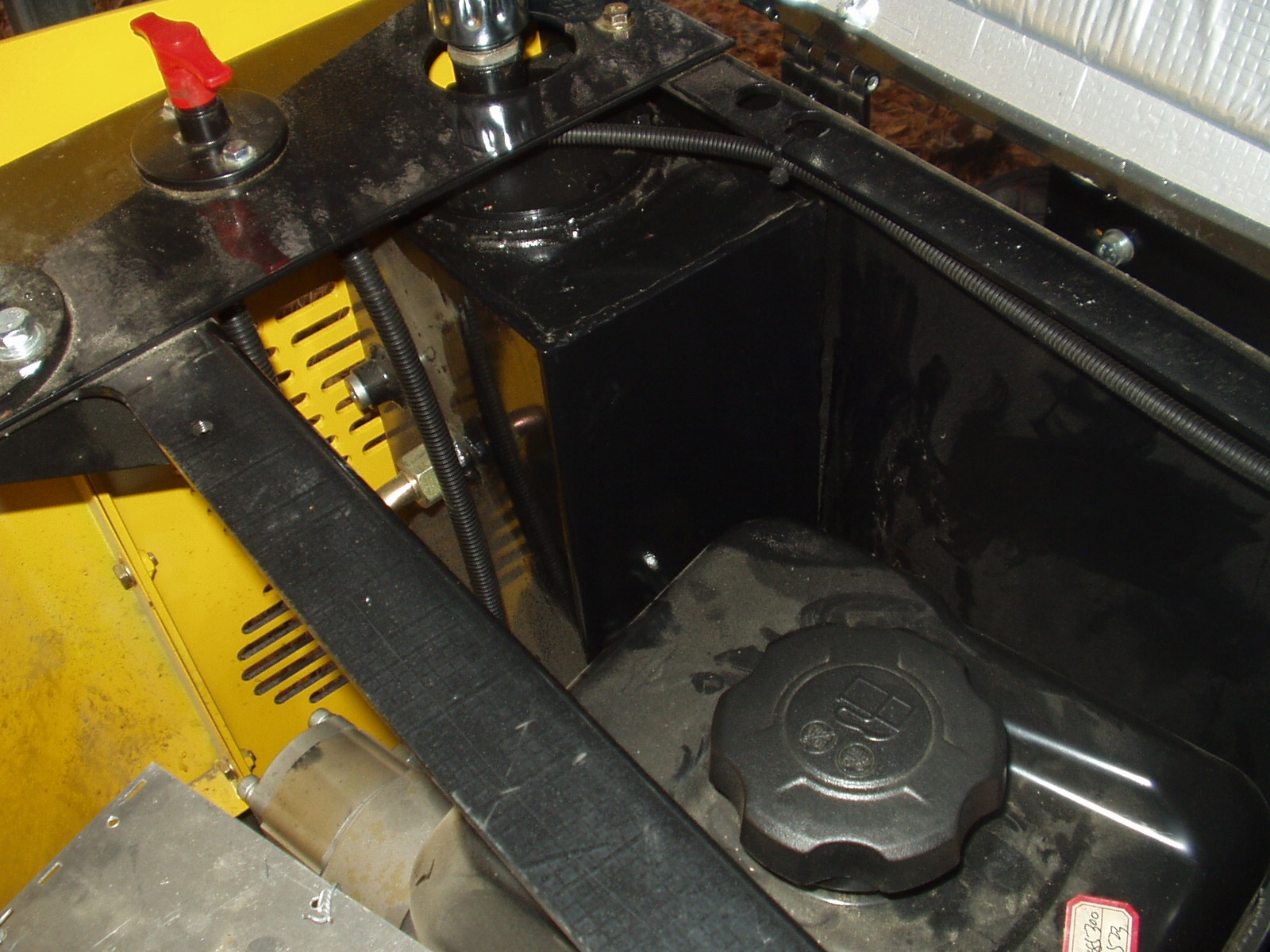

On the Typhon the hydraulic tank is vertical mounted on the forward left side which allows spacing between the bottom outlet and the upper inlet to tank. Pretty much no way to lose hydraulic flow if the tank is kept filled within sight glass range. However because of its placement they had to kick the B&S engine slightly out of square mounting as versus what I see of the AGT models. It is interesting the different approaches that different factories have taken to build these excavators.
As I mentioned before, the earlier (original, whatever that was) design was using the Koop or ChangChai 1-cyl diesel engine and a spline coupled pump. When they switched to the gasoline engine, they also switched to a Lovejoy-style coupler, which is much longer.
The Lovejoy coupler is better, but now the gas engine did not fit very well in the house. Instead of a total redesign (as I did) of the internal layout, many of the makers just shoe-horned the engine in at an angle, and eliminated the air cooling duct.
I ripped out and tossed the diesel fuel tank, plus flipped the engine around and cut a new air duct inlet into the house.
I suspect the hyd oil tank is a bit small for the pump flow rate. So, balancing tank overflow against pump starvation is more sensitive than it should be.
