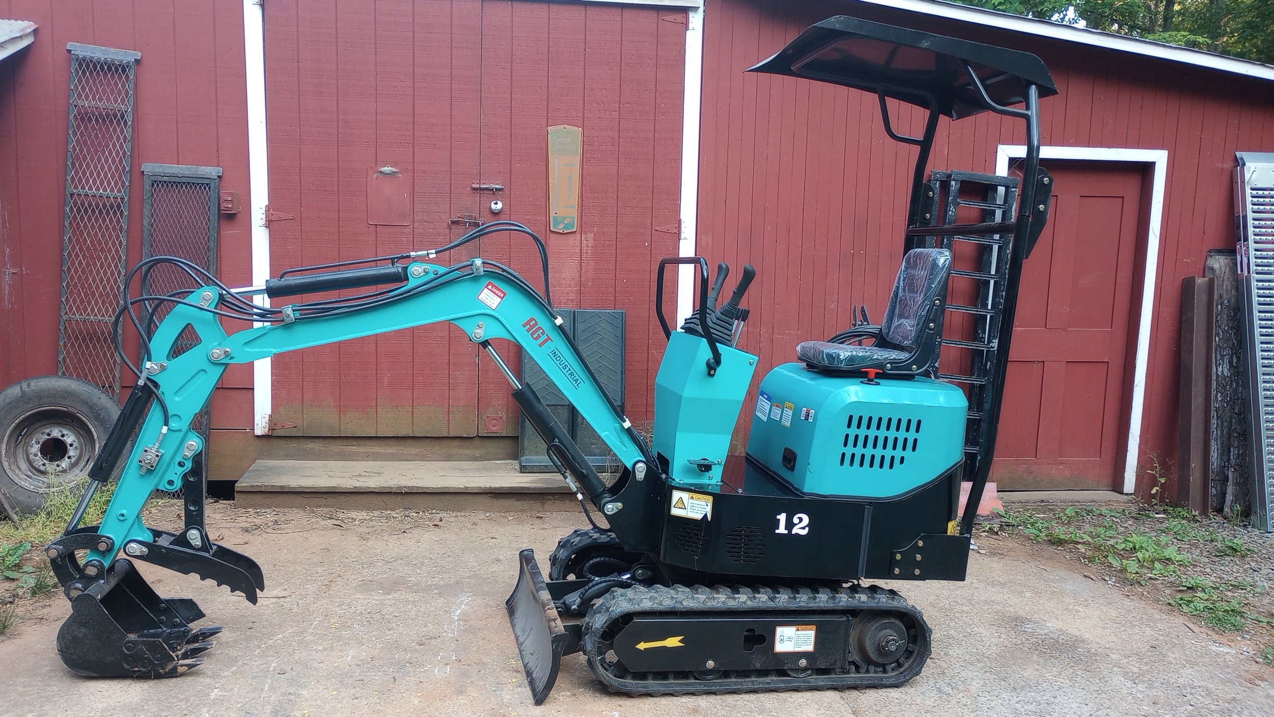

Hey Folks , got some pics for you.

Made it back without incident. 5 1/2 hours each way. My assessment of AGT Industrial/ Agrotk is not a bad machine for the price of a zero turn mower. I'm sending pics that I hope will help others.

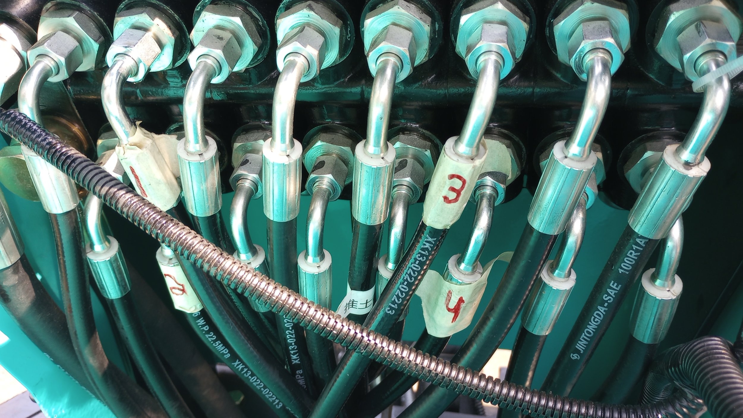

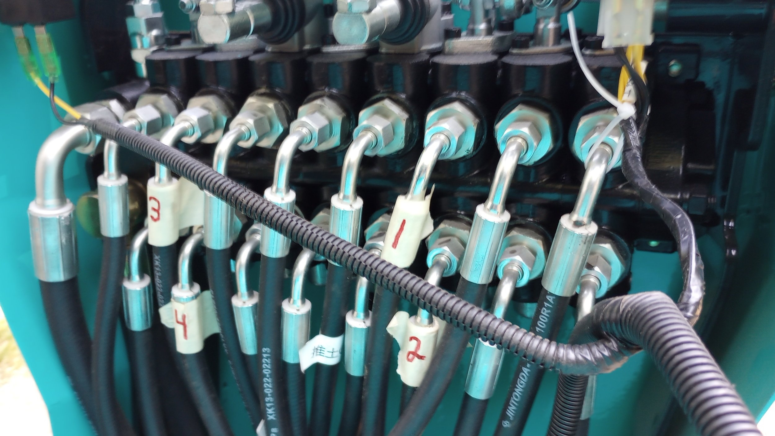

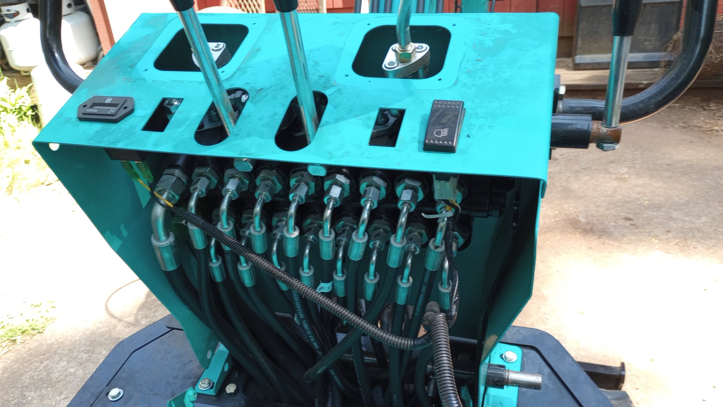

Here is how I switched from Excavator to Backhoe controls

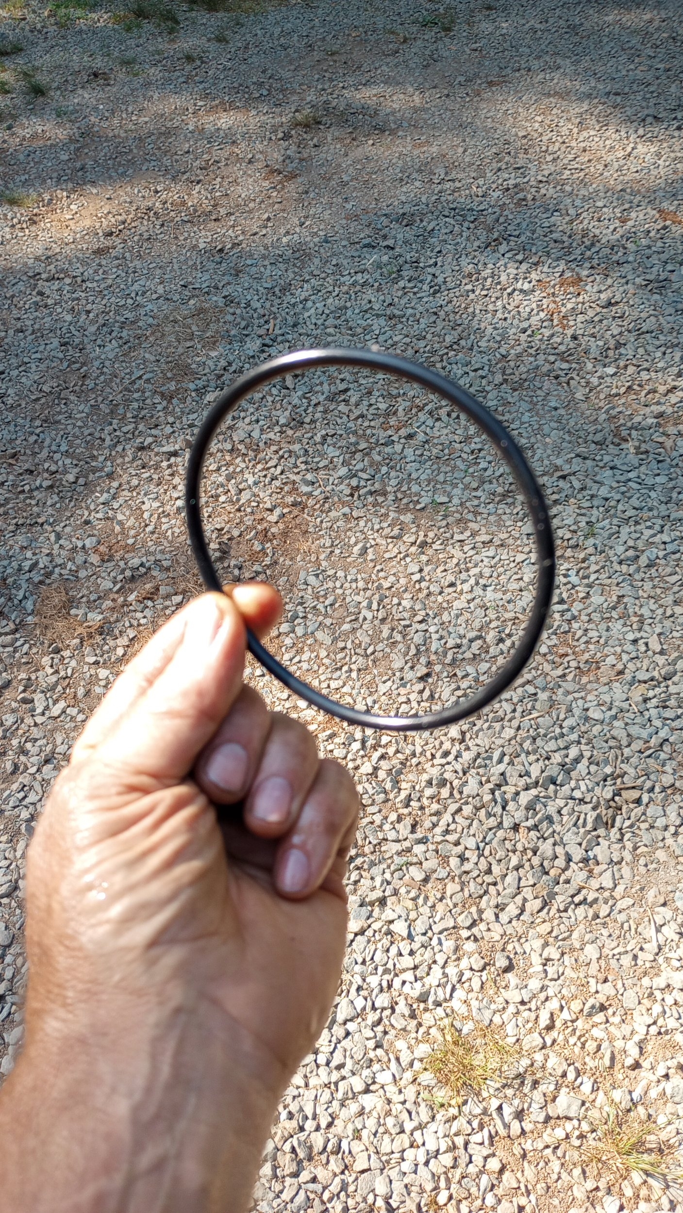

I wondered why the trailer floor was covered in oil. I removed the cover plate/floor of the machine and found this.

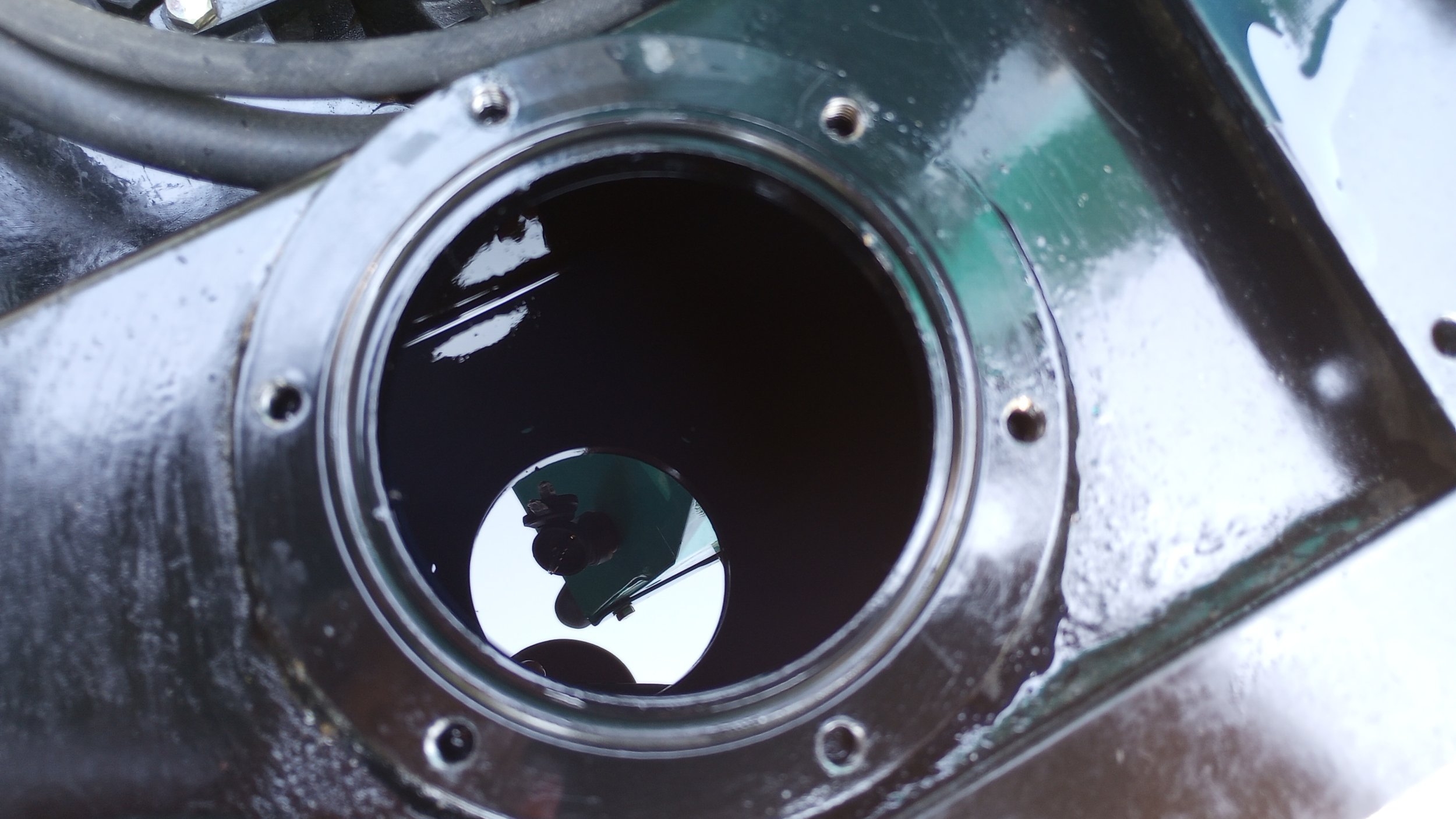

   / Importing and modifying a new mini excavator from China #430
Didn't take long to figure this one out. Oh! Thats where that goes.Of course , easier to fill the hydraulic tanks on multiple machines by zipping off the tops.
