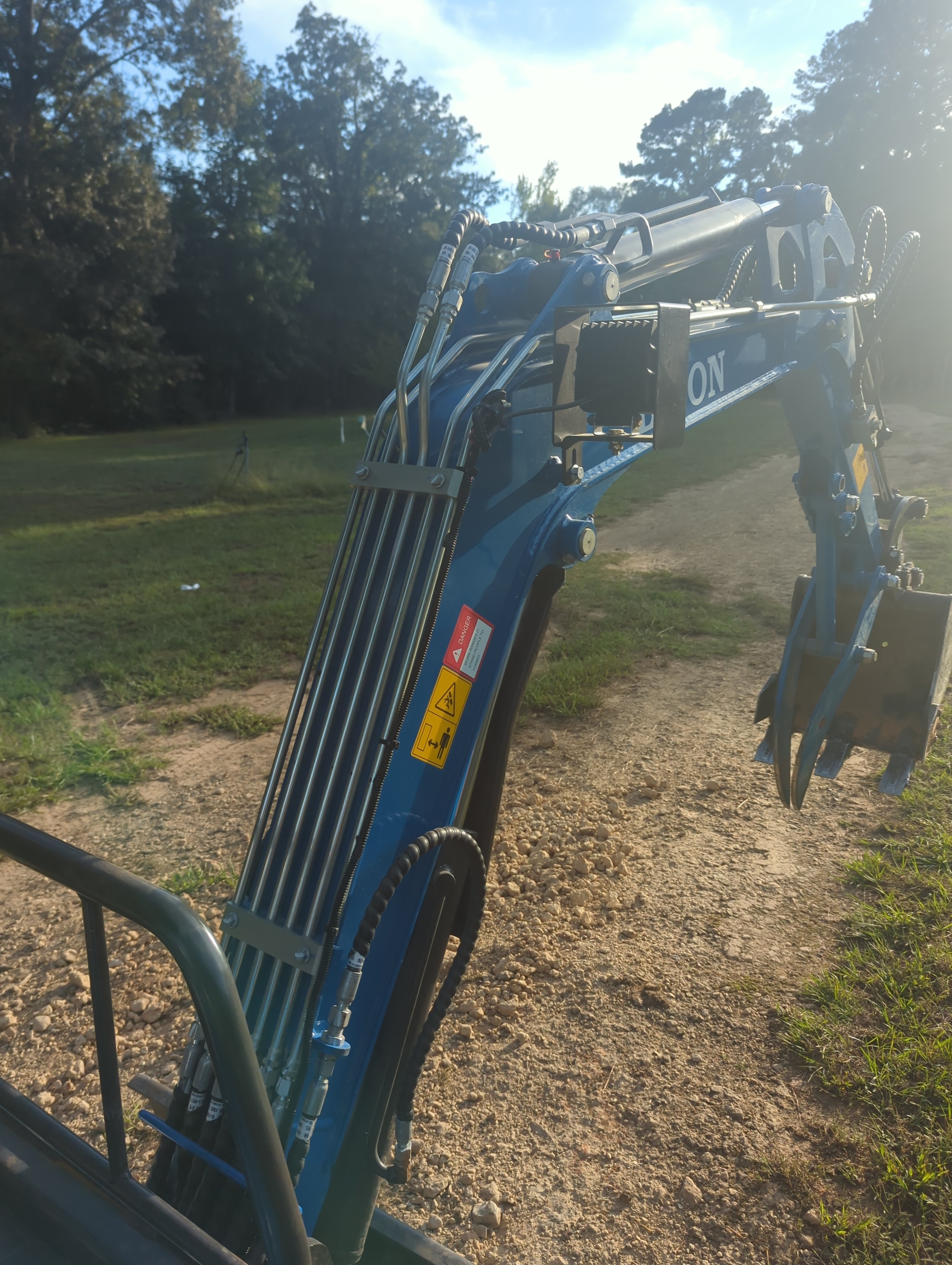

So far I am loving this machine. Been on it all day for the past few days. The bucket seems well built to be but since I do not have much of a reference I have a few pix here of it. The mechanical thumb on the other hand is pretty big and while the way it came it straddled the cylinder when it was fully curled in. But after using it I have managed to bend both tines in and have hit the cylinder guard. I recall earlier in this thread it was discussed about putting in some bracing to prevent the tines from bending. I guess I should have done that before I got to work. Once I figure out how to bend them back out I will weld in some bracing.

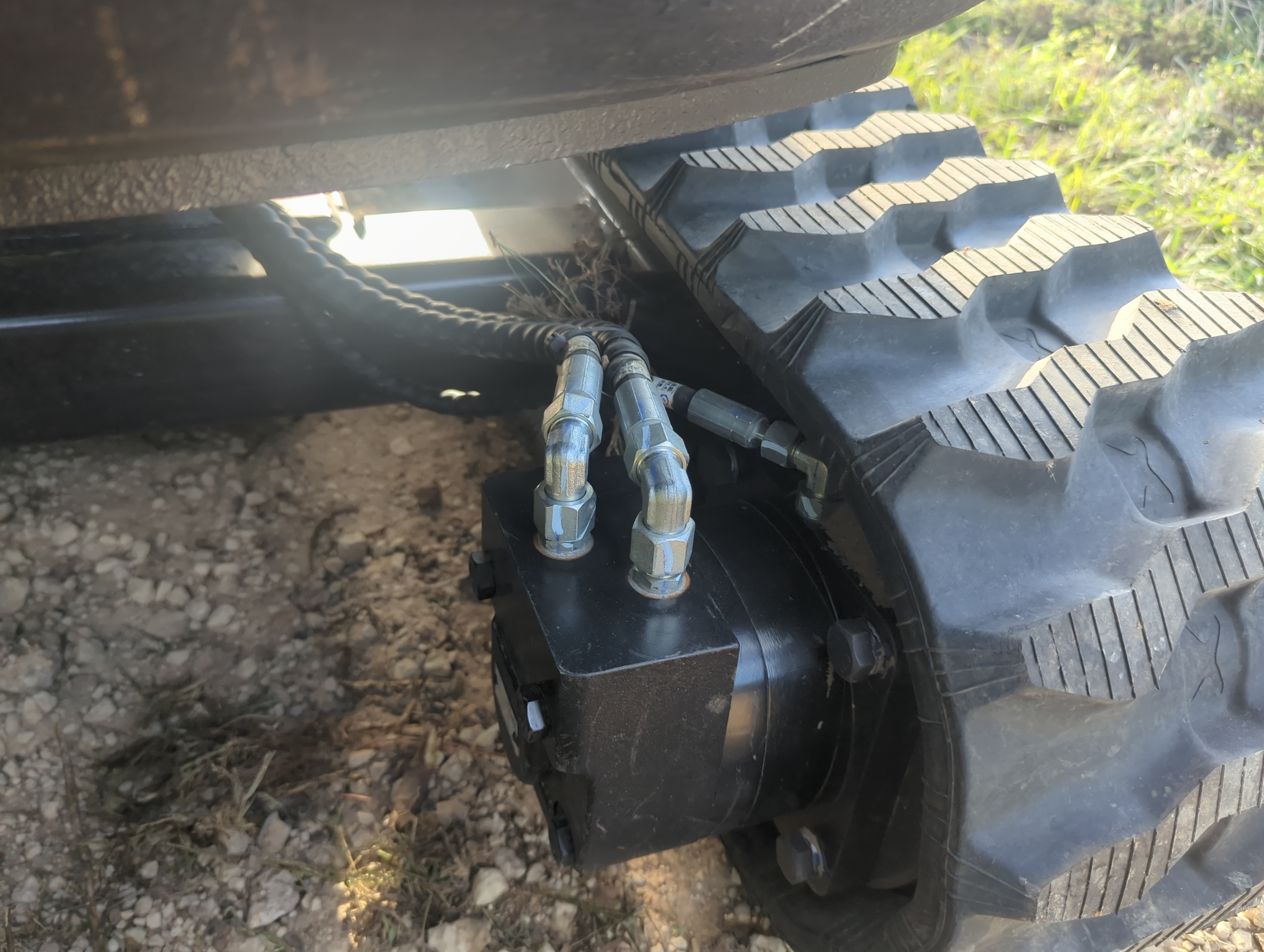

One question I have that I have not seen the answer to is what is the 3rd hose on drive motors?
That is a "case drain".

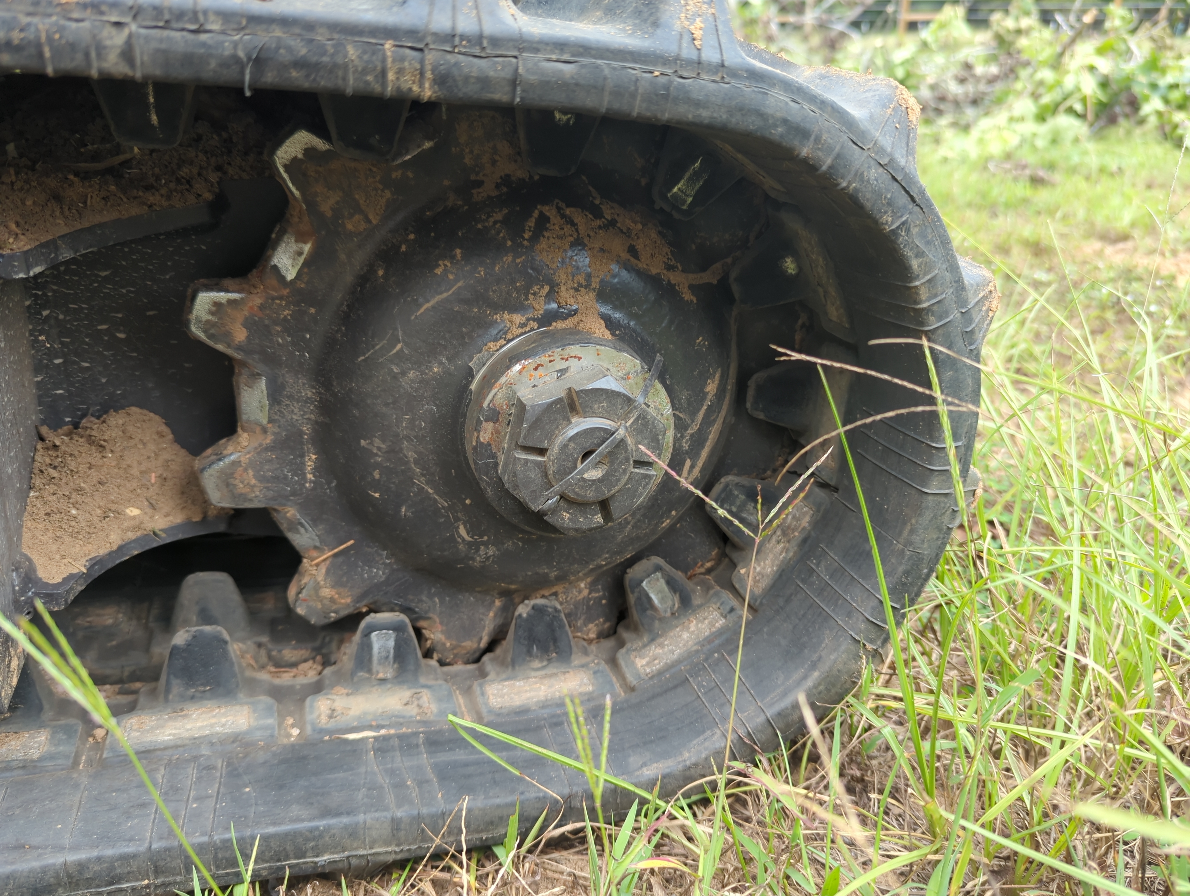

I am curious about your sprocket drive motors. No wheel braking is a serious flaw in most of our Chinese minis. Take a photo of the outside of the drive sprocket.
Once the rain cuts out I will go get some measurements and photos.
Here is a photo of the drive sprocket.
Looks like the usual gearoler-type wheel motor. No wheel braking action.
I will bet you do have hyd oil filtration and cooling.
