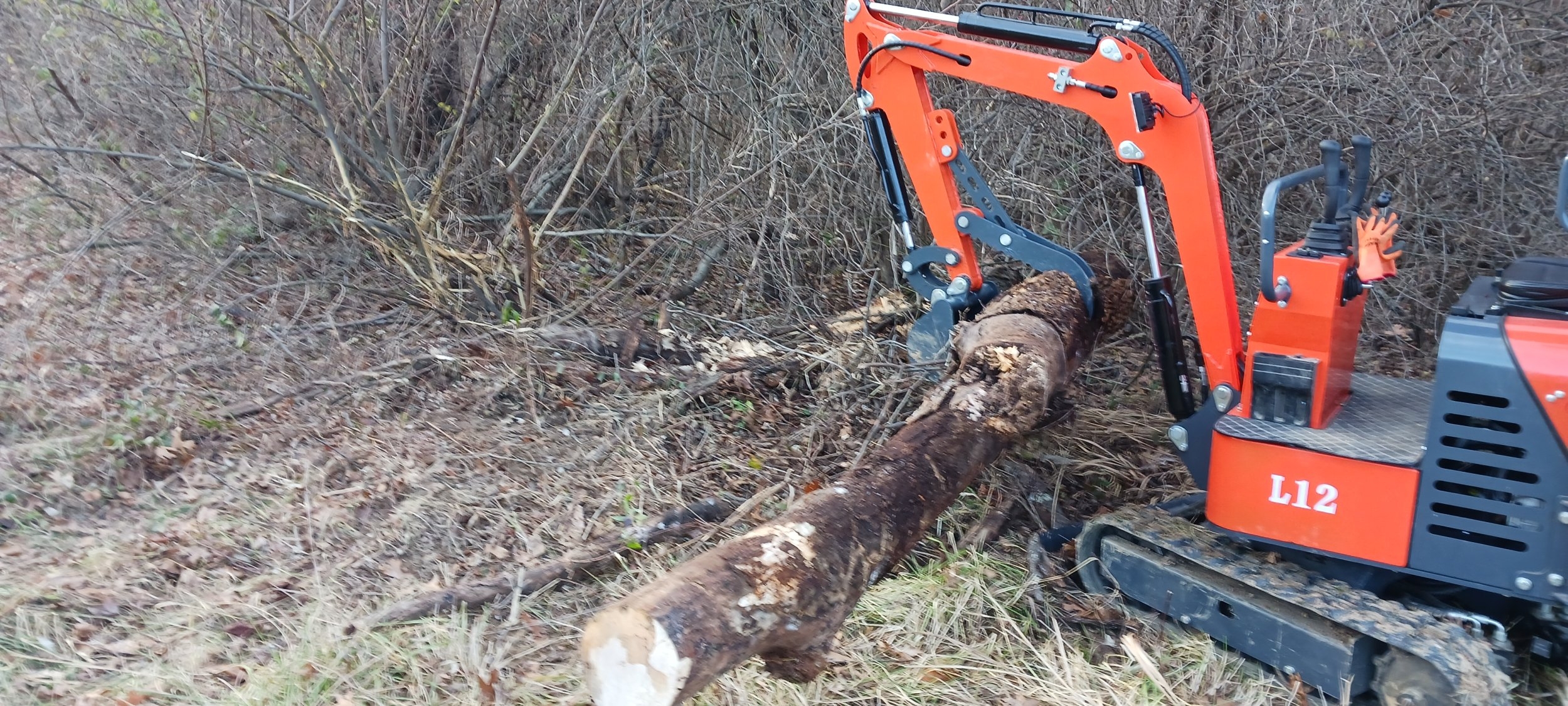

Hello All. I'm new to the group. I just finished reading the comments from start to finish and wished I had done so before picking up my AGT L12 at auction about a week ago. I paid $4225 plus auction fees and sales tax for a total of about $4925 out the door. There were 22 AGT units up for auction, only 2 L12's, a couple of H15's, and the rest split between H12's and QH12's. All of the units went for low $4000's except for the H15's which were low $5000's.
I liked the L12 because of its openable "hood" and that it comes with a hydraulic cooler. Sadly, no spin on hydraulic filter, which I plan on remedying asap. The lcd hour meter was full of water and no functional, since replaced with an electric/mechanical style. The digging force is very weak, I hope due to the relief valve being set too low. I cranked it up a bit and it seemed to help, but don't want to push it until I can get the adapter to get a gauge on it. I've already been ejected from the drivers seat, picking up a pretty good hunk of freshly cut firewood and pivoting sideways. She's a tippy one.
Congratulations on the L12. I really like mine. You got a good price IMO. 20240122_143437.jpg20231215_154325.jpg
First, welcome to TBN.
Ejected? Did you tip over?
Good to see you already flipped your boom cylinder around to protect the hoses. Or did it come that way?

It came the way you see it. Yes, I tipped over and slid off of the seat onto the ground. I was partially rotated and the machine came to rest on the bucket still clutching the big chunk of sugar maple. Scared the crap out of me, but thankfully no injury. It was pretty easy to upright the machine by hand.
