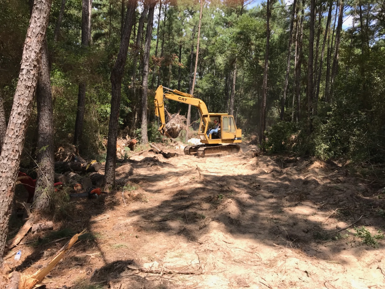

Happy digging! Here's mine using the hyd. thumb I added. 8-19-18 CAT Moving Stump For Kimberly's Driveway.jpg
hugs, Brandi
I did not know you added an excavator to the stable, Brandi. What did you get? Looks like at least 4-5T.
I have a few days experience years ago in a rental Takeuchi mini-X. I recall that it was 4 or 5 tons. It was great, and I got pretty good with it. I loved the hydraulic thumb. Excavators are much more efficient at digging versus backhoes. Everyone should try them.

I bought it back in October 2015. In 2016 I had the bucket link and bushings repaired and last year I added the hydraulic thumb with a diverter valve just like the one I installed on the Mahindra's loader.
Back in June I had to rewire the poor girl as she smoked wires from the instrument pedestal all the way back to the battery & relay. Check that out here........ https://www.tractorbynet.com/forums/projects/398806-project-i-had-not-planned.html?highlight=
She is a CAT E70 rebadged from a Mitsubishi MS070, back when CAT bought them out. She weighs in at 15,400 without the thumb, so she's a 7 tonner. Wobble sticks instead of joysticks, which made it very easy to rewire.
