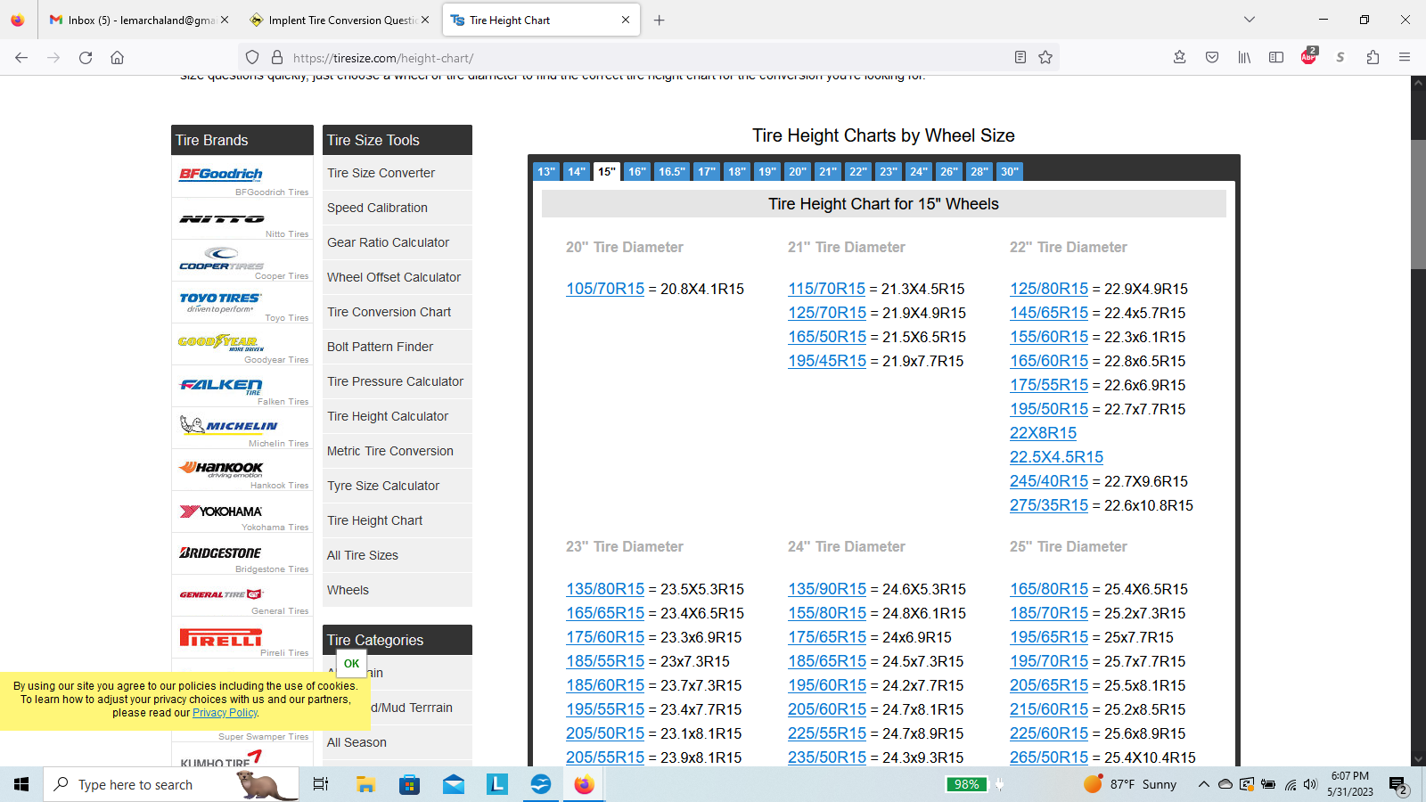

Hello I am trying to figure out what size tire I can Replace a set of 5.00 x 15 implement tires on my hay rake with. I was hoping to find or use some of the used tires i have around the farm i just do not know exactly what will cross onto the rims. I have tried online conversion charts but none of them list tires this size they only go down to about 7.00. Somebody had done this I am sure and can lead me to the right size. Thank You
PS if it helps the tires are going on a new idea 4150 rake 4 bolt rims

I have done the same thing. I just got a couple last week too. Found two four hole 15" rims with tires, doing a clean up for a neighbor. 165 15 to 205 15, maybe even 215 15 should work. We have a few double V rakes. I mount all the tires we use at my shop, on my vehicles, tractors, trailers. If a tire is kinda shoddy looking, you can also get radial tubes at the parts store. Have to be for radials. Now, your old tires are bias ply and they can take a regular old tube. I've run some ragly ole may pops on hay rakes, long as they hold air. Never had a flat while using.

Thank You thats what i needed to know Ive already got some 205 15's laying around used. The ones on the rake are equipment tires and are bad cracked and most likely the original tires, I already tubed them about 5 years ago and was really looking at this option Like you I mount my trailer and farm tires myself at home. Thank You..

A 155/60r15 might fit.
The page below has a listing of tires by height, unfortunately many of the sizes listed have no tires in those sizes.
   / Implent Tire Conversion Question? #8
This chart shows 5.00x15 size. Maybe work from that to find a close match.
