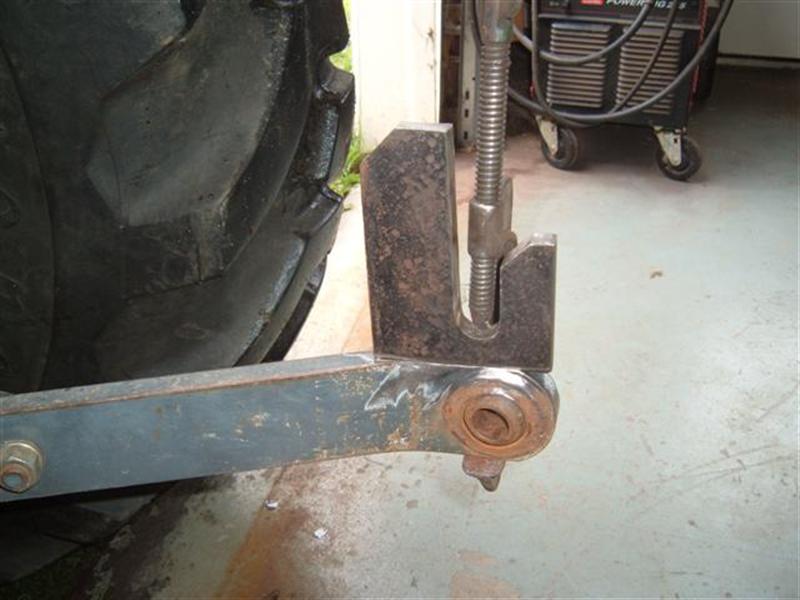

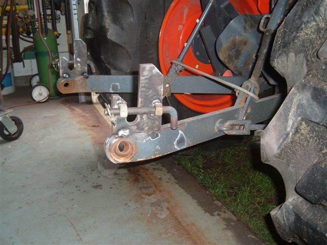

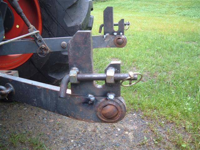

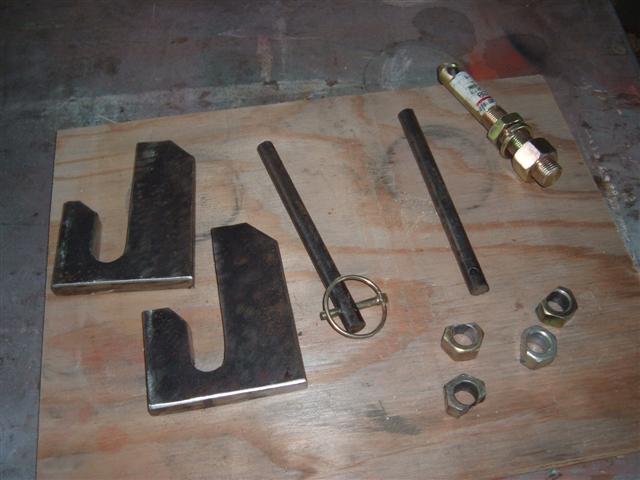

I am fabricating a qwick hitch system for my kubota 4200. This is what I have done so far. Decided to tac weld it on for now until I see how its going to work out.
Bob

Nice job Bob. Looks like it will work great.
Bear in mind you've changed your TPH geometry and some of your implements may need to be adjusted differently now.
When I changed the pin mounts on my rear blade to intentionally get a higher lift I failed to see that a cross member bound up the top link. The bind bent the top link but I was able to straighten it and chase the threads with a small file. Just a caution to check all your implements full motion with the new hitch and look for unintended pinch points.

Thanks RedDirt,
Your points are well taken. As I mull this project over, I have decided the hitch probably wont save me alot of time switching implements. I will still need to get off / on the tractor ( a few times ) to set width of lower links, install lower link securing pins, connect the top link, connect PTO, etc. I have always used my crowbar to positon an impliment for 3pth hookup and I can do the whole process quite fast and be on my way, and I only have to get off the tractor Once ! I'm thinking too that I will have lower link binding problems with this qwick hitch. Think I'm gonna scrap the project :eek:

Thanks for the posting . I was considering making the same, I wondered if the horizontal pin could go on the side like that. Keep us up to date lol
Al
   / implement qwick hitch
Thanks for your comments Al. The horizontal holding pins should work fine as I have them in my pictures. I decided to abandon the project for the reasons I stated.

Thanks ! I had Not seen this thread...
I made the "J's " by drilling a 7/8 inch hole in 1/2 inch stock then using my angle grinder with cutoff wheel I finished it ... not that hard to do ;) Using 1 " stock would have worked much better but all I had was 1/2" so my retaining pins had to go on the outside.
