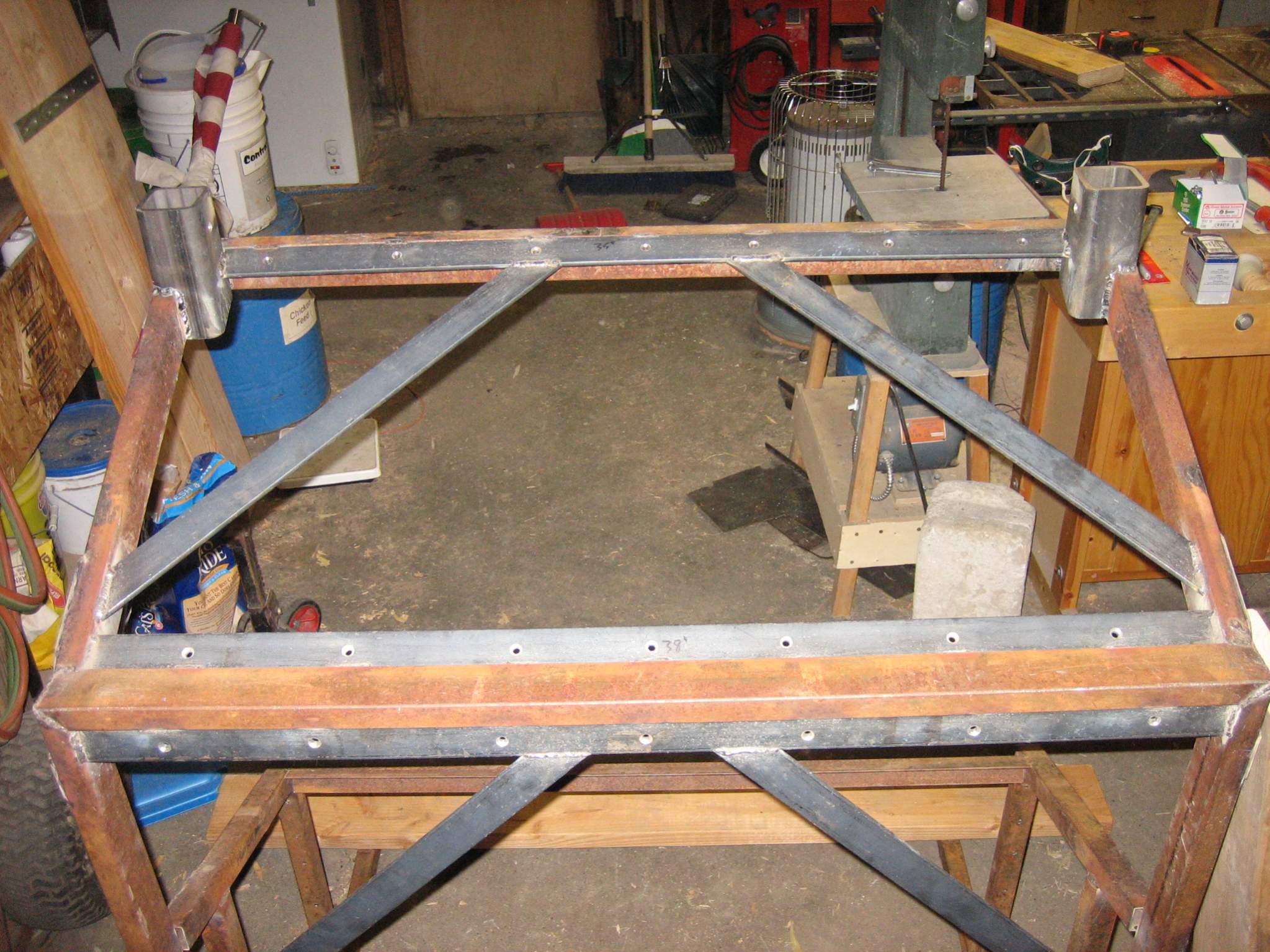

More progress. The sockets to attach the shafts are welded on now. I also welded on some fishplating on some of the higher stress seams. Sorry. No picture of the plating. My camera gave the low battery alarm after I took the picture of the shaft sockets.
The plan with the socket system for the shafts is that I can use either a set of shafts for a single horse or a tongue and double tree for a team.

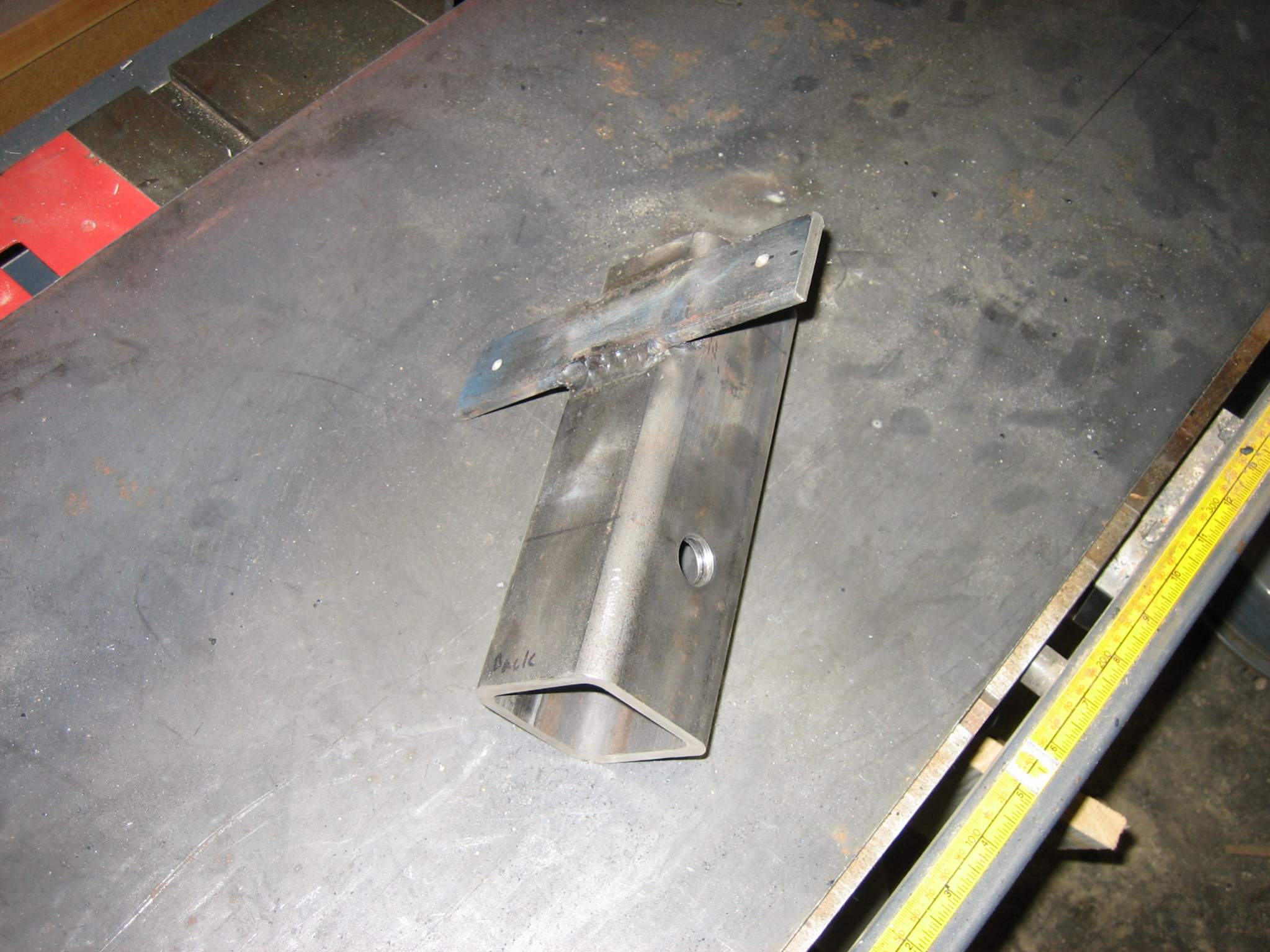

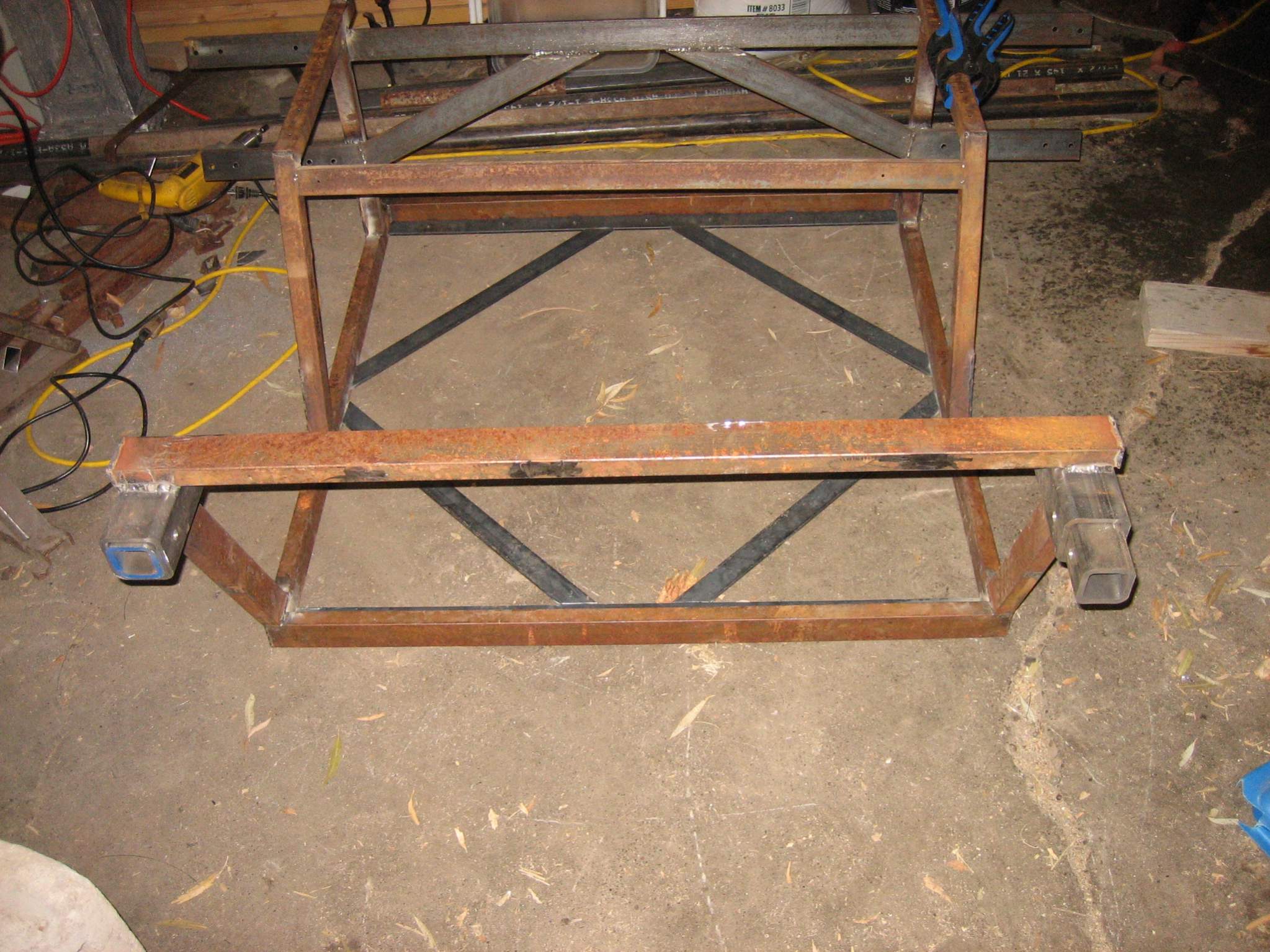

I've been working on this cart today some more. I've been mostly adding more reinforcing plates. I also started adding a rail. My intention is be able to put stuff under the seat to carry. My hope is that the rail will keep it from falling out along the way.
I stopped for lunch, so I thought I'd post a few pictures...
Picture 1: Fish plate for the dash board
Picture 2: Left side rail and fish plates

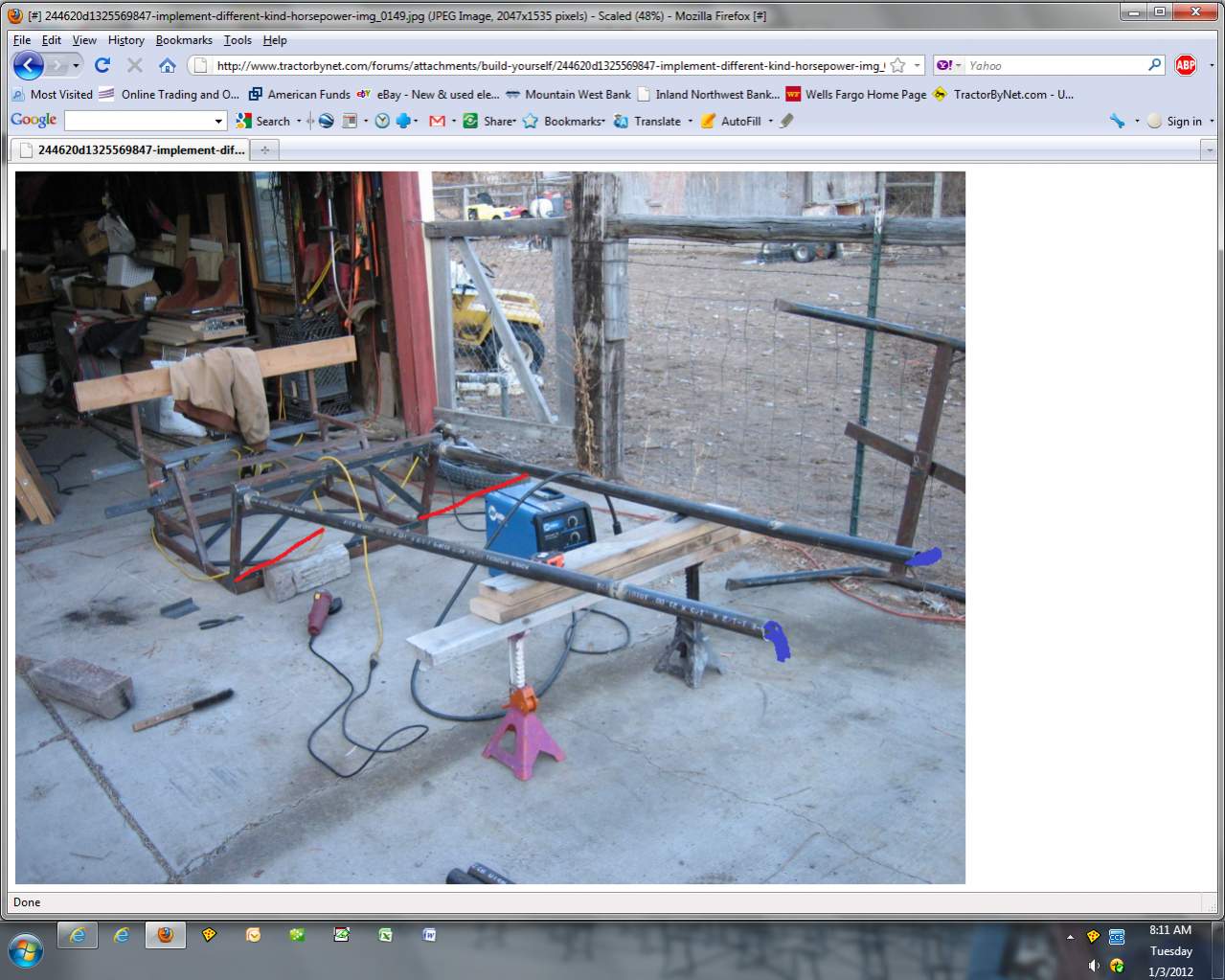

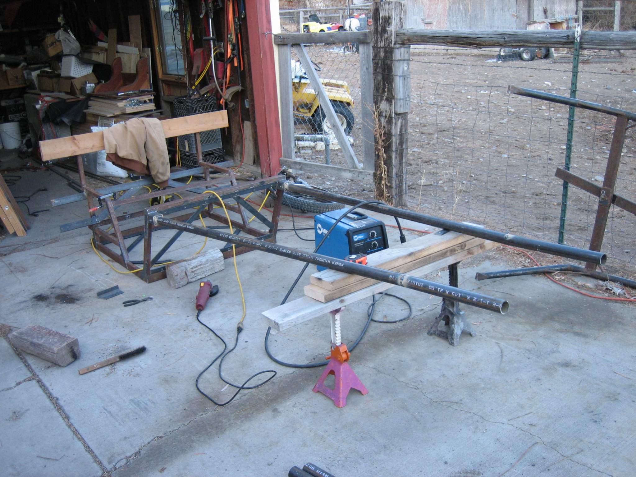

A few more progress pics from today's work.
The first picture is the setup so I could get the shafts right. They angle in and up.
The second picture is what I got done on the cart tonight.

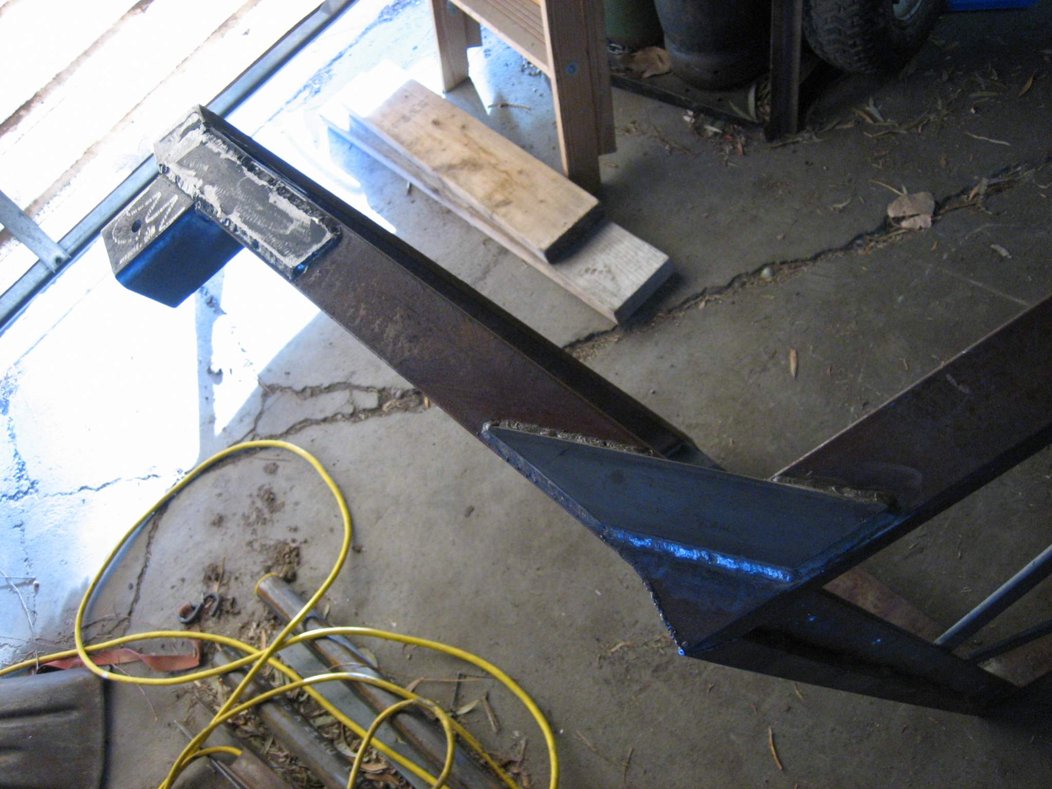

/ Implement for a Different Kind of Horsepower #28
looking real good so far. my only 2 suggestions from my own experiences
1. Turn out the ends of the shafts a bit and seal the holes smooth
2. as per pic add a stiffener on both shafts. I have broken the shafts at connection posts before.

/ Implement for a Different Kind of Horsepower #30
Thanks for the input. Sealing the ends of the shafts is definately in the plan.
As for the angle braces for the shafts, I'll have to think it through. The original plan is to make the shafts interchangeable. I don't know a good way to add the braces and still be able to easily switch the shafts for a tongue. The shafts are made of 1 1/2" Schedule 40 pipe welded to a 1/4" wall 2" square tube. That seems pretty hefty to me.
the one i had also had removable shafts. the angle bracket was welded to the shaft but the end that attached to the cart was connected with a removable nut just like the shafts were.
the one cart we had that didnt have the support snapped at the connection. luckily it didnt fully break while driving. i found the stress cracks before a major accident happened.

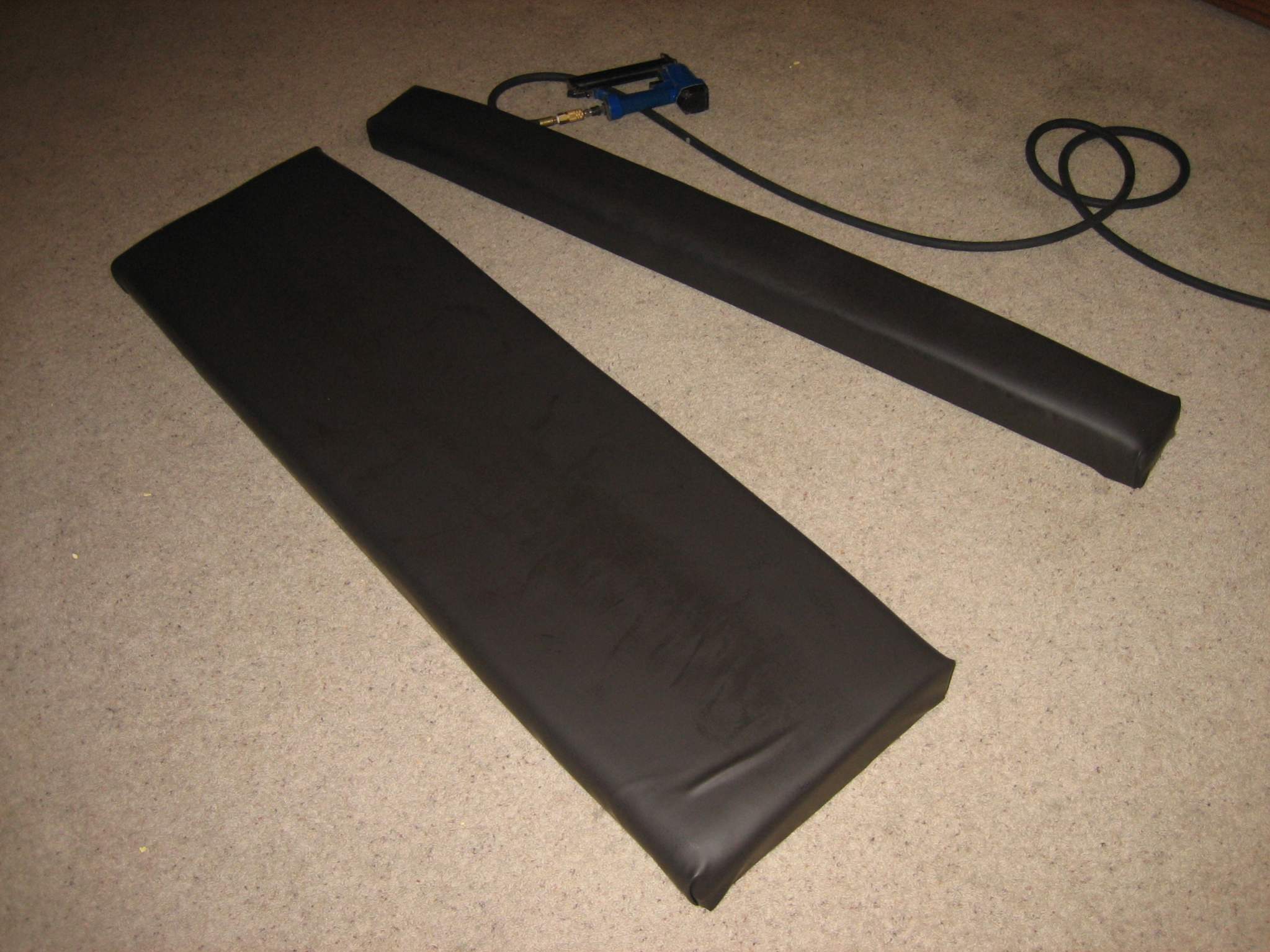

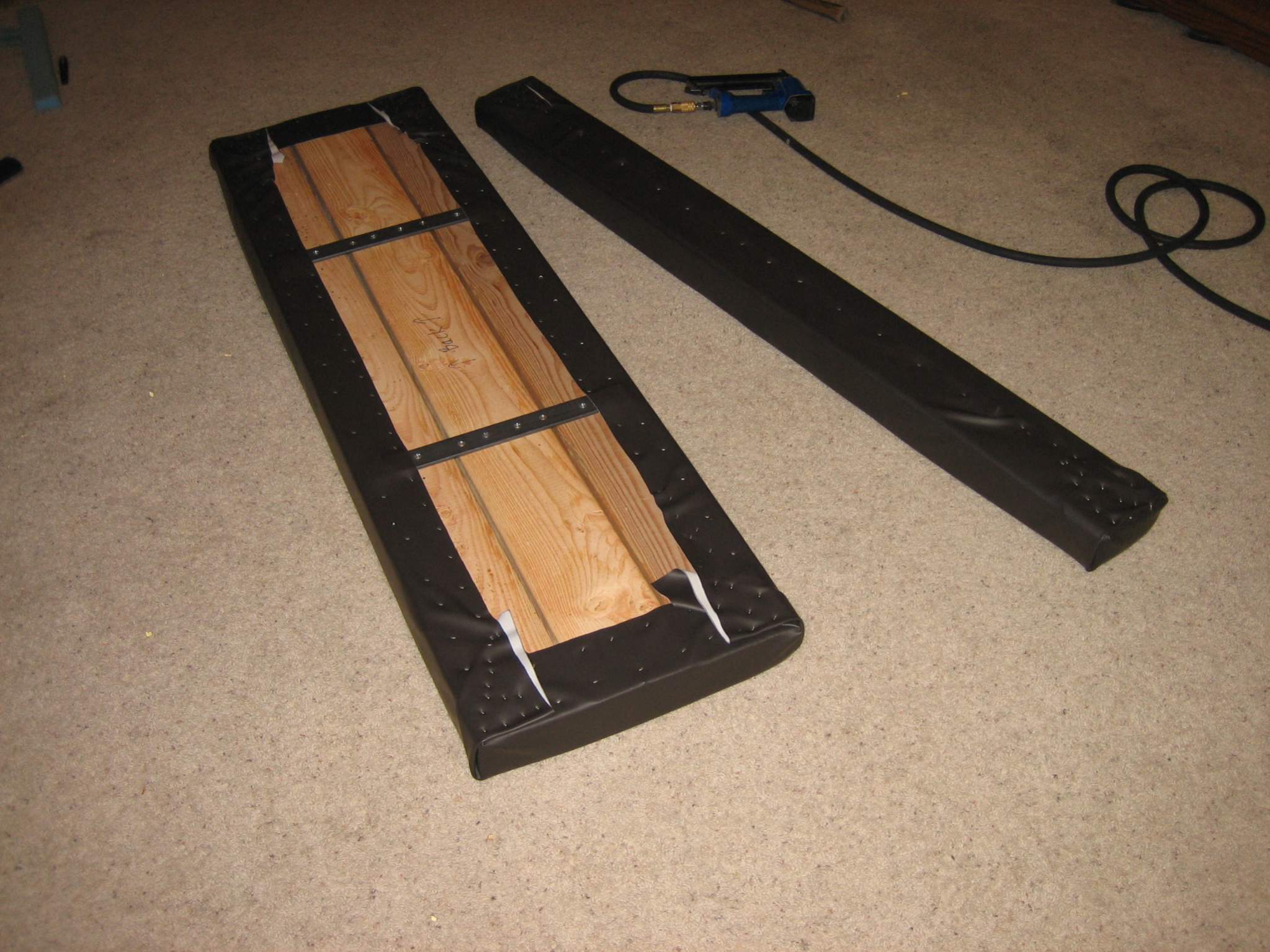

#31
I learned today that my upholstering skills are about the same as my welding skills. I'm good enough to make something that will work, but I'm no professional.
Here are pictures of today's progress. The first picture is the front side of the seat and seat back. The second picture is of the bacK of the seat back and the bottom of the seat. My wife helped me with this part of the project. I'd have been lost without her. It took all four hands to hold everything in the right places and staple it. Not to mention she has a lot of experience sewing and stuff, so her knack for folding and stretching was very valuable.
We did find a youtube tutorial that showed us how to fold the corners. The corners are by far the hardest part. [ame=http://www.youtube.com/watch?v=1pa6S6zaiig]How To Fold Canvas Corners - YouTube[/ame]

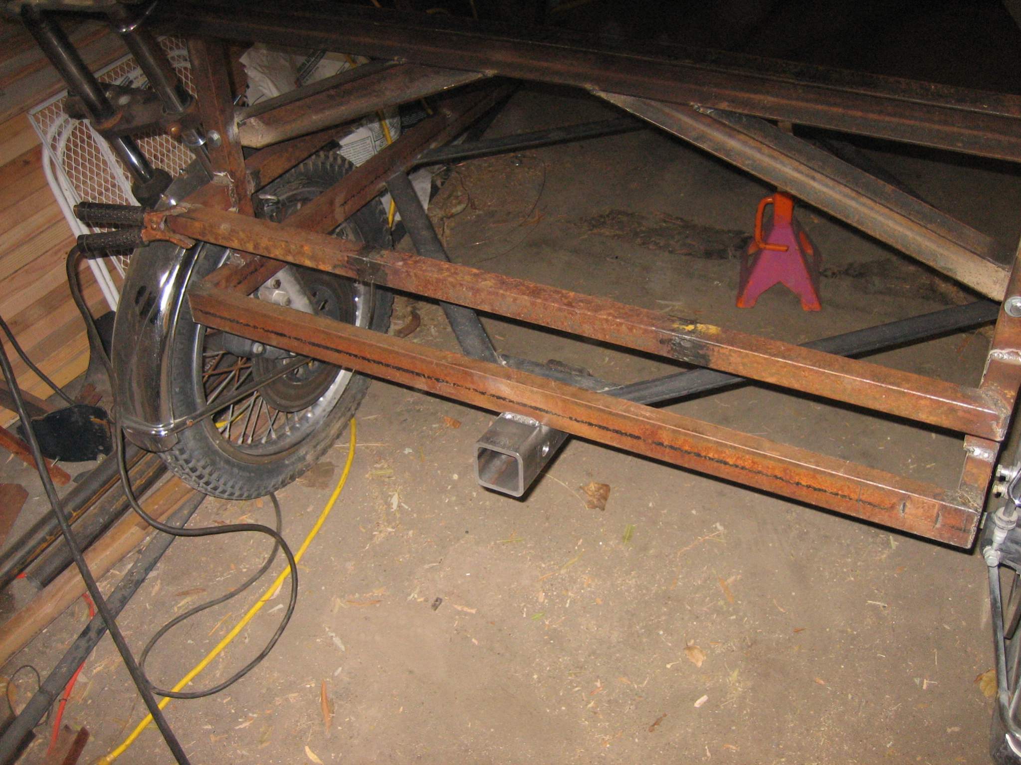

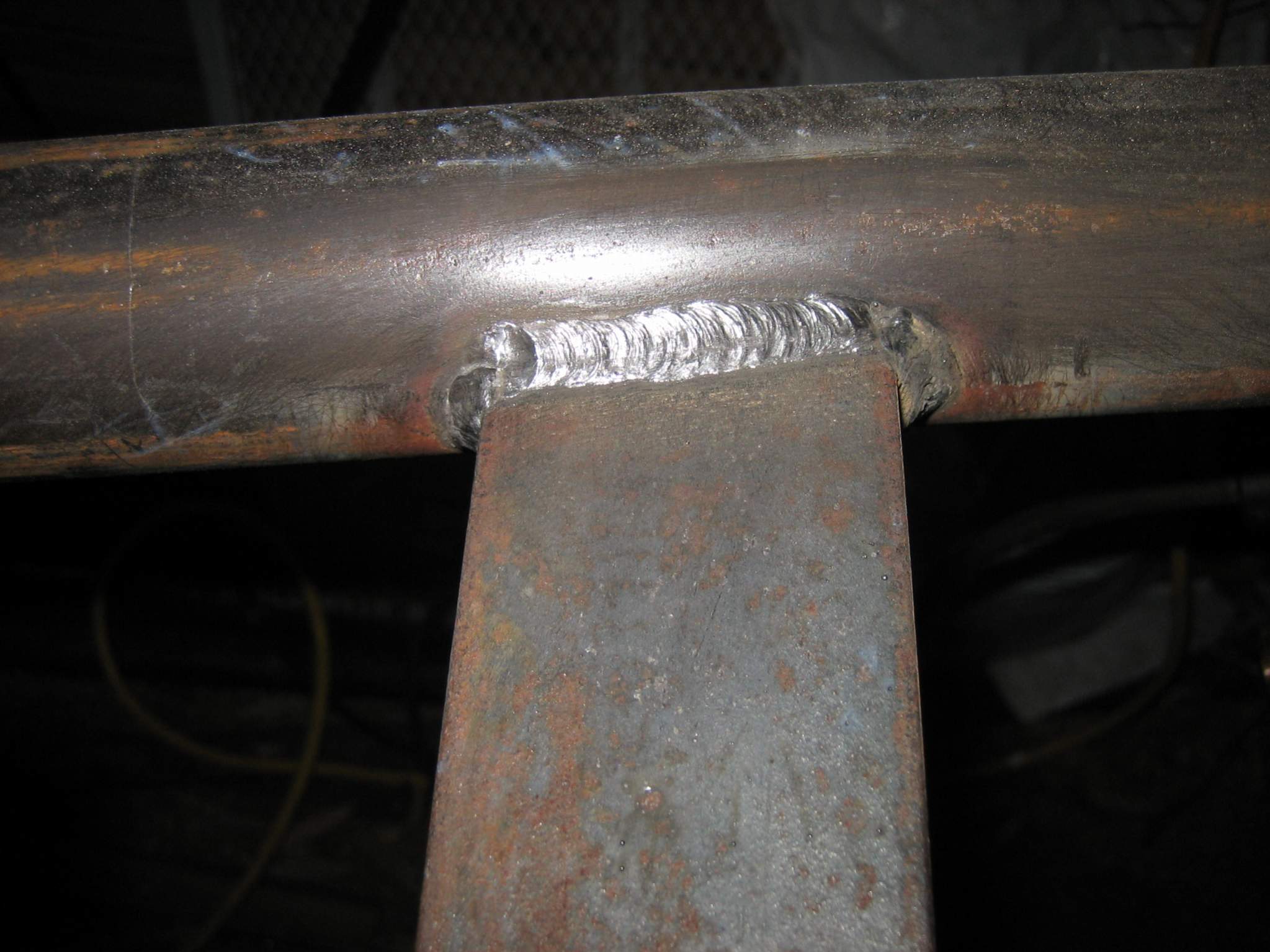

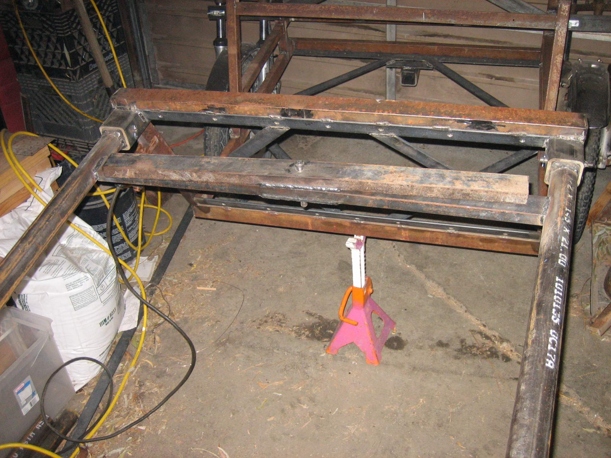

#33

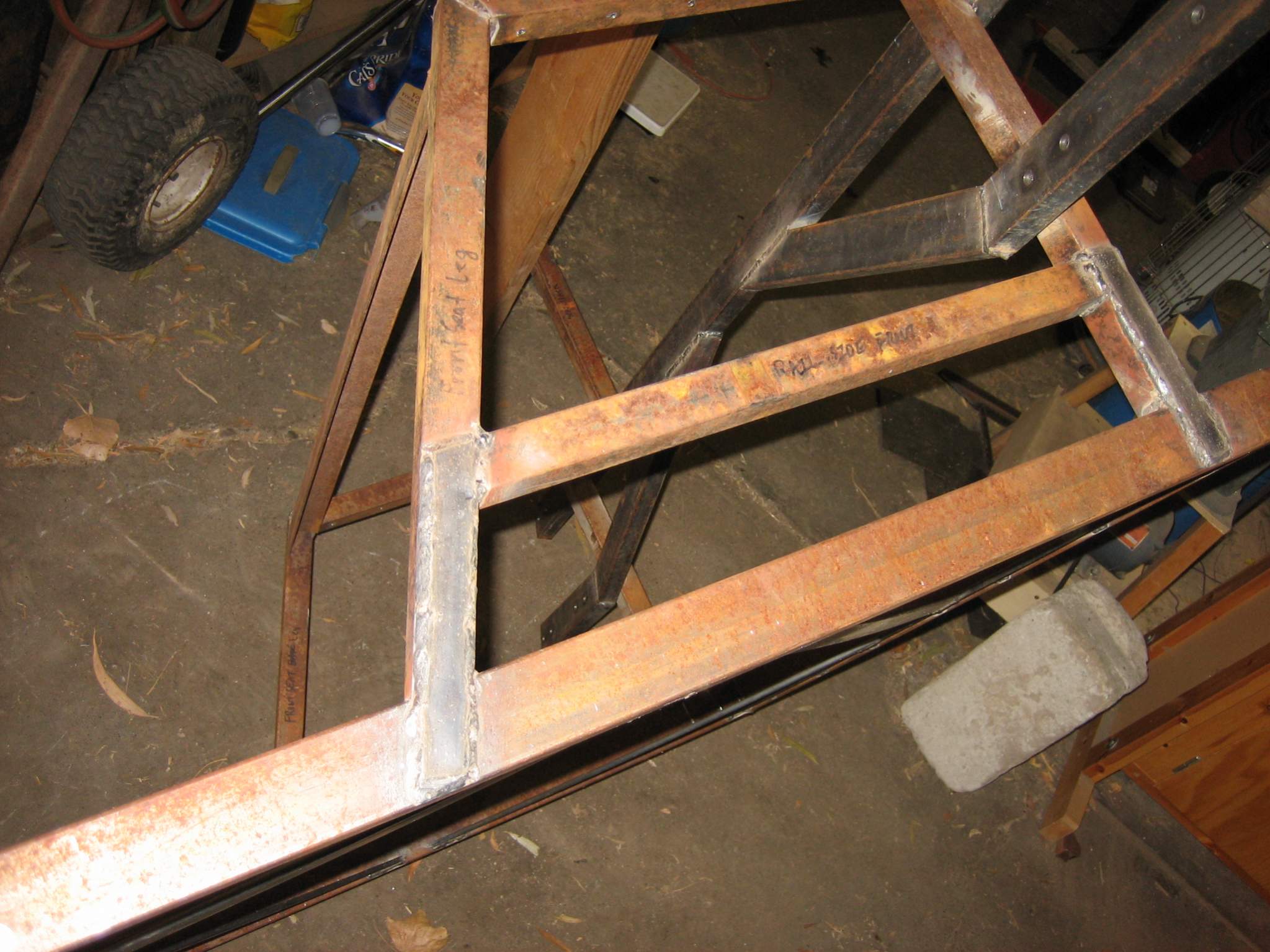

I remembered to take the camera out to the shop last night. Here are a few pictures. Progress is slow. It's partly because I only get an hour or so at a time to work on the cart lately. I decided to go ahead with the receiver hitch. I figure I can't use it if I don't have it, but I don't have to use it if it's there. The first picture is the receiver assembly ready to install.
Picture two is the receiver attached to the bottom rear of the cart.
Picture three is the pin stub that I'm going to use for the added braces between the shafts and the cart frame. I have another pin stub welded to the shafts, but I didn't get a picture of it.
Picture four is the single tree assembly attached to the shafts. I still need to weld some hooks to the single tree, but it's removeable so that will be easy to do later.
The fifth picture is my one weld I'm proud of. I had to include a picture of it here because I'll likely never get a weld that good again. It was done with 0.35" flux core wire on a Millermatic 135 at 130 amps on approximately 3/16" steel. In contrast you can magnify the picture of the pin stub and see the gloppy weld I did there. I'm not very good at round welds. Give me something flat, level and straight.

/ Implement for a Different Kind of Horsepower #34
Whats the receiver hitch for????
#35
I don't even know yet.
I figured it would be a nice place to hook a harrow. I can also see myself making little attachments for this cart... Maybe a little Mother-in-Law seat that trails out back.
/ Implement for a Different Kind of Horsepower #36
The reason i ask, is if its for an attachment, it HAS to be directly over the rear axle.
I have a forecart , and when we made it we placed the receiver behind the axle, and when we attached anything to it, it lifted the pole (or shafts) and tried to lift the horses off the ground.
#37
I figured that would be the case. The applications I have in mind now would be low or no tongue weight (i.e. harrows). I guess that anything I build for it in the future would have to take tongue weight into consideration.
Thanks for your input.
/ Implement for a Different Kind of Horsepower #38
ya, a harrow shouldn't make any difference.
