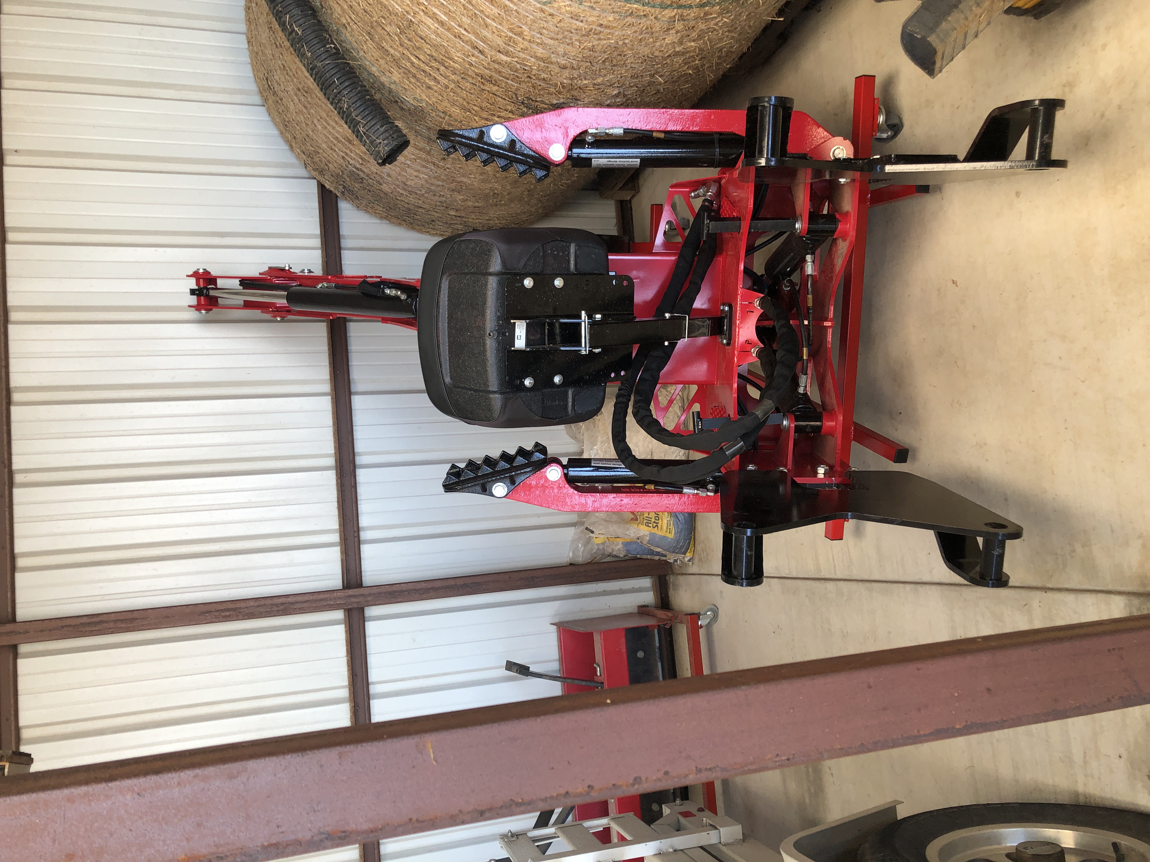

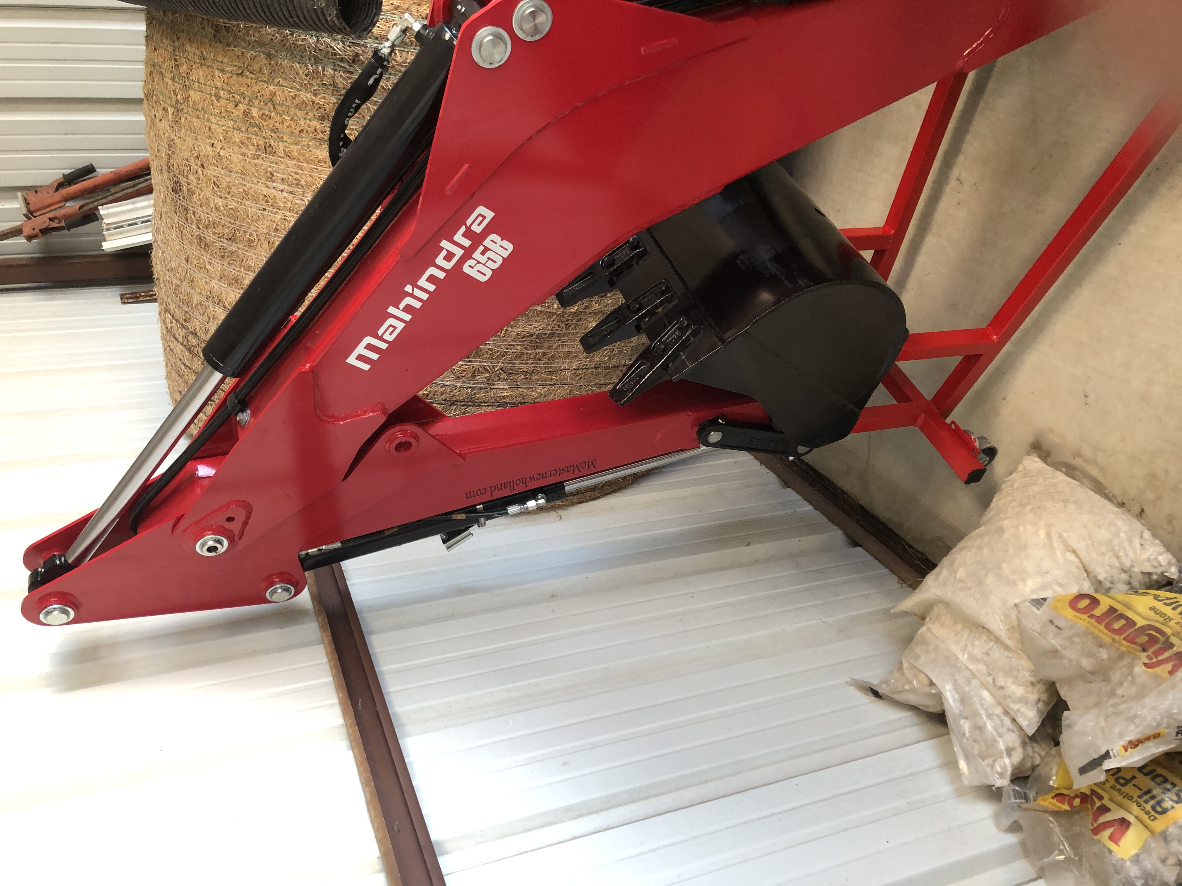

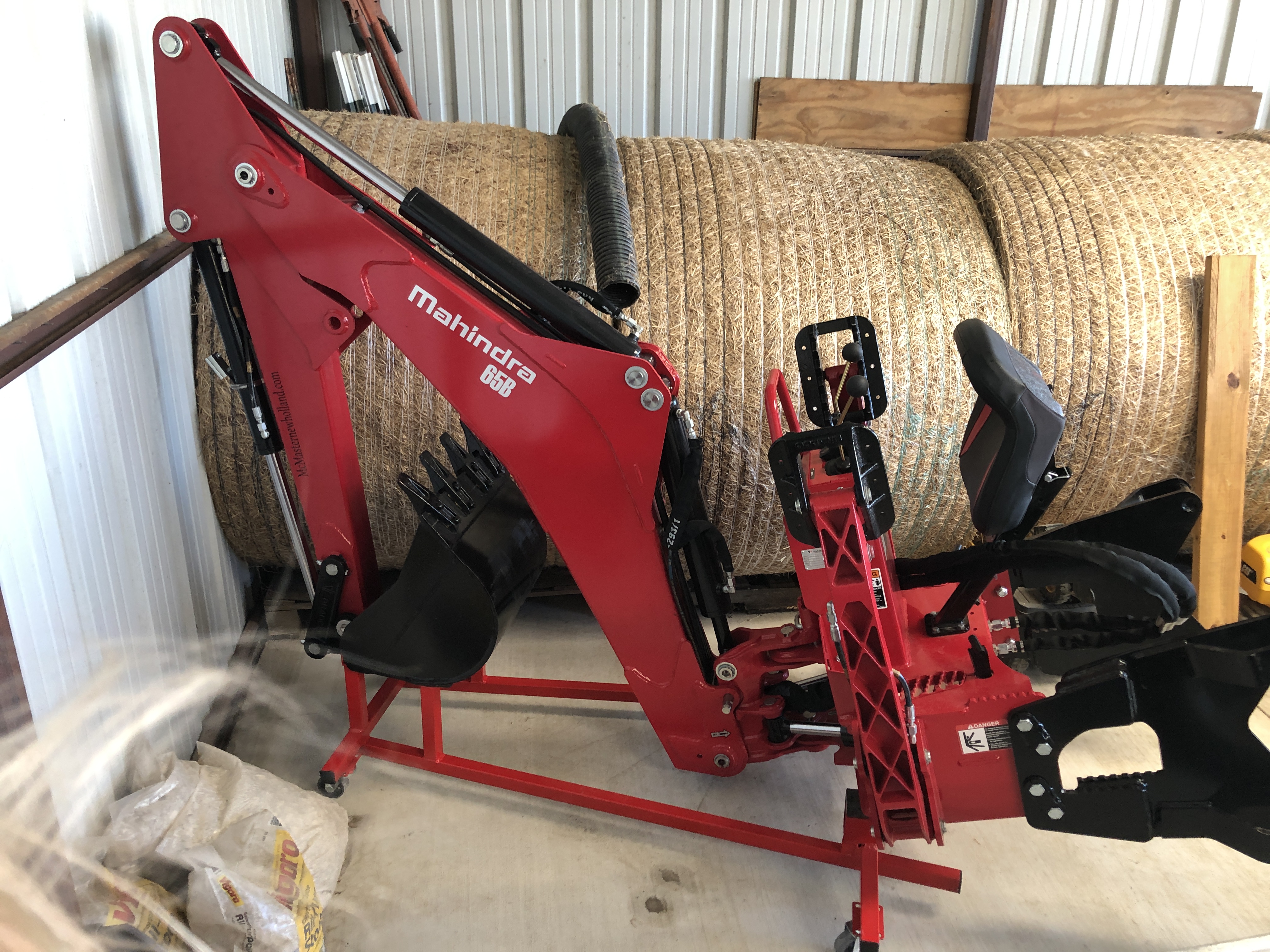

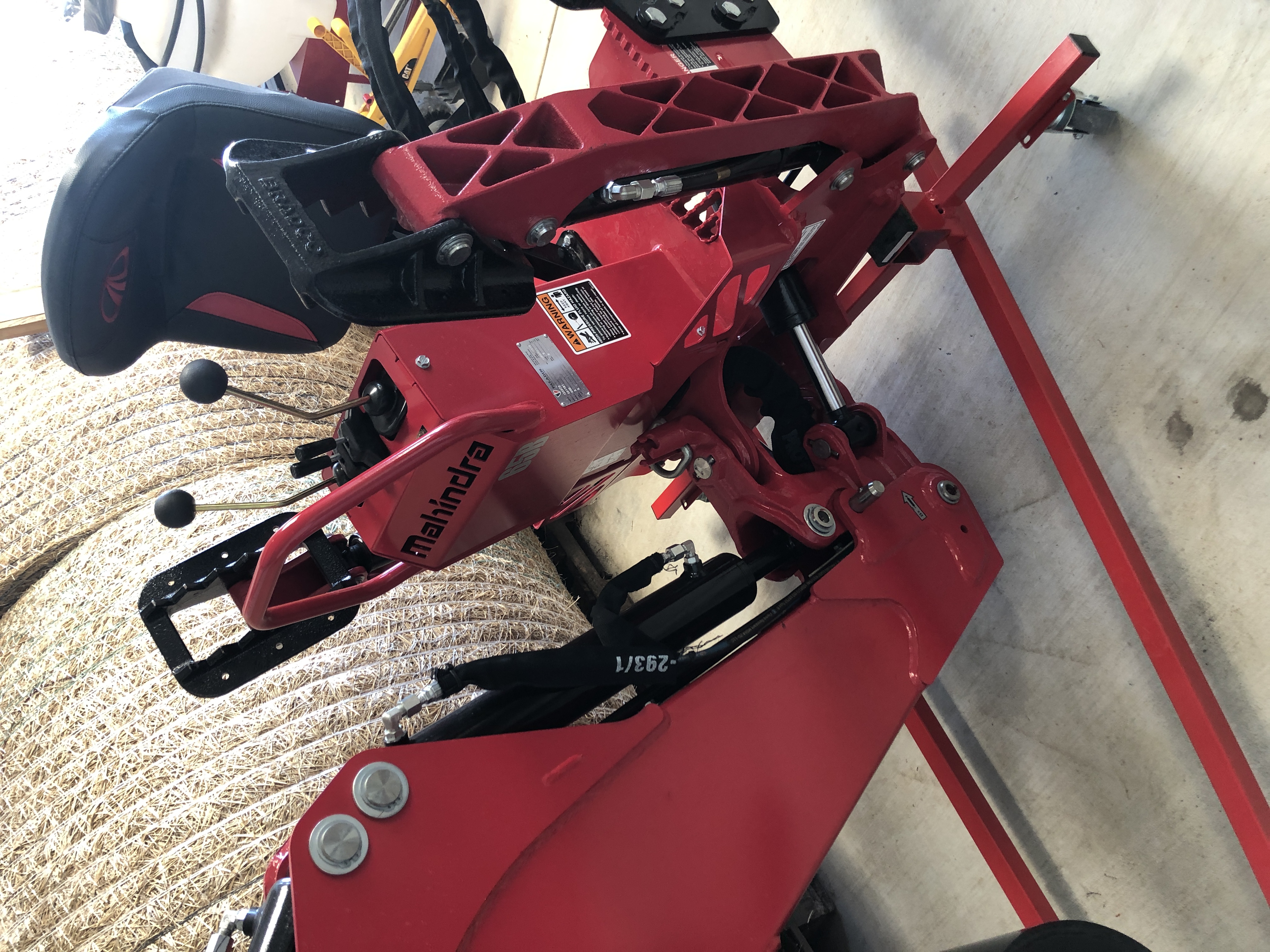

New Tractor & Backhoe means a NEW DOLLY! Based on my original design posed back on page 3, and some mild changes... No bucket pins I could "grab" with some basic angle iron, so a more complex "landing pad" had to be designed. New backhoe is 1100lbs.
Roll it right up to the tractor, not top-heavy at all.. rolls well...
Front view
where a bulk of the weight sits.
Fun stuff!
