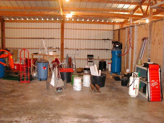

And Robert, putting anchors to fasten a compressor down on concrete is OK, if you use some type of vibration absorbing mount. Personally, I'd never do that. I had a 60 gallon upright, 6 hp, V-twin, oiled compressor in my shop, and I left it on the pallet it came on (as recommended by the dealer). It never moved at all in the years I had it, but when I sold it, all I had to do was disconnect the power and air hose to take it to the buyer's pickup.

I left my big one on the pallet also. I don't think it hurts anything at all. It's hardpiped up to the attic and across the shop to all the work stations where I use it. I have some pretty serious filtration both at the air compressor and at a long hose reel too because of the blast cabinet and I do quite a bit of painting, both with an airbrush and a big car sprayer. I mostly use high dollar automotive paints that don't tolerate even the slightest amount of moister in them so the filters and separators are a must.

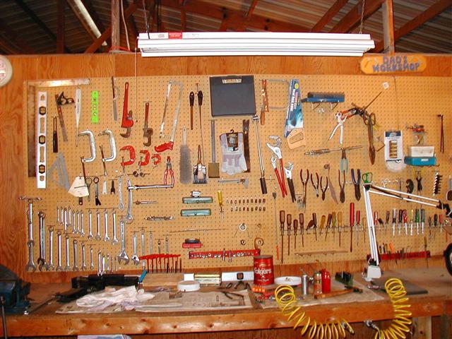

Here's a picture of the workbench where I used to work on air tools. The compressor is right behind that wall with tools hanging on pegboard, so I've included a couple of shots on the other side of the wall. My shop was just 40 x 60. And nope, I would not plumb my air lines with PVC again, but at least I never had a problem with mine.:D
