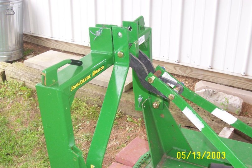

I originally bought a JD 790 with JD 413 brush mower in 1999.
In 2003, I traded the 790 for a 4310 with an iMatch.
I had the same problem with the 413 as shown on your picture. It turned out that the 413 was sold with two different
kinds of linkages. One was compatible with iMatch and the
other one was what I had. I did some searching on the
JD parts web site and for slightly less than $100, I bought
the linkage parts to convert my 413 to iMatch compatibility.
Here's a picture before I painted everything.
Unfortunately, I looked on the parts web site and the 272 doesn't have two different linkages. But you might be able to
use the S linkage bars from the 413 and build or adapt
the other linkage bars.
