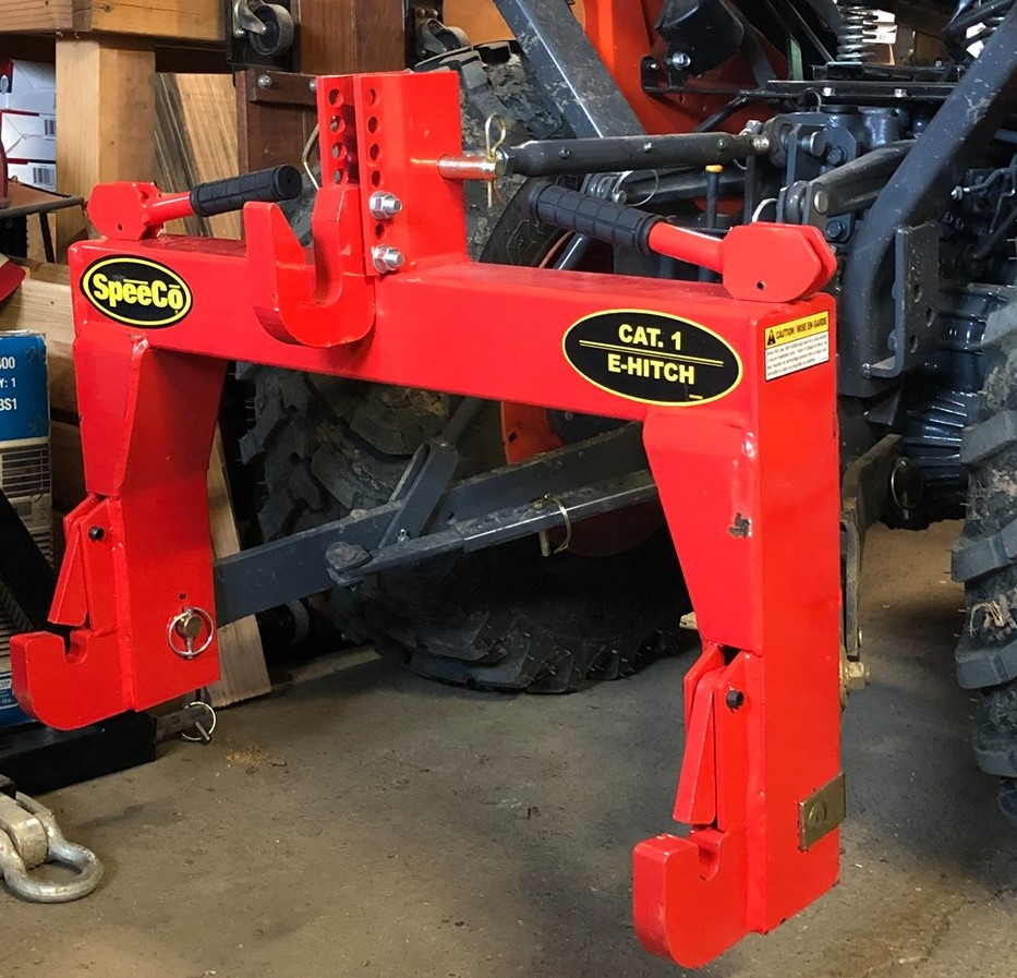

These are very simple devices and I think all the cheap quick hitches work OK. I've been using a Harbor Freight QH for over 10 years and it's great. The only issues I've seen are that the hook forging isn't as precise and, in extreme cases, may benefit from a little grinding and the bolts on the adjustable hook my interfere with some implements, requiring an extended hook or link. (This last issue could happen with an imatch also.)

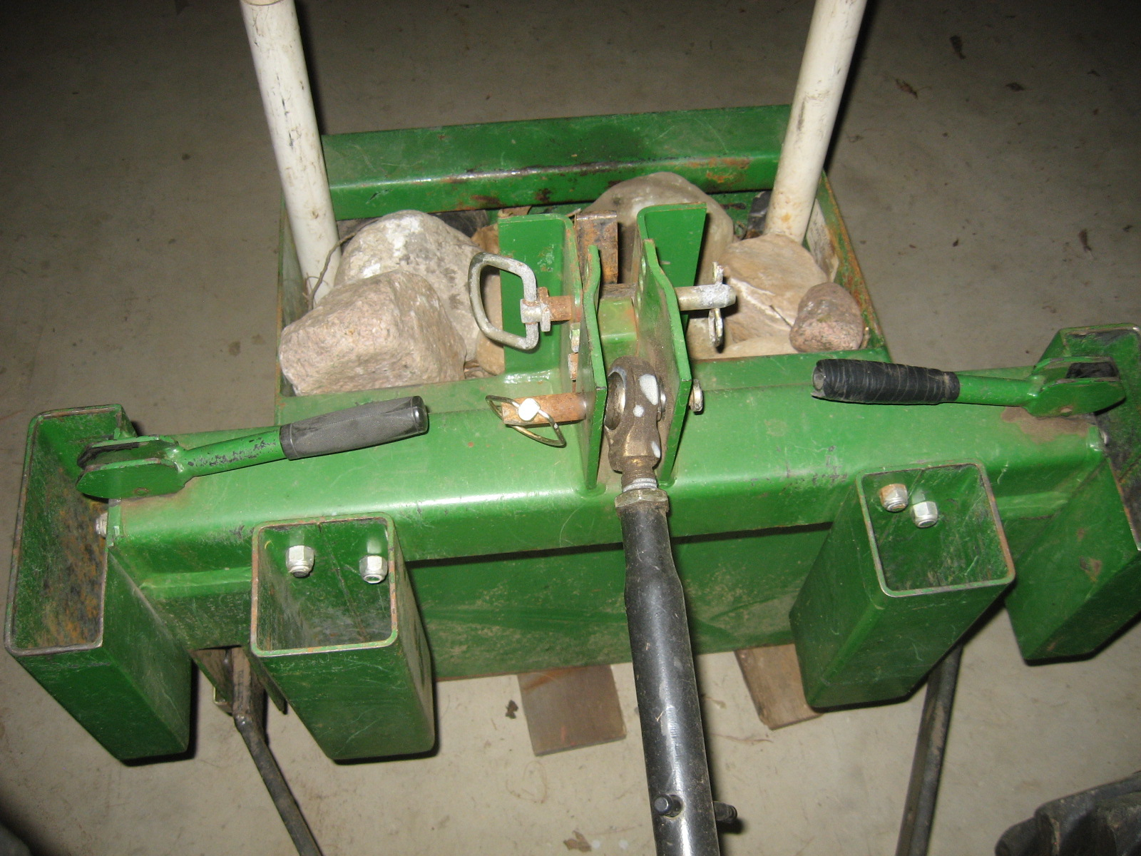

Almost 20 years with a Speedco. Painted JD Green and chain boxes added. Has held up just fine, no issues. An occasional shot of lube in the linkages and some black tape round the plastic grips.

like your chain boxes. do they get in the way of the PTO shaft. I find it is already tight enough getting in there to hook up a shaft without chain boxes but I could really use chain storage.
   / imatch knock-offs? (JD2305 & RC2048) #9
Yea, was thinking about that when I mounted the boxes, so each box is attached via a pair of threaded studs welded to the QC so they could be removed. I find the QH itself is what gets in the way; the two smaller chain boxes are pretty irrelevant.
I wind up laying on my back to connect the PTO shaft. Between the QH, the tractors metal PTO guard, and the rotary cutters plastic PTO housing/guard, sliding underneath is the quickest, most reliable way to ensure the shaft disconnect is indeed fully seated.
My rear PTO is only used a few times each season, so the on-the-back routines is merely annoying. But I do change between ballast box, box blade and straight blade frequently, so QH has been a friend. Often skid trees, so chains boxes have earned their place….

Nice work, I assumed they were welded so I though I would ask because like you I find the quick hitch is already in the way when hooking up a shaft
