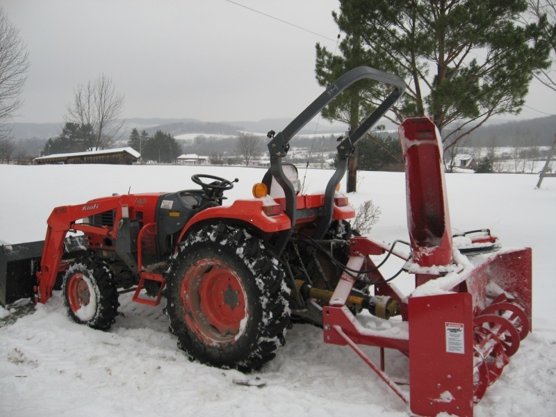

   / I'm thinking snow removal #9
Here is a picture of my setup.
