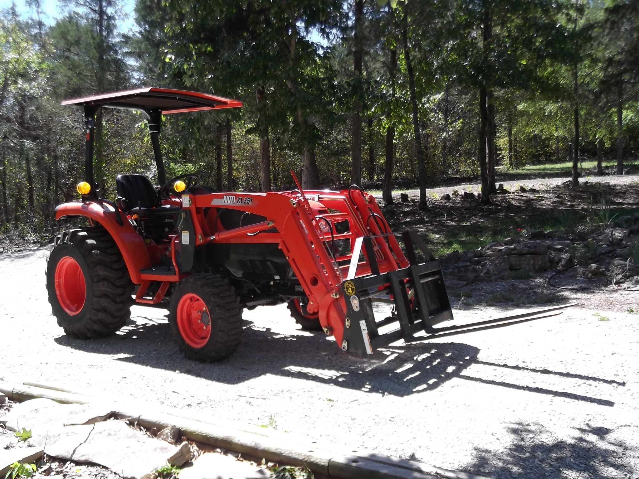

By the way SSQA is Skid Steer Quick Attach, it is a universal brand agnostic attachment system for the front end of your Front End Loader (FEL). You really want to get it if possible as it allows you to change implements on your loader in just seconds. For example if you have the normal bucket on the FEL, and you want to now put on your pallet forks you just throw a lever or two and hook up the pallet forks and off you go. Or change that out for your Grapple. Of course with the grapple you will have to have the hydraulic hoses brought to the front and have a hydraulic circuit to hook up to to actuate the lid of the grapple. Grapples are extremely useful for moving brush, logs, and rocks. SSQA makes all of this possible, without it, you are pretty much stuck with having a bucket on your FEL, and that is it, or maybe some clamp on pallet forks you clamp on to the bucket..

Wow. Now that was great looking. I think I have misjudged how much work one of the smaller tractors will do. That looks like more than enough for anything I would ever move and it sounds like no matter how big the tractor is, it isn't for pond work or bulldozer stuff. Man I love this site. I have been on here more in three days than I was on the internet in the last three weeks.
I will definitely try to come see your tractor in person. Thanks for the pics. I see and understand better than I read and understand.
