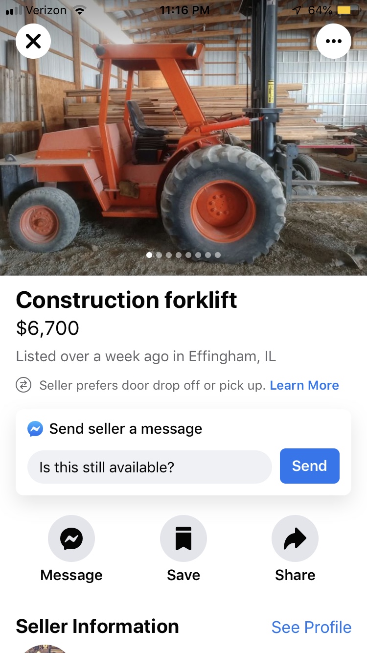

Hey guys. I've been wanting to buy a tractor and put a fork attachment on the front of it. I went to the kubota dealer and the sales guy basically all his tractors he had on the lot would only lift 1000 pounds max. I think his were all the 2000 series tractors. So what size tractor do I need to be able to lift 2500 pounds with a fork lift attachment? I'm not looking for a brand new tractor since they have the tier 4 emissions junk on them, but I am a fan of kubota. Maybe even an old ford tractor, it could be 20-25 years old for all I care just as long as it's in good shape.

You’d be way better off with a real off road forklift. It would take a pretty good size tractor to handle 2500 pounds. Like the biggest of the L series might but that’s MX territory.
   / I'm looking to buy a tractor to use primarily as an offroad forklift.
Offroad forklifts are expensive even used.
   / I'm looking to buy a tractor to use primarily as an offroad forklift. #4
The telhandlers are but the ones like this are pretty affordable. IMG_9285.JPG
   / I'm looking to buy a tractor to use primarily as an offroad forklift. #5
I just used my Deere 5065 to move & stack baskets of firewood. I'd guess about 1500 pounds each. The biggest problem is sight lines. Can't see the fork tips and there is no side shifter, like a real forklift would have. The steering is slow compared to the rear steering of a forklift, so accurate stacking is difficult. Further, Unless you're on a dead level area, fork leveling (side to side) is a problem. A tractor is leveled by the rear tires, since the front tires/axel pivot at the center. A real RT forklift carriage is leveled by the large front tires. All in ... Get a real forklift, A tractor as forklift has too many compromises. :2cents:
