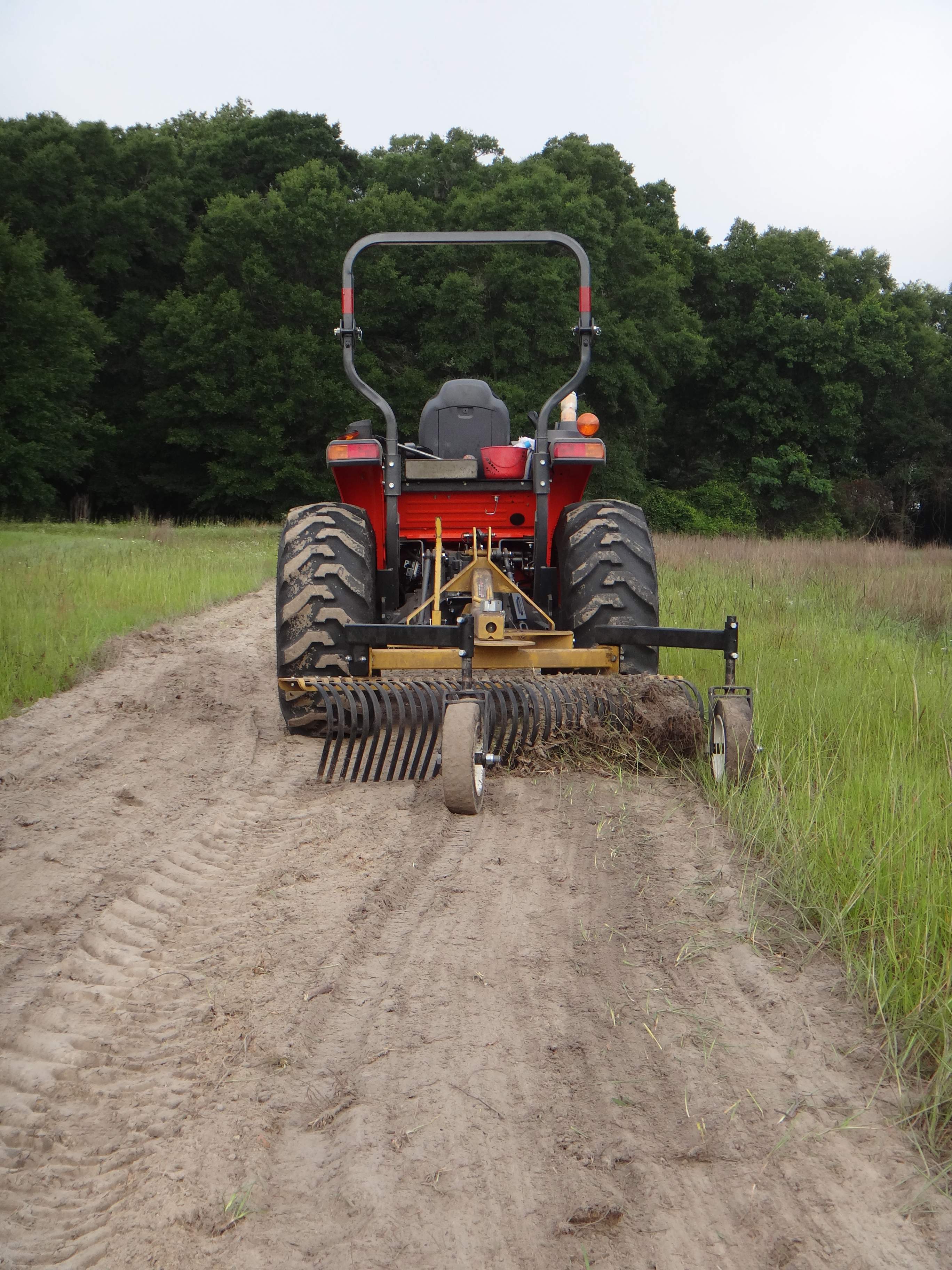

You want a Landscape Rake to cover your rear tire tracks WHEN USED ON AN ANGLE, moving dirt across the face of the rake to fill low spots. For a B7800 72" width is about right. It will extend about 6" wider than tire width on each side, WHEN PULLED STRAIGHT.
If you require a very smooth finish to your grading work you will want a pair of gauge wheels.
The two negative issues with light Landscape Rakes are 1) the tines bending, rather than springing back and 2) the tines swiveling under load, if attached at a single point.
I have an everthingattachments.com Landscape Rake and it is excellent.

I assumed he knew that covering his tracks meant the rake would be on an angle.
It looks like yours isn't covering your left track. That's why I'm looking for a 7' rake.
