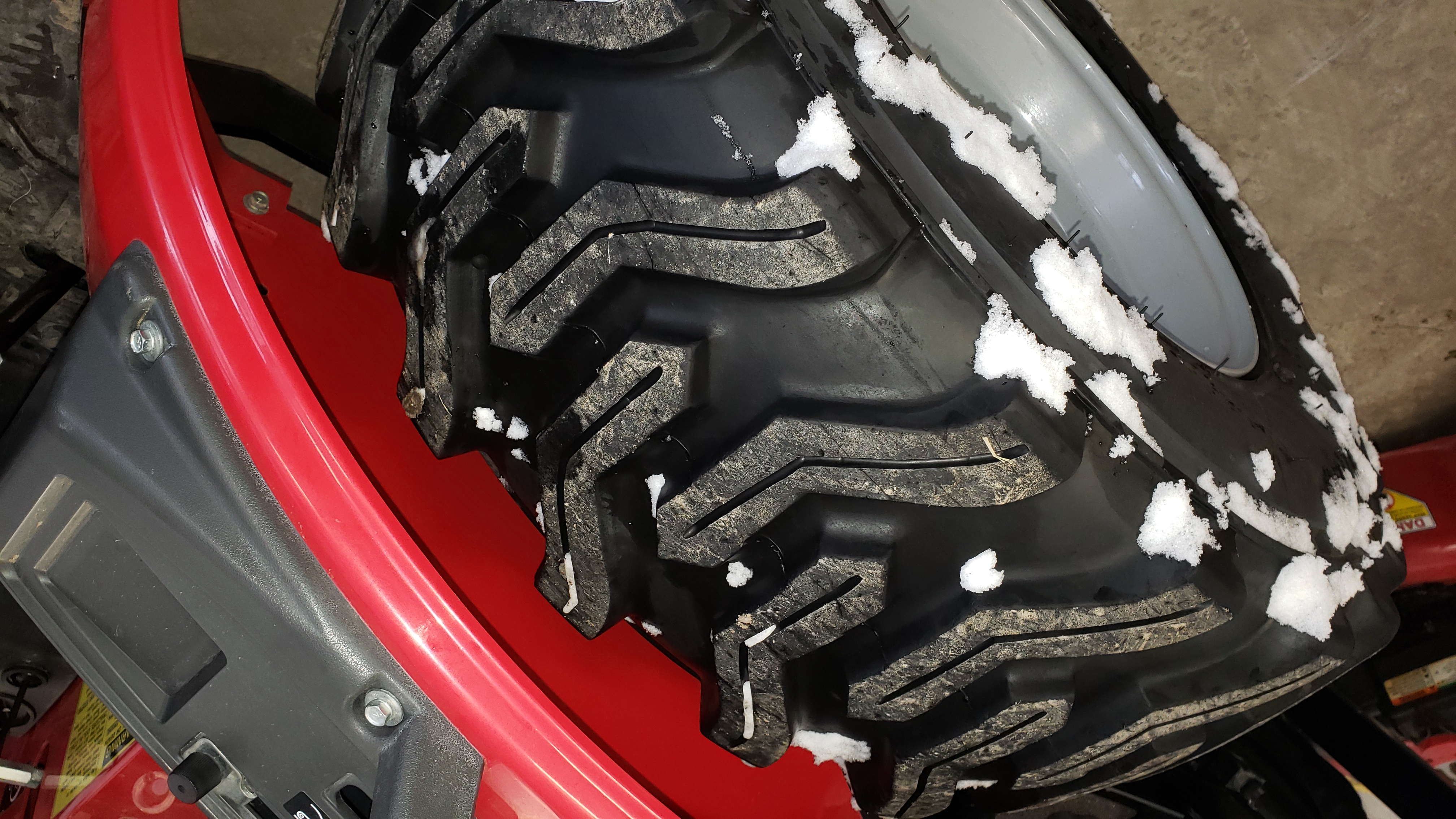

Simply gives the tire more biting surface into the snow, snow on snow causes friction, friction allows grip, i have effectively double the gripping force by adding this. at least thats the way it was explained to me. you definitely do notice a difference.
Any downside?
   / I'm a Believer... No Not the Song... R4 Tire Grooving #12
Any downside?
It weakens the tread abit and if you spun the tires really bad, it could tear a lug out. I dont see that happening on a tractor though
#13
you would literally have to spin it on shale, very fast. i ride coal dumps with atv's which have similar grove patterns, we literally have to roast the tires (not possible on tractors) to really damage a tire, and even then you would have to do it a lot longer then any normal amount of spinning.
   / I'm a Believer... No Not the Song... R4 Tire Grooving #14
I've seen that mentioned here before, how does it work? Not quite sure I understand how these shallow grooves work where the large lugged tires don't.
FWIW, I suspect it has something to do with a water film that may form under tire contact pressure- maybe like a mild form of why ice skates work so well. I DO know that my driveway's hill is a lot slicker as it warms up toward freezing. Figured the water film forms better then. So maybe the extra groove forms a reservoir or escape path for that water film that would otherwise have no place to go, especially on large contact areas like tractor tire lugs.

Grooving does make a remarkable difference, especially on R4 tires.
   / I'm a Believer... No Not the Song... R4 Tire Grooving #17
X10 on grooved tires improving traction. I did all four on my previous tractor R4's. I have the rears grooved on my current R4's, and the difference is certainly noticeable.
If I ever get around to doing the fronts, I think I'll just do a single groove down the center of the lug, as on the rear.

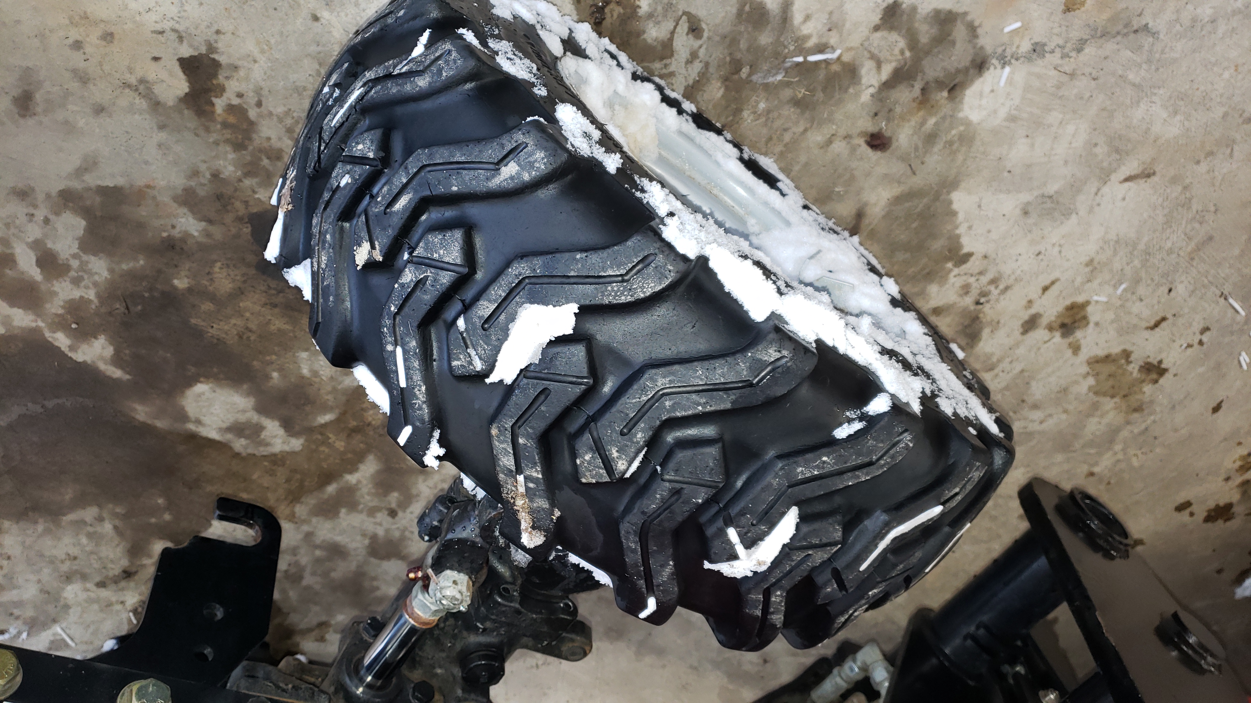

First go around since I grooved the tires, big big difference, I don't know if the snow was different, it was definitely heavier, but significantly less trouble this time, almost 0 spinning and hills i needed diff lock and had to spin my way up, i went in reverse (no diff lock at all). To those of you debating, i would definitely do tire grooving before going chains to see if its enough. I am not buying chains now. (90 vs 800)
View attachment 687436View attachment 687437
I knew you would like the grooved tires. They worked great in the snow I got here in Ohio.
