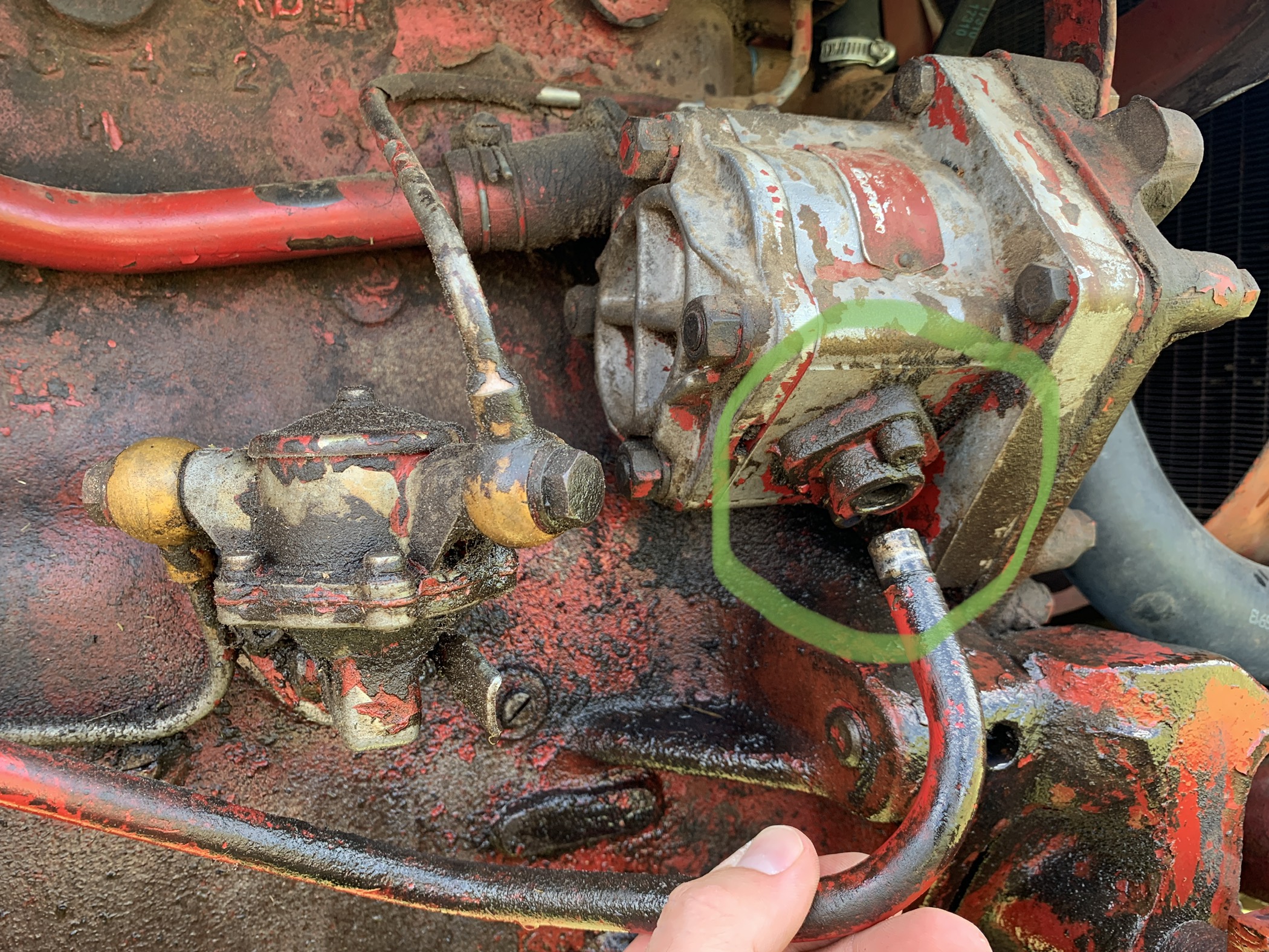

I was cutting hay yesterday and about halfway through I guess the metal hydraulic line coming from the pump blew off. I welded it back together in two spots to hold it from blowing off again.
Anyone know where I can get a replacement part for it or have a good fix?

I ended up taking the line off, cleaned it up real good, and then brazed it together using these rods:
Bernzomatic NS3 Nickel-Silver Flux Coated Brazing/Welding Rods
