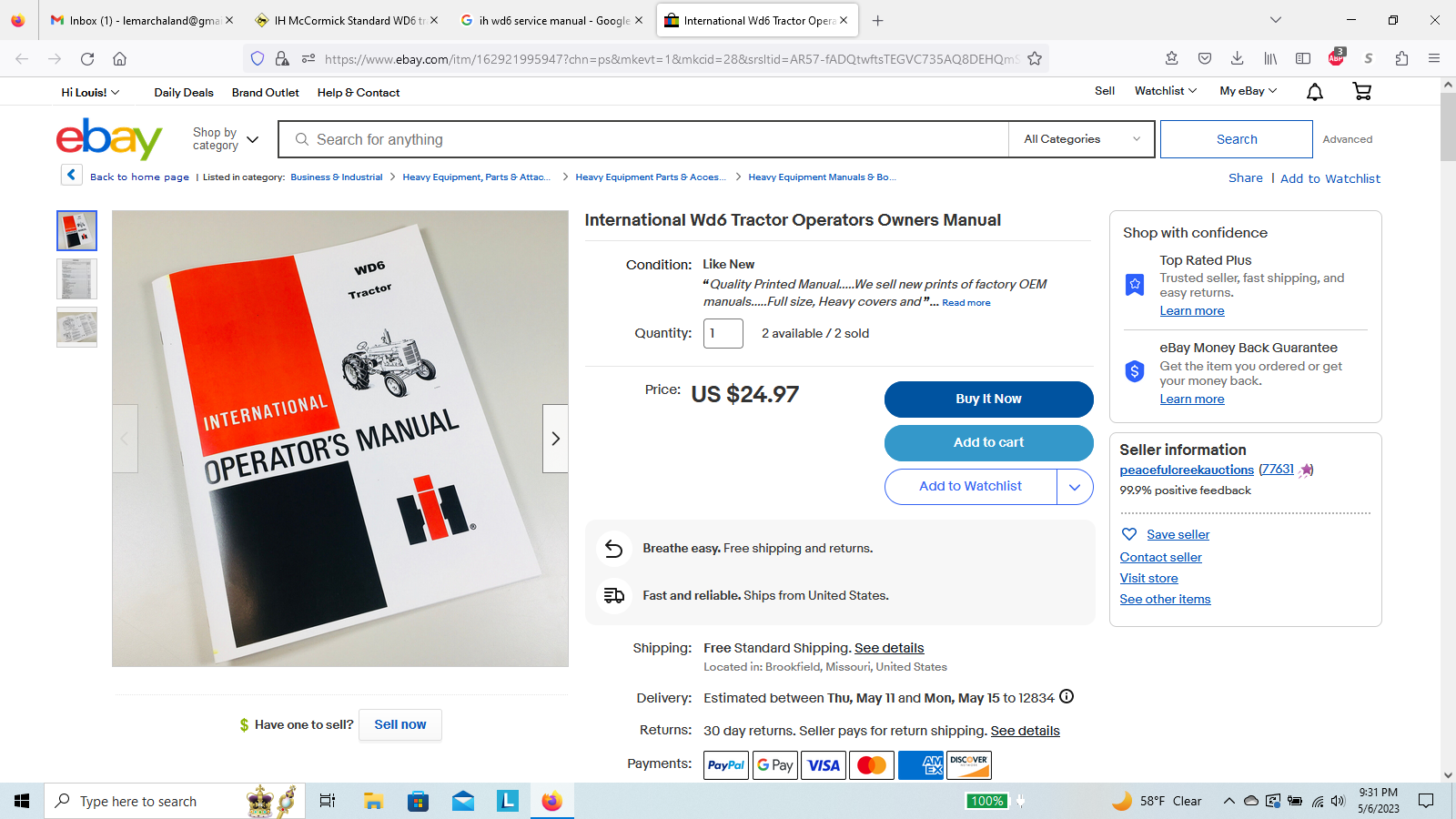

Finding information on this tractor isnt easy.
I see the tractor data and similar pages, but what gear oil and what other fluids does this pig take?
   / IH McCormick Standard WD6 tractor #36
Almost any engine oil will exceed the specs of oil when she was built, so any good diesel oil.
Most of the drive trains back then were using gear lube, although some did use 30# engine oil.
That should be an oil bath air cleaner they work best with a straight 30# engine oil.
Manuals will be your best friend;
