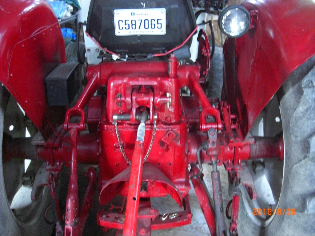

I have just acquired a brand new 1967 IH 424, well maybe not brand new, however in great shape. I would be very interested in the manuals. Let me know what you need.
