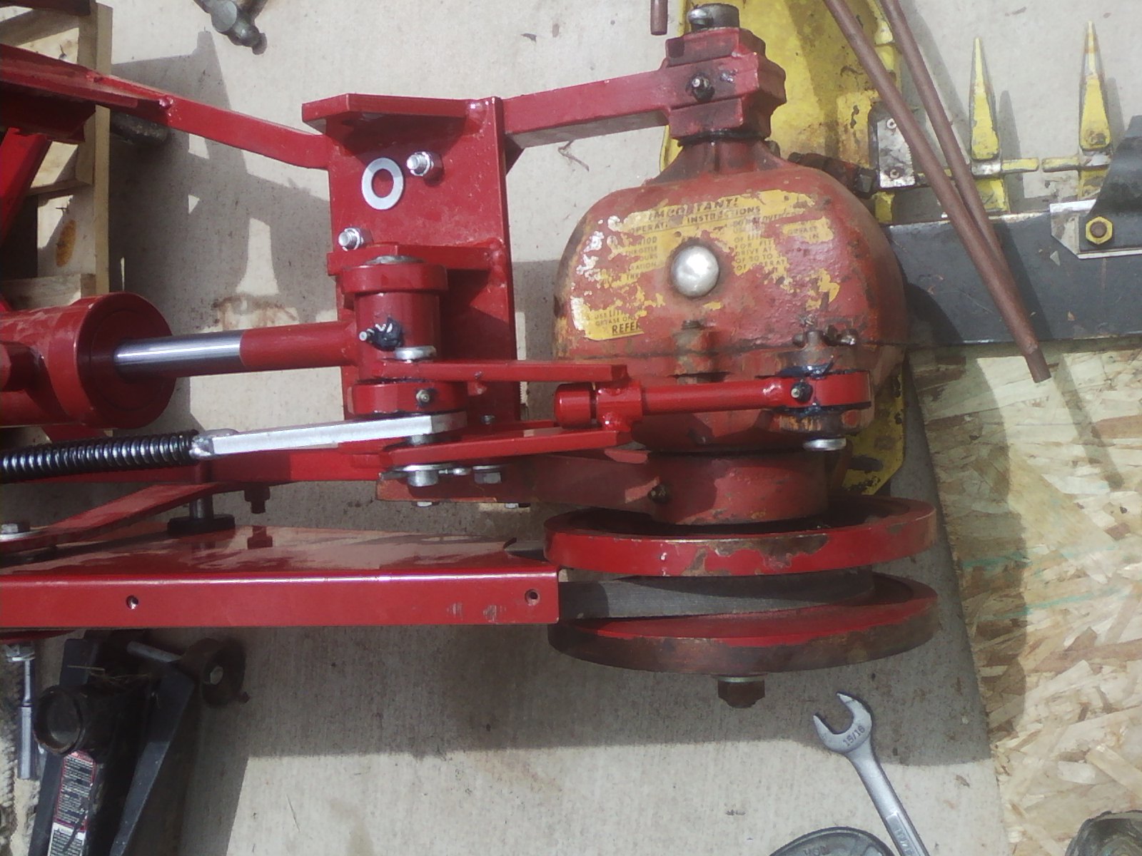

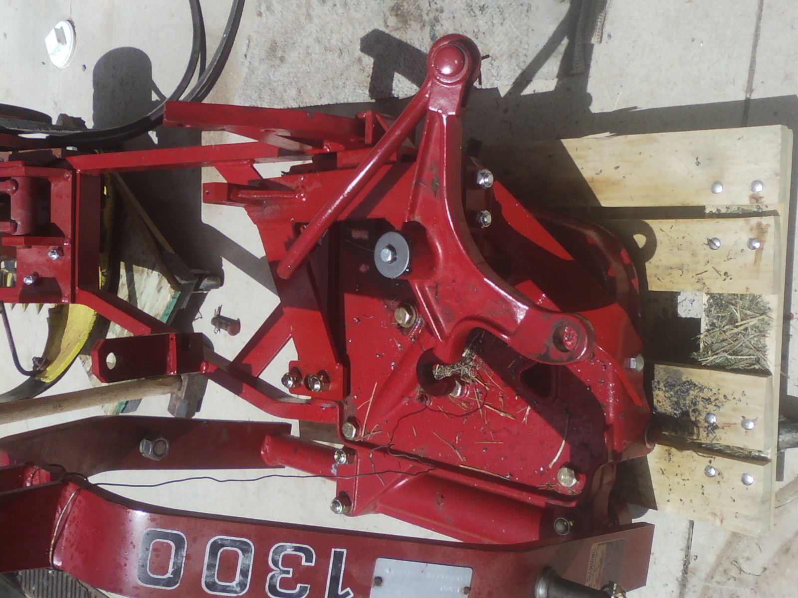

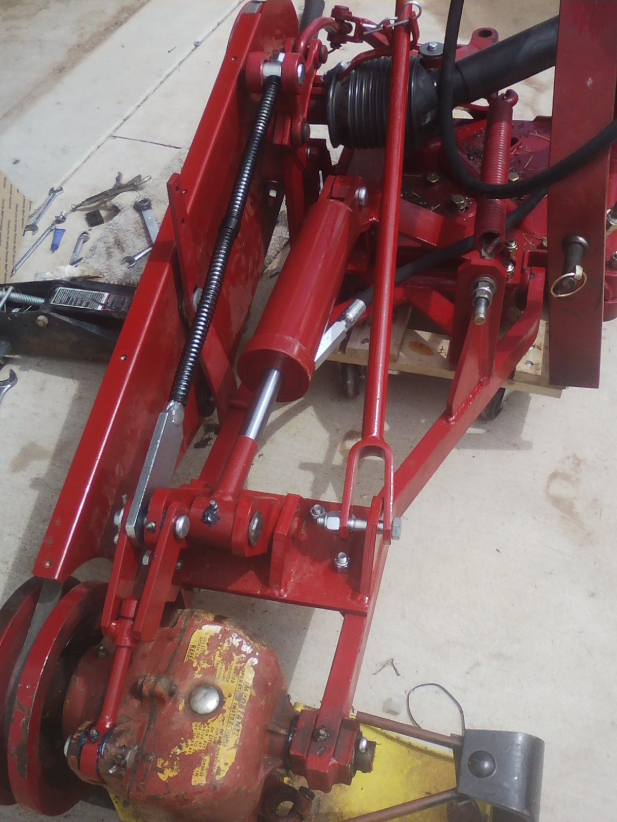

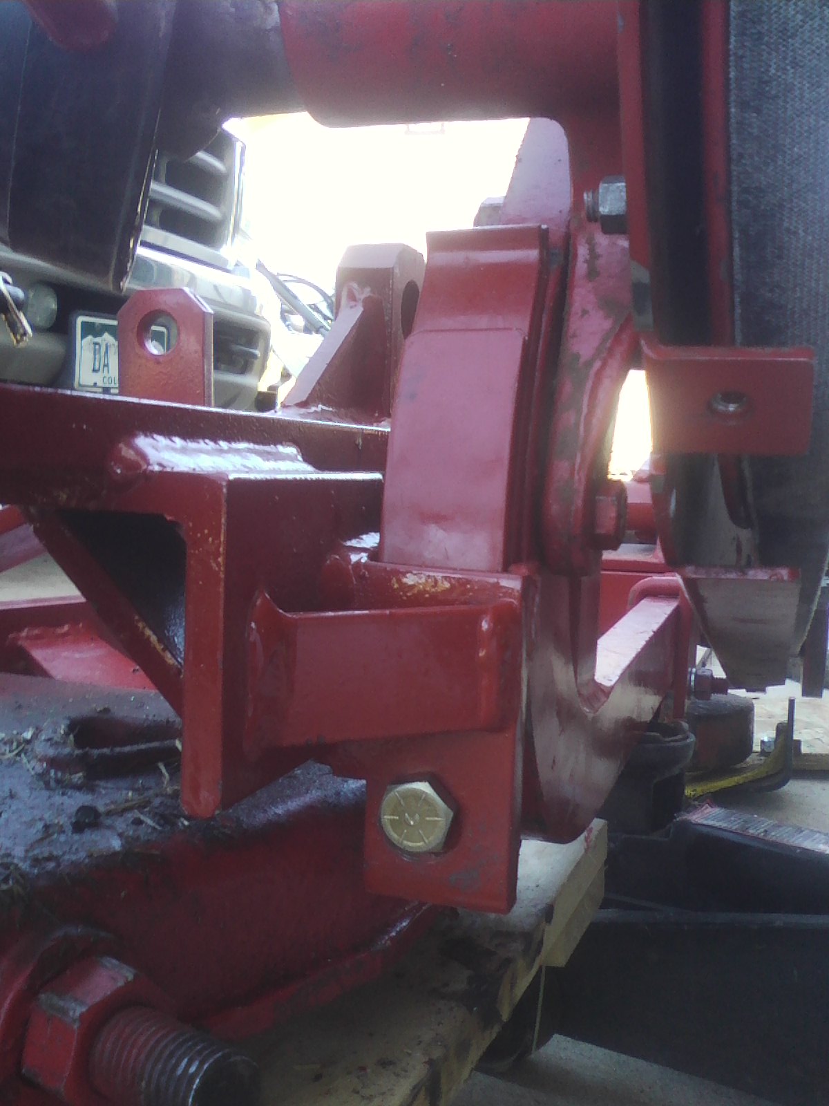

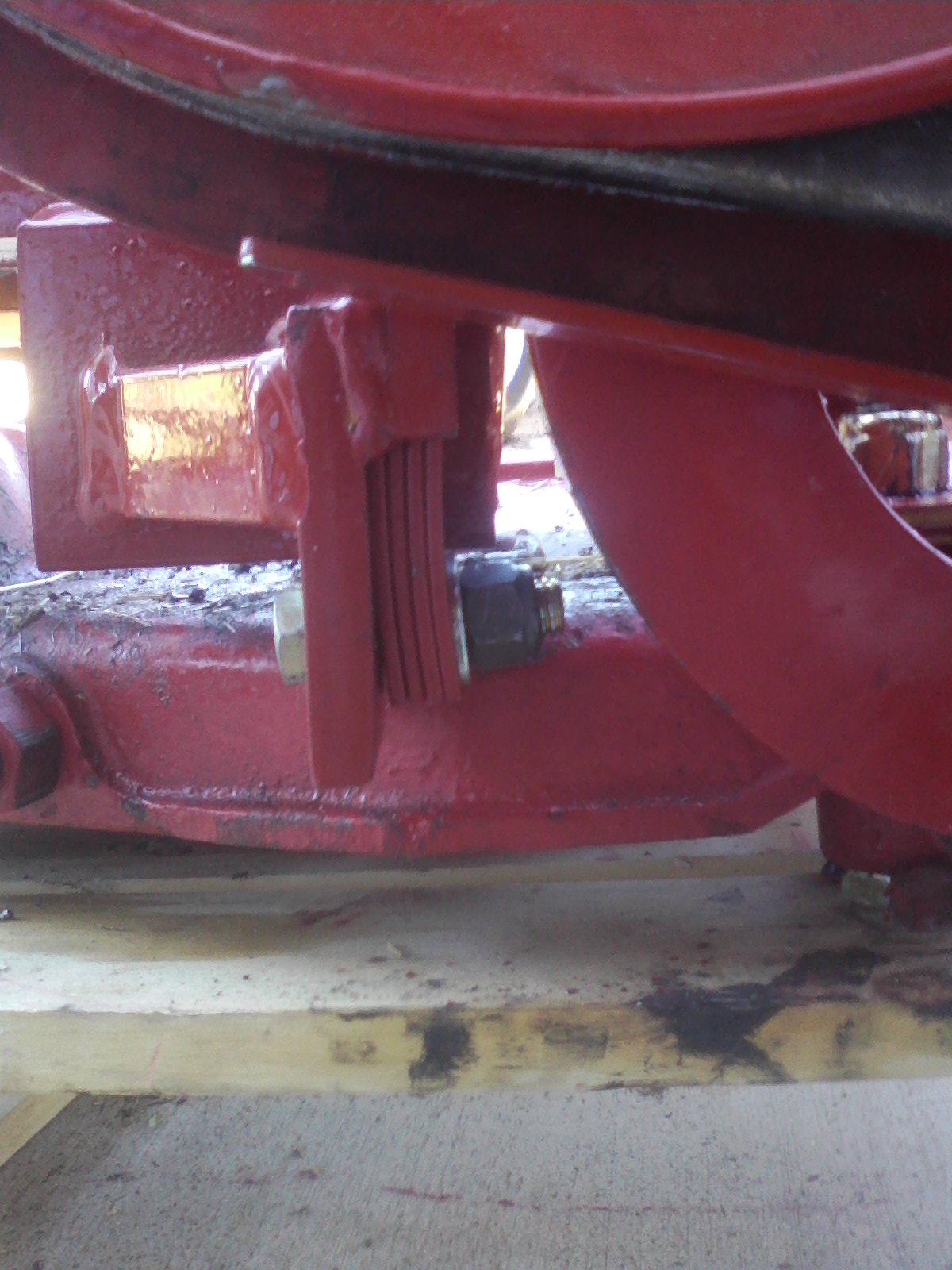

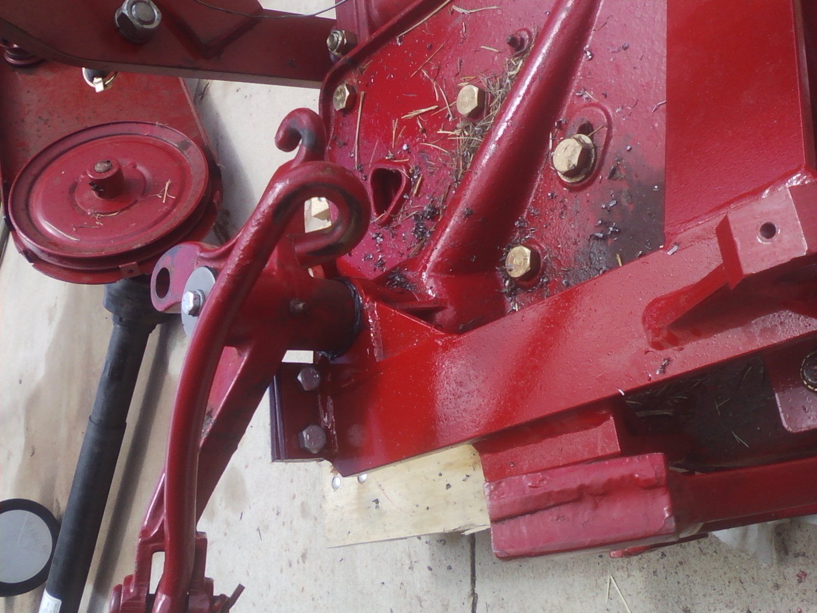

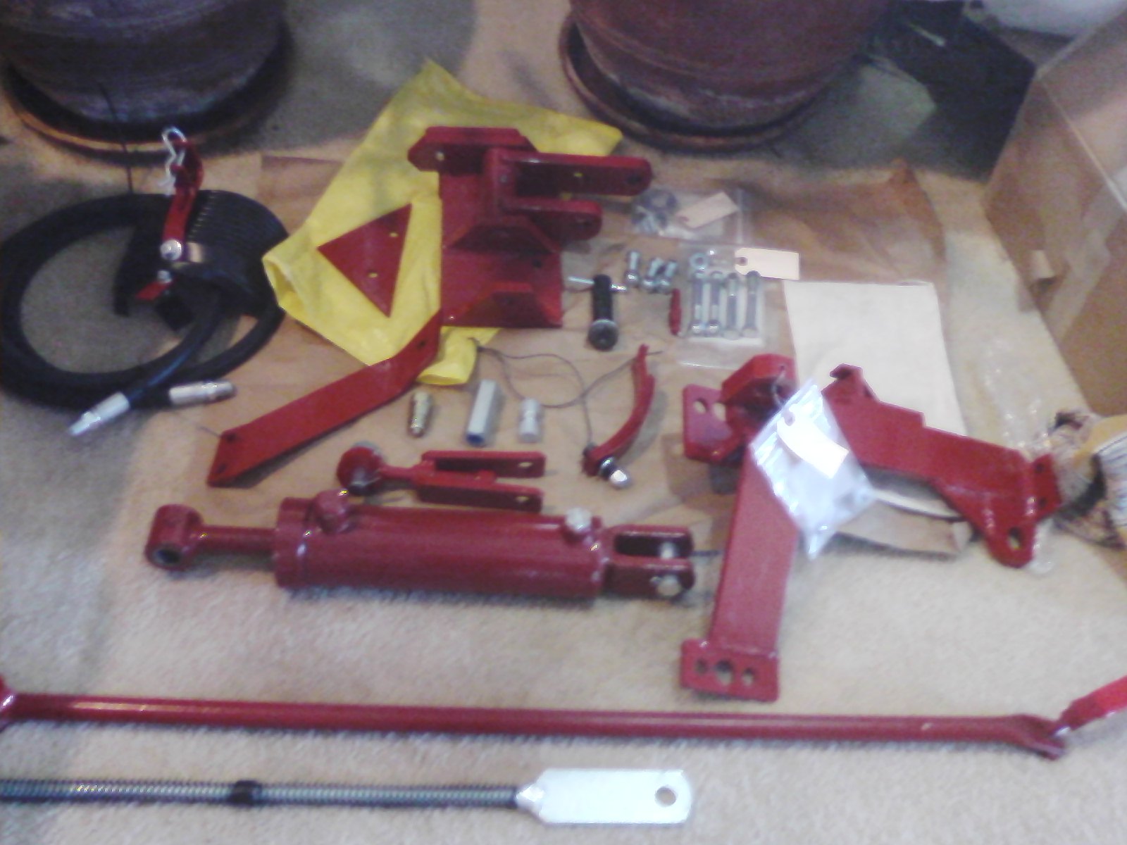

OK as promised here we go. First the Rowse contact information. Ryan Ballagh, ROWSE HYDRAULIC RAKES CO., 84504 STATE HWY 11, BURWELL NE 68823,1-800-652-1912,(308)348-2276. Ryan was great to work with and Eric in the shop is the man on the install questions. You can't ask for better folks. Home - Rowse Rakes

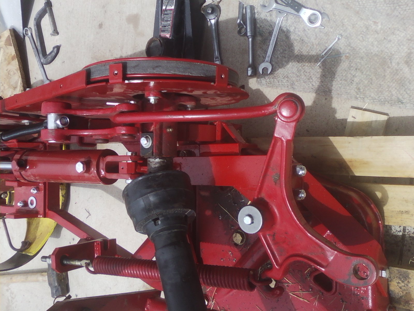

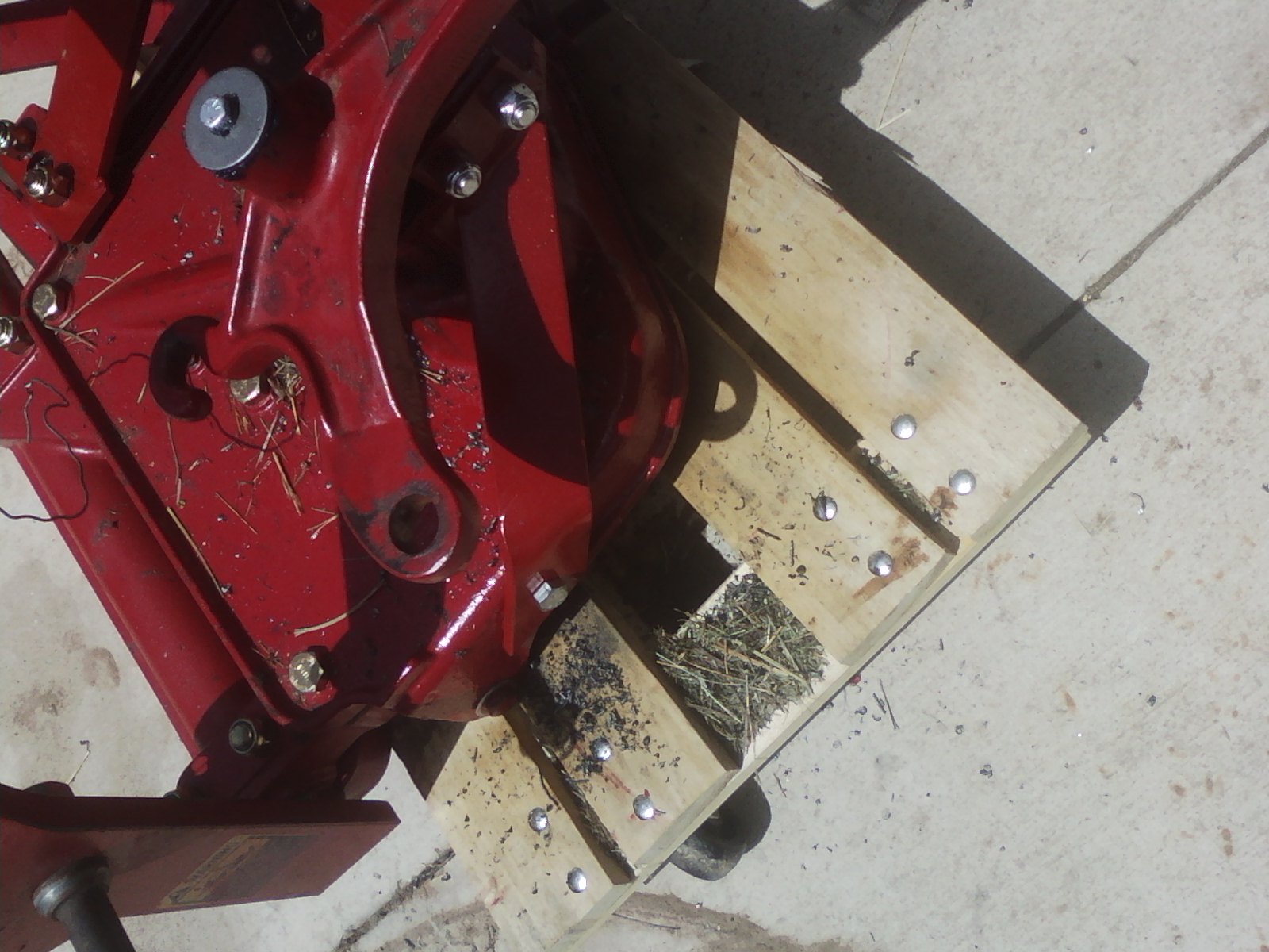

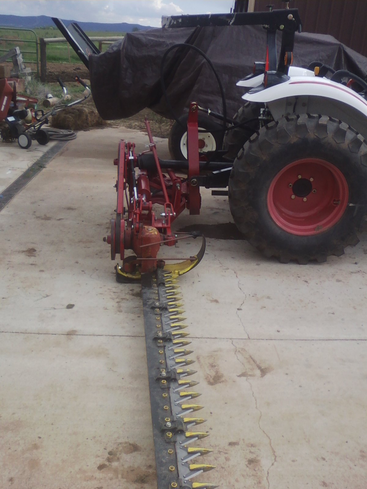

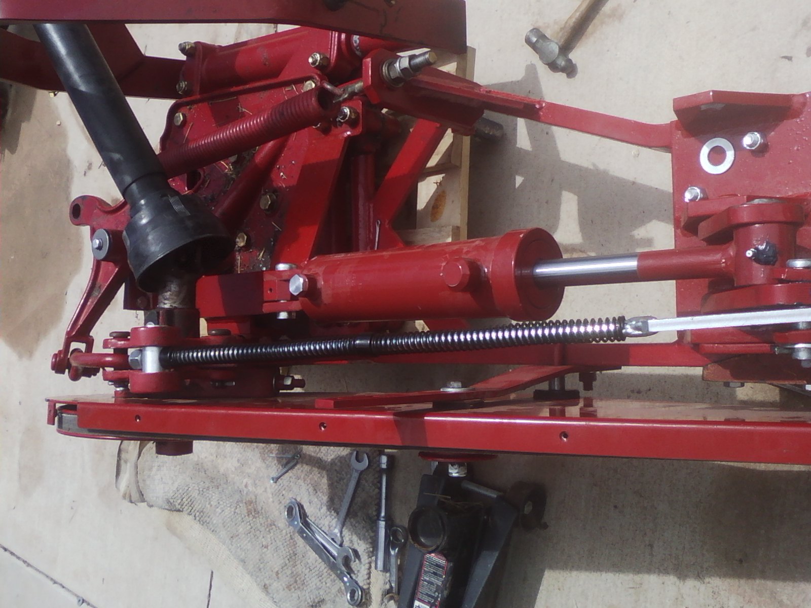

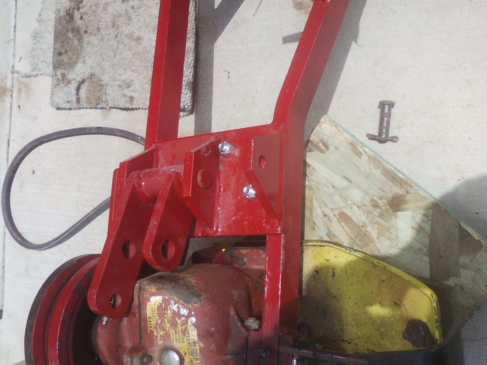

I know the first question you have is why these folks. Well First IH made the 1300 mower and the pull behind 1100 model. Then Case bought IH and added their name. Then they went bust and a company called New Idea picked up the line. After they folded the Rowes folks picked up the patent and are still making the nearly identical units with just a few improvements. However, this is the good part - their parts fit and are available and they also rebuild the heads. Prices seem very fair and they do quality work.
View attachment Install instructions.pdf

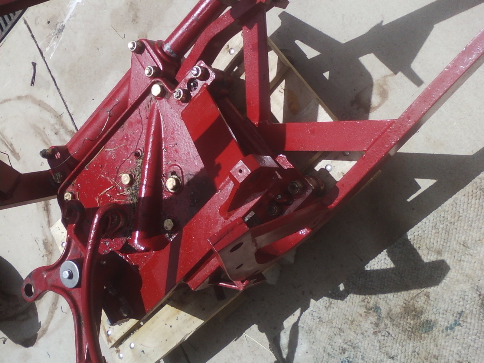

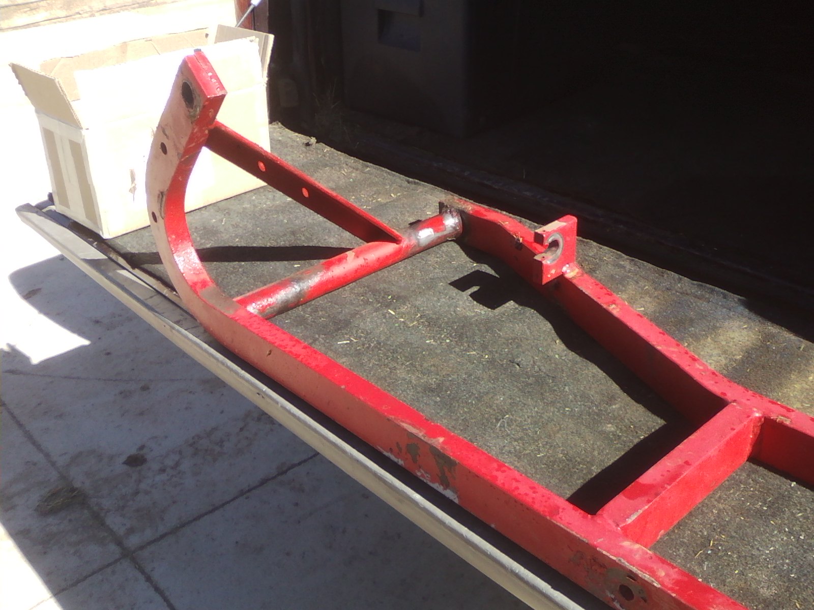

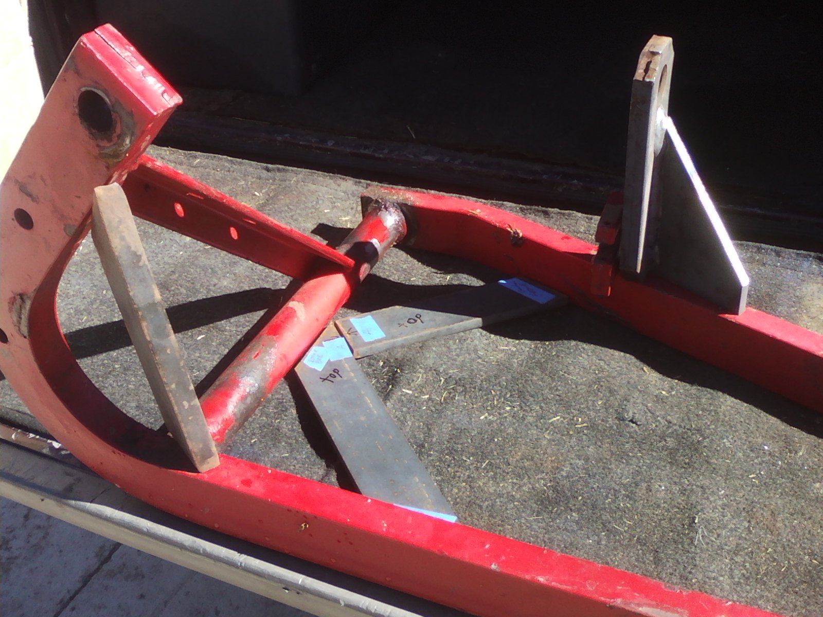

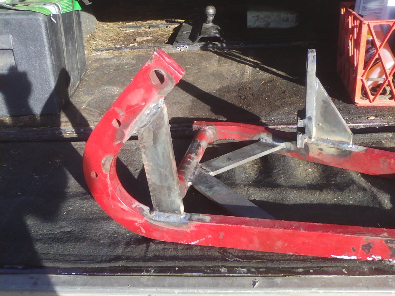

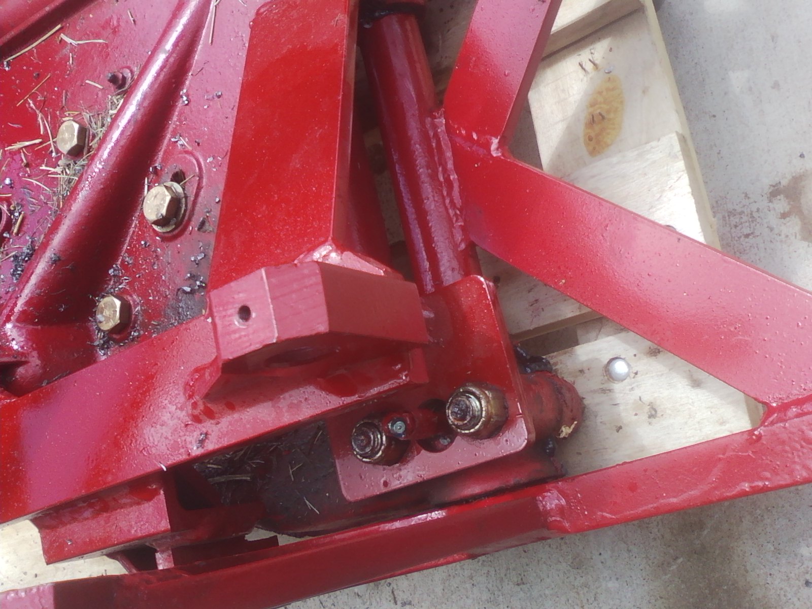

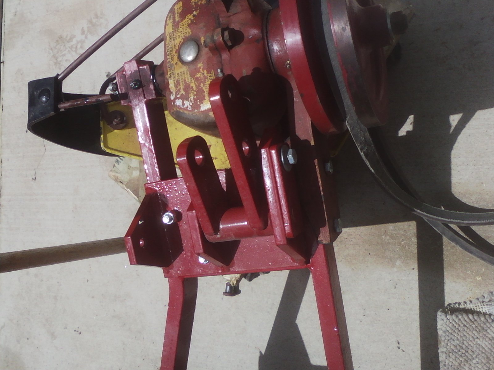

I am posting the instructions - not the best, but using this and what they have online, you can figure it out. Also as I have an older IH 1300, I had to have some pieces added to my J frame for the kit to work. If you order be sure to look at your frame and let them know. The next photos after the instructions are of my original J frame and then the precut pieces and final welding of them in place. As I don't weld I had a pro do it for $20.
