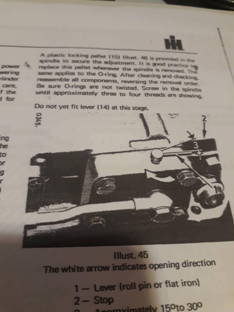

Feb 22, 2018 / IH 1055 lift does not drop down #1 Farmer8630 New member Joined Dec 6, 2015 Messages 3 Location Poland Tractor Ford 8630 Hello, I got International 1055 tractor but the lift does not want to drop down. Where can I find the problem? Thanks
Feb 22, 2018 / IH 1055 lift does not drop down #2 DLTTrekkers Veteran Member Joined May 12, 2014 Messages 1,568 Location Paarl South Africa on rockshafthousing at left front corner is a tap that can be turned only one turn. It can be turned full out ? Turn in and rockshaft will lower !
Feb 22, 2018 / IH 1055 lift does not drop down Thread Starter #3 OP Farmer8630 New member Joined Dec 6, 2015 Messages 3 Location Poland Tractor Ford 8630 can you provide photo? please
Feb 22, 2018 / IH 1055 lift does not drop down #4 DLTTrekkers Veteran Member Joined May 12, 2014 Messages 1,568 Location Paarl South Africa
