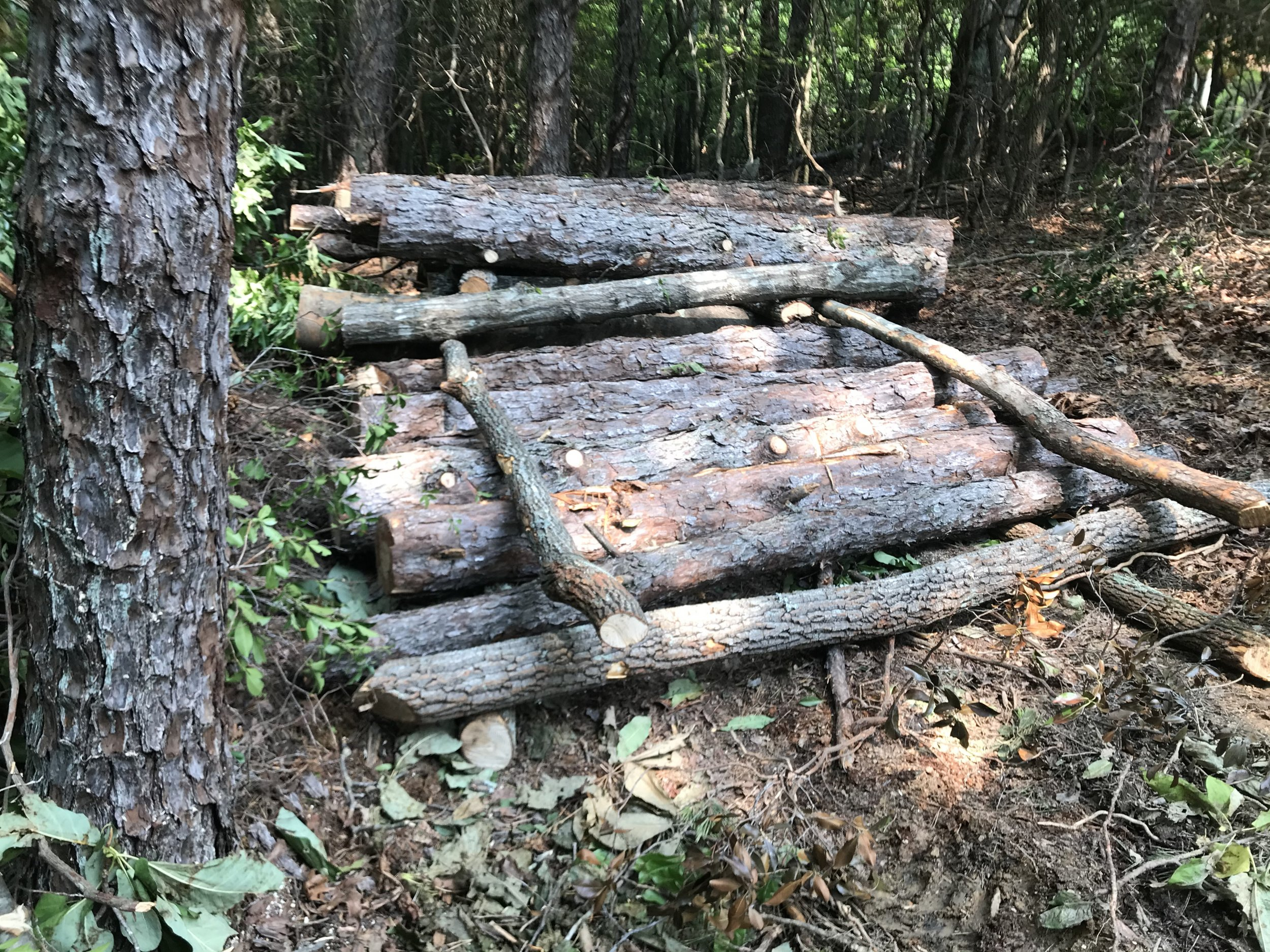

I think my chipper is adequate. It will take a 4" limb but I will be stacking everything 3" and up for my in water stove.

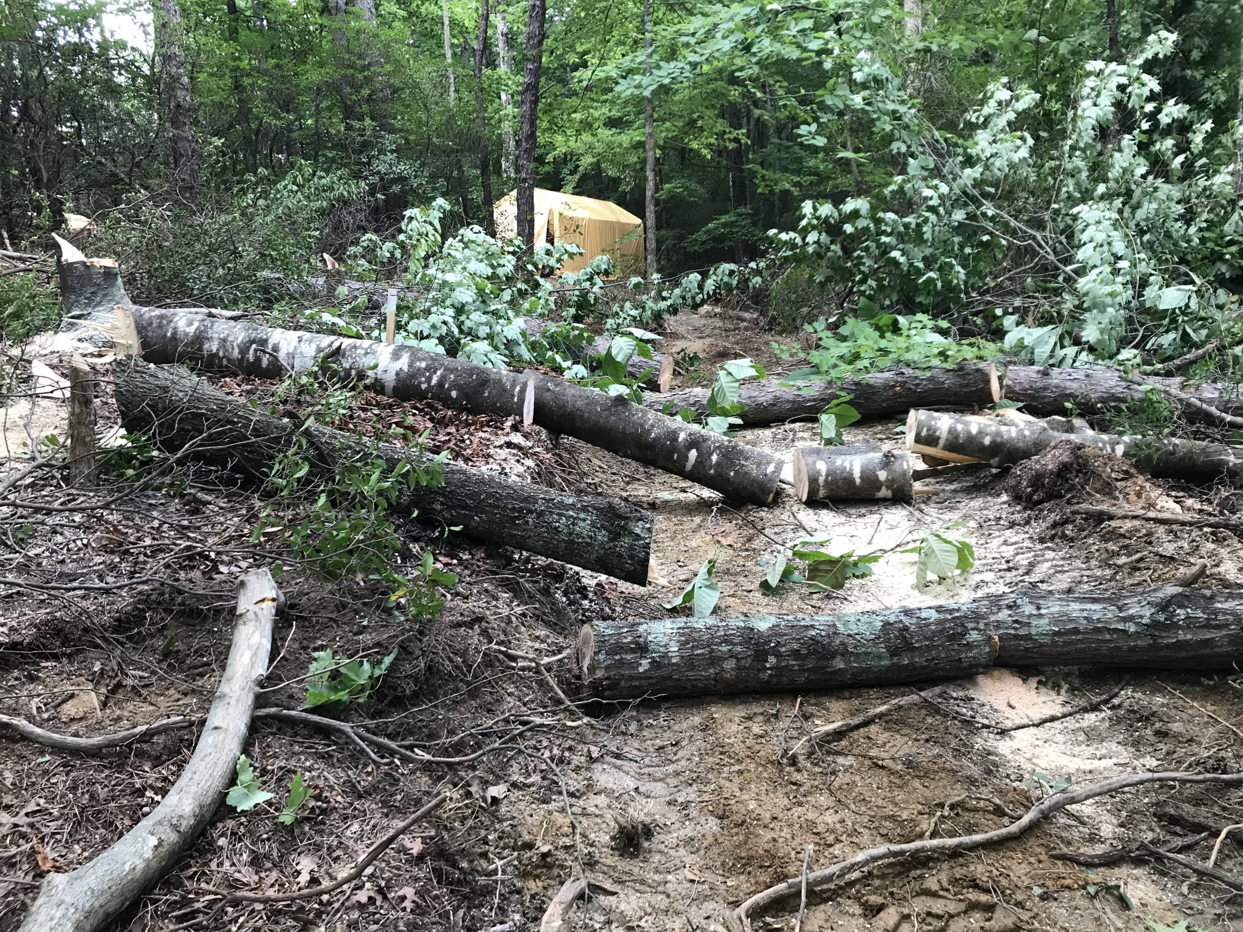

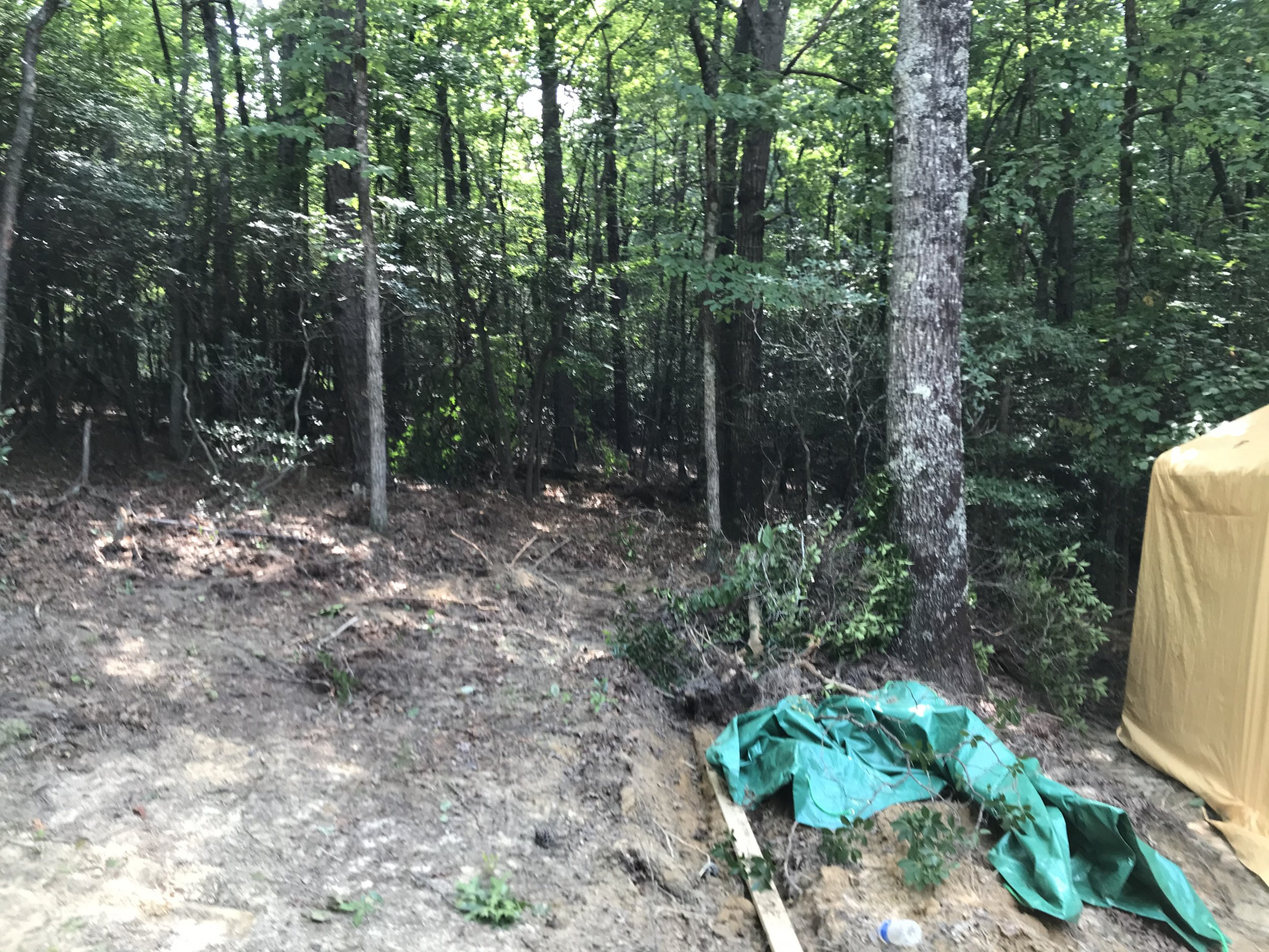

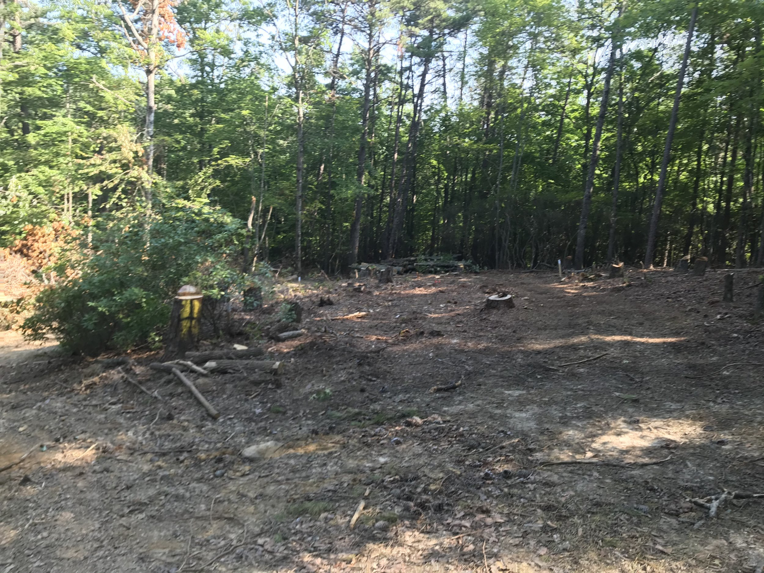

Here are some pictures over the last month.

Thanks for the link. I will be looking at that tonight. I am having the grader push all the tree tops and underbrush down the hill about 200' away from the clearing.
From what everyone is saying, it looks like I have a lot of things in place but you all have offered some other things that I will incorporate and I appreciate each post.
