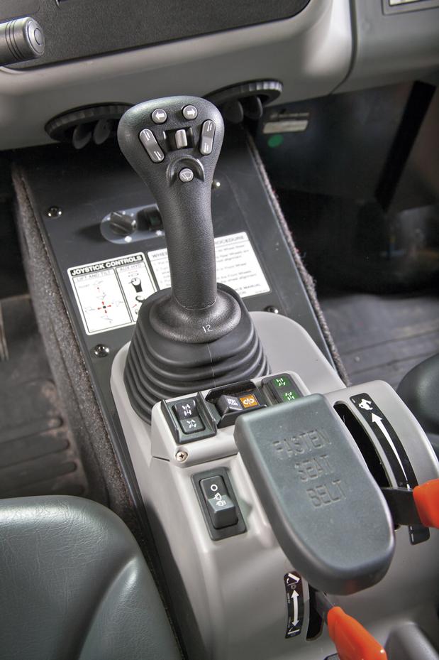

I recently bought a new 2019 Toolcat 5600 with all the options. My Bobcat branded V-Plow just came in and once I got it home I hooked it up right away. I had nothing on the angle, I checked fuses and noticed there wasn稚 one in the remote hydraulics spot. Put a fuse in and now my angling works except my left wing is controlled by the top two arrows on the joystick not the left cylinder marking on the joystick. Dealer told me it worked on their skid steer at the shop correctly but I don稚 believe that. I also had to switch electrical connectors on the plow for the right wing to open and close correctly with the joystick marking for the right cylinder. I also brought this machine home and discovered there was no engine block heater like ordered and paid for. Not to impressed with my dealer so far.

The block heater is very simple to install as it fits in a dry pocket.....no coolant exposure.
Try your angling with the thumb L/R toggle.

Yeah I installed the block heater myself after he sent it UPS to me it was literally a 10 minute job. My left blade angles with the top left and right arrows not the left cylinder marking as I would assume it would. I believe it didn稚 work with the thumb toggle either but I壇 have to confirm that later after I get out of the deer blind.

The thumb toggle also operates the right wing. So to clarify the right blade will operate with the thumb toggle or the right cylinder icon. The left blade only operates with the top arrow icons. To me this seems wrong but I知 new to a Toolcat or construction equipment but I have owned several tractors. To me the right cylinder icon should operate the right blade and the left blade should be controlled by the left cylinder icon.

For those that have not seen the joystick on the G Series, here is a picture:
