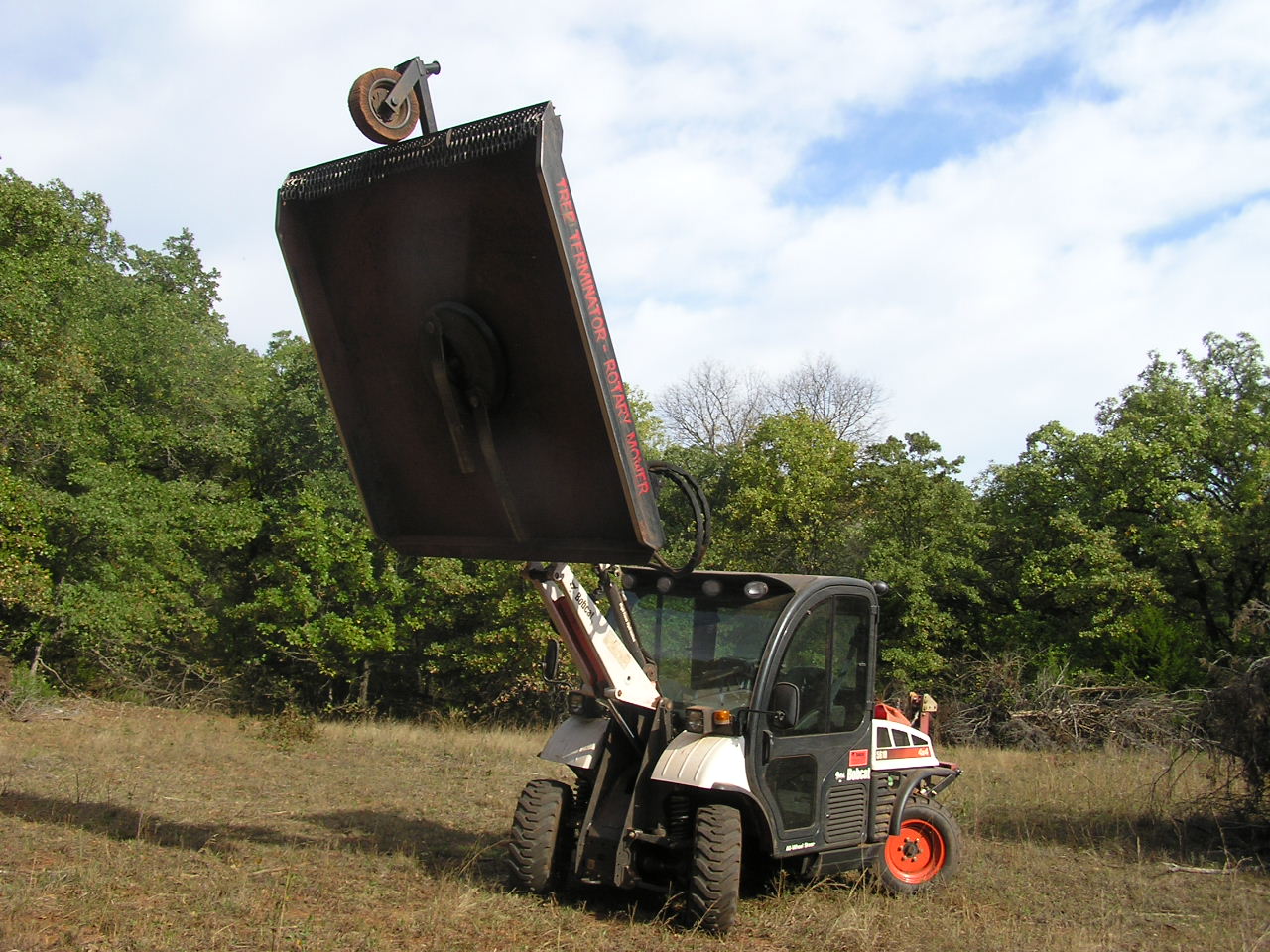

Here is what I measured with nothing on the SSQA, 3,001 pounds of lift:

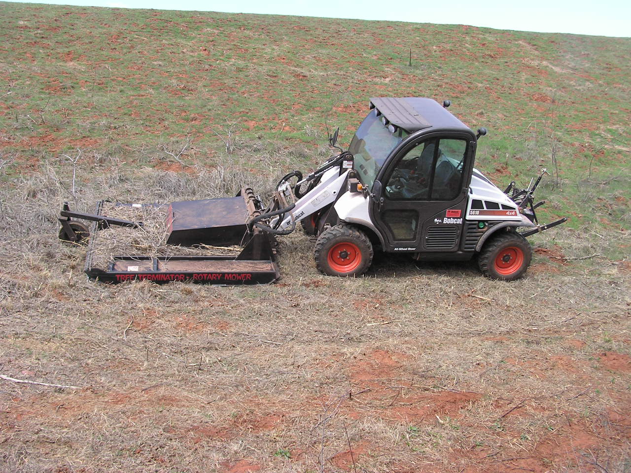

Grace Mfg. says this 7' brush hog weighs 1800 pounds:
It will handle it without any counter weight on the 3 point. :thumbsup:

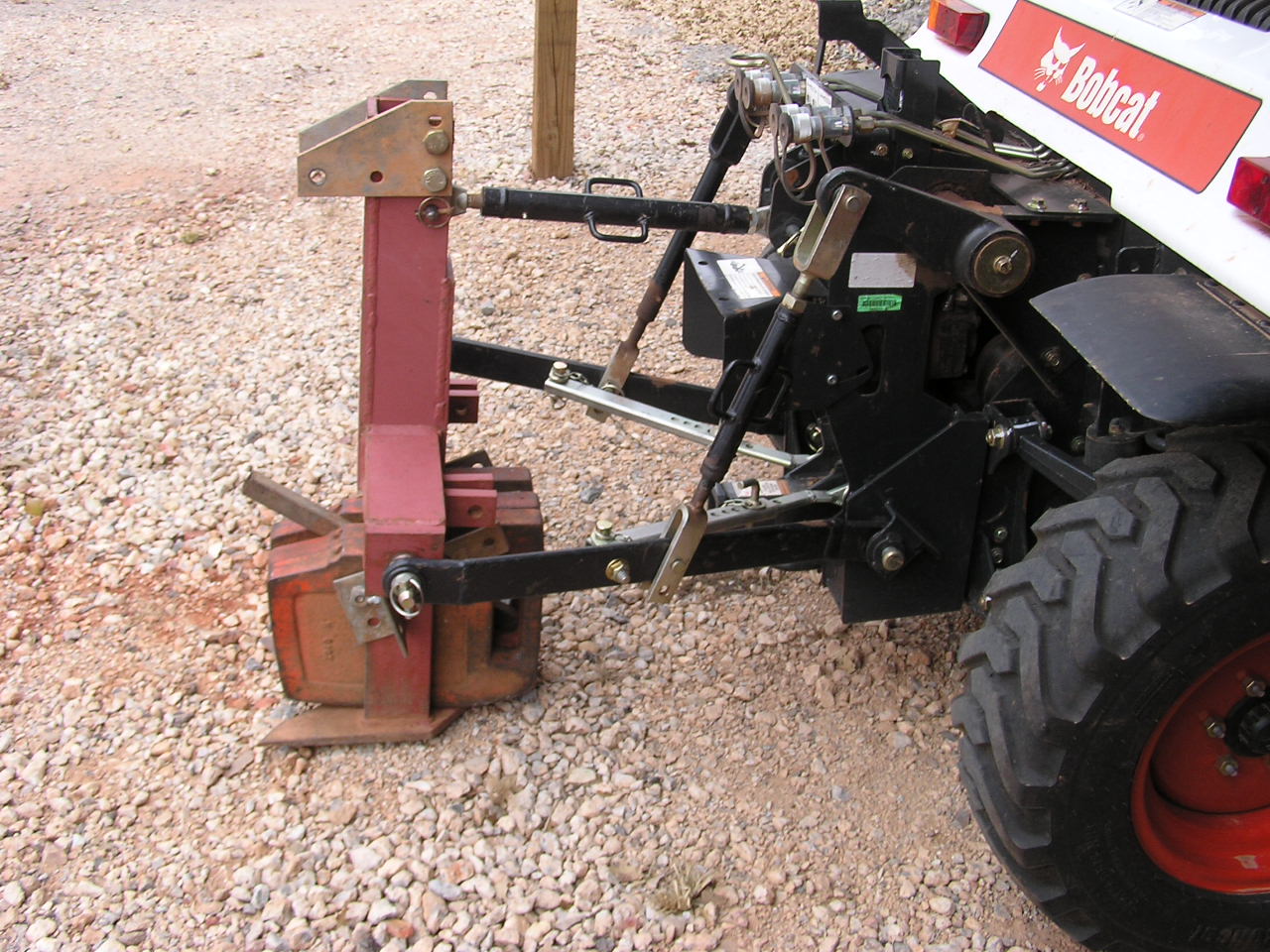

I forgot to mention, when moving around that much weight I find it helps to have some ballast at the back of the bed.(especially when working on slopes)
DEWFPO
   / If you have Toolcat questions, ask them here... #417

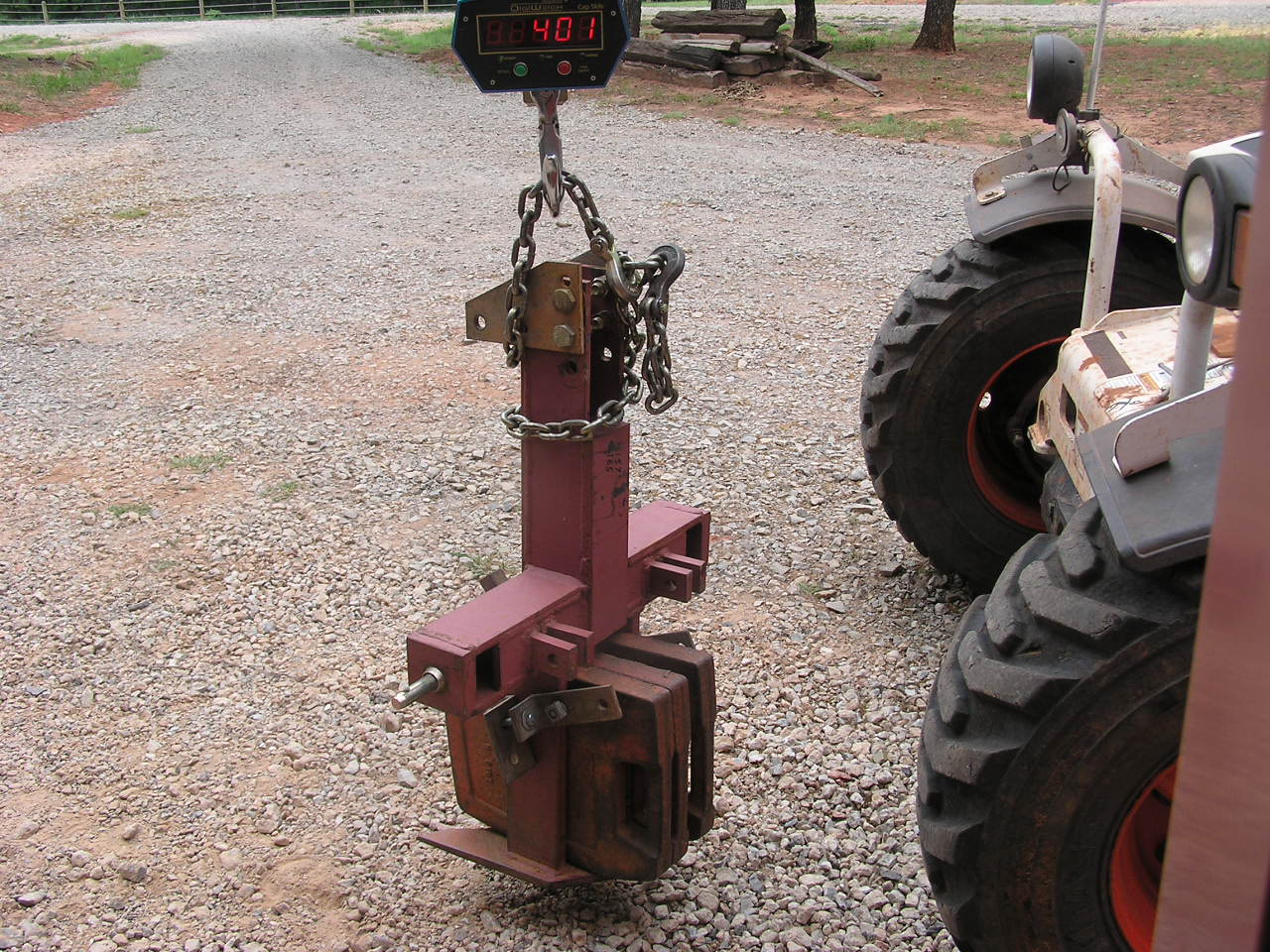

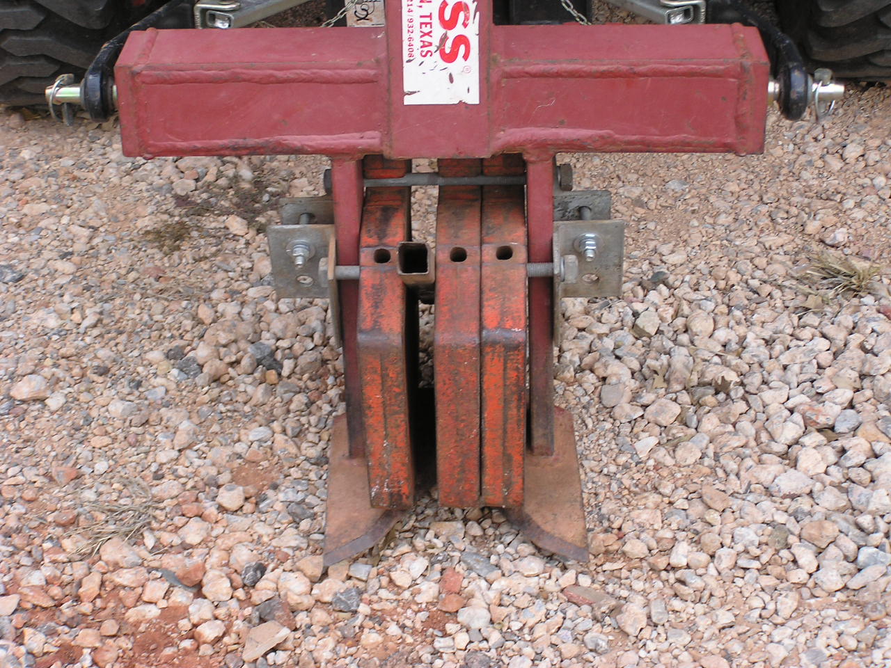

Yep, that is why I added about 400 pounds on the 3 point, steers better and doesn't slide sideways on a side hill.
