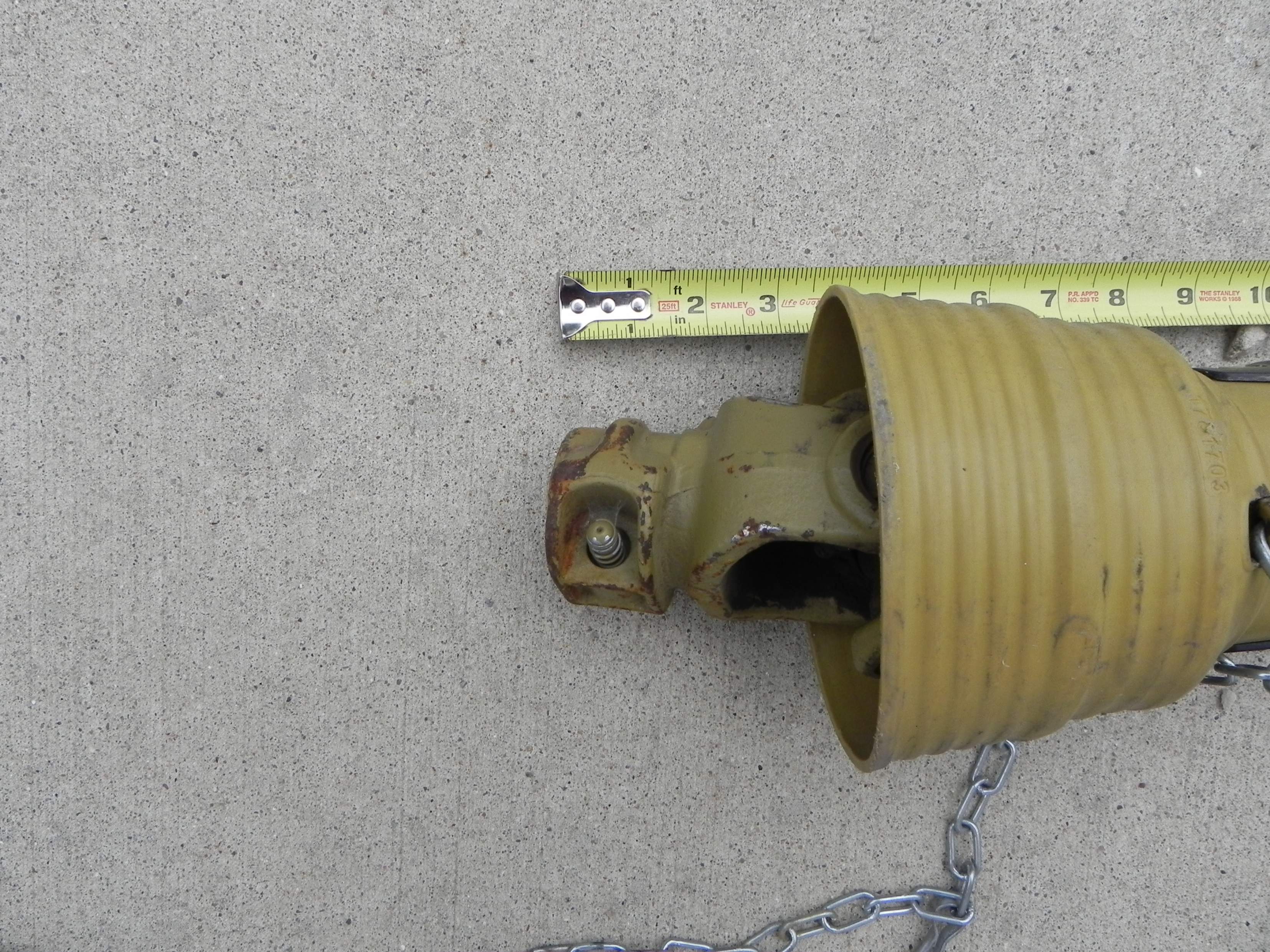

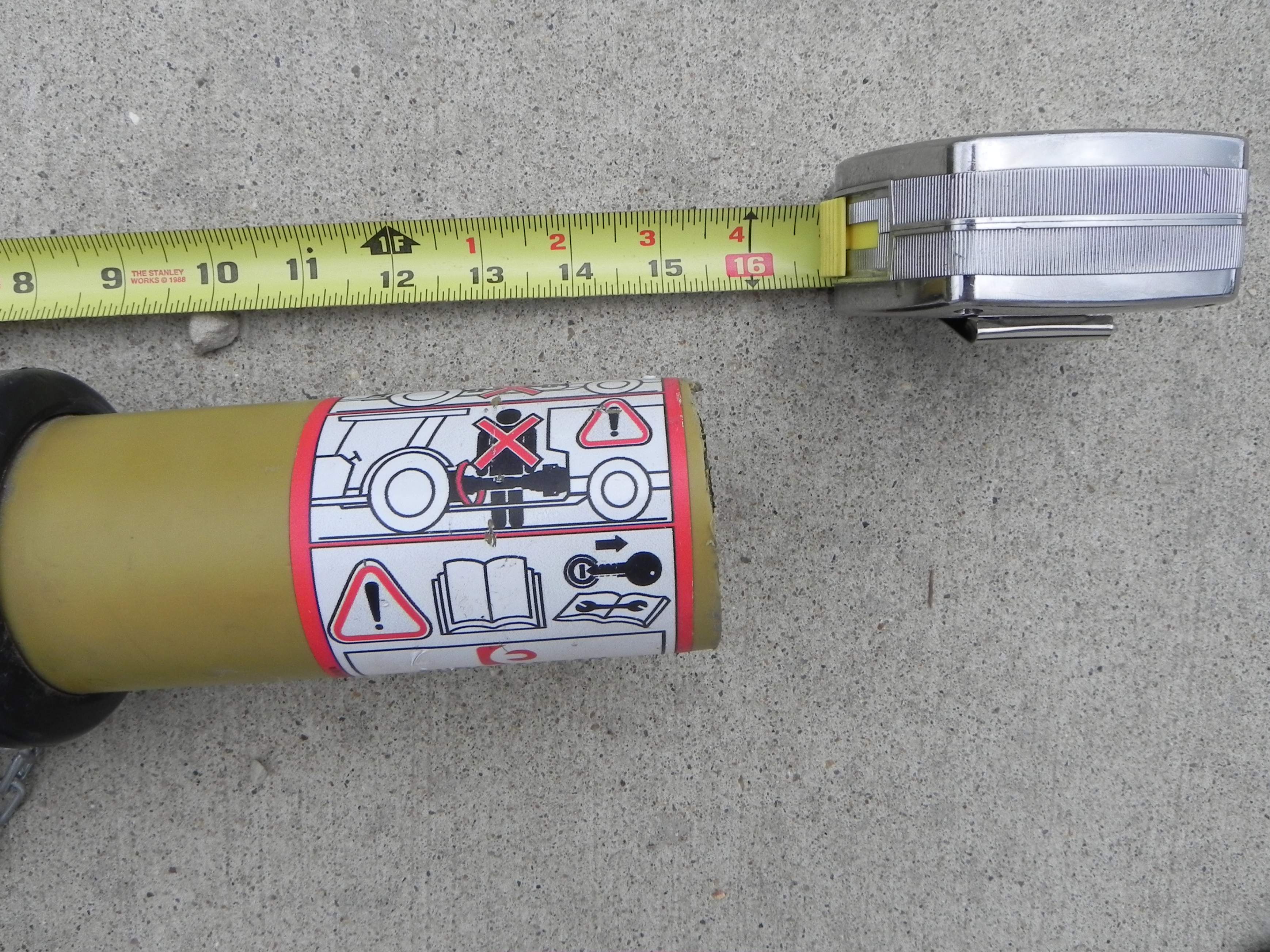

OK, here is what I ended up with. Though in sharing this, I really hope you'll do the steps to see if it would be the same for you. I have no idea if the configuration of the mounting locations of the gearbox on the tiller, or the framing itself or anything may have changed on the newest tillers. If the gearbox mounts closer or further from the tractor these days, my length could differ than what you would need.
Anyway, I cut both halves down to a total of 15 1/2 inches, from the end to end. Here's the front half.
Back half is the same - 15 1/2" including slip clutch.
