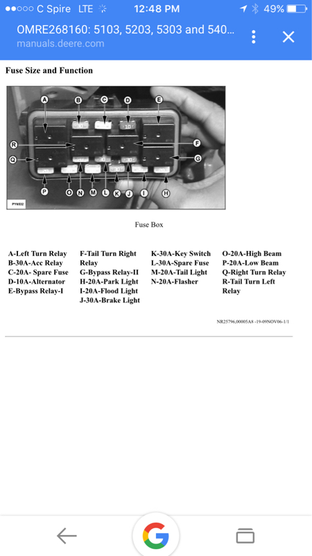

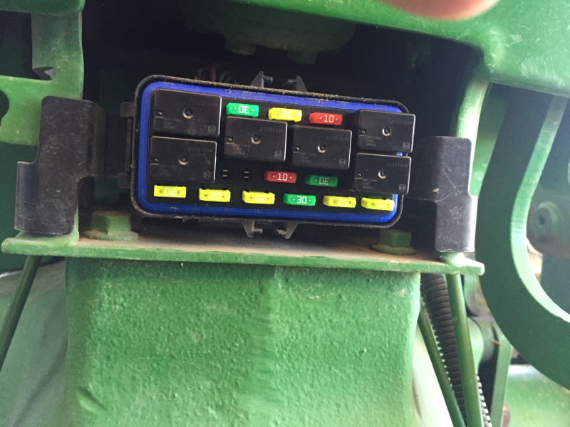

Looking for a little help and advice before resorting to calling mechanic. I have a 2008 JD 5303. Seem to be having the same issue as described in this thread. Tried disconnecting the Coolant Temperature sensor and still blowing fuse. Engine turns over, but sounds as if is not getting fuel.
Attached is picture of my fuse panel with blown fuse taken out. It is a 20A fuse. Also attached is picture from JD site of what this fuse is supposed to be for. Note it states flashers. I still have working flashers and signals. Fuse blows as soon as key is switched on. Have tried several times after disconnecting sensors on left side of engine and Coolant Temperature sensor with no success.
Have a couple more fuses before having to go into town for more. Any suggestions appreciated.
That's a big difference in fuse panels over my 07 5303, assuming it's because of the 4WD:confused3:
