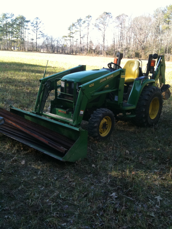

I am a firm believer in any model tractor is better than no tractor. I had a JD 4115 with loader and hoe and cleared stumps with it but we didn't have an endless supply of time (property is 5 hours from where we live) so we ended up having someone come in to do it. I just bought a 2520 and will put a backhoe on it at some point in the future. Ultimately the only opinion that matters is yours. I am partial to John Deere but can honestly say I believe there are several models of other brands I would have no problem owning.
