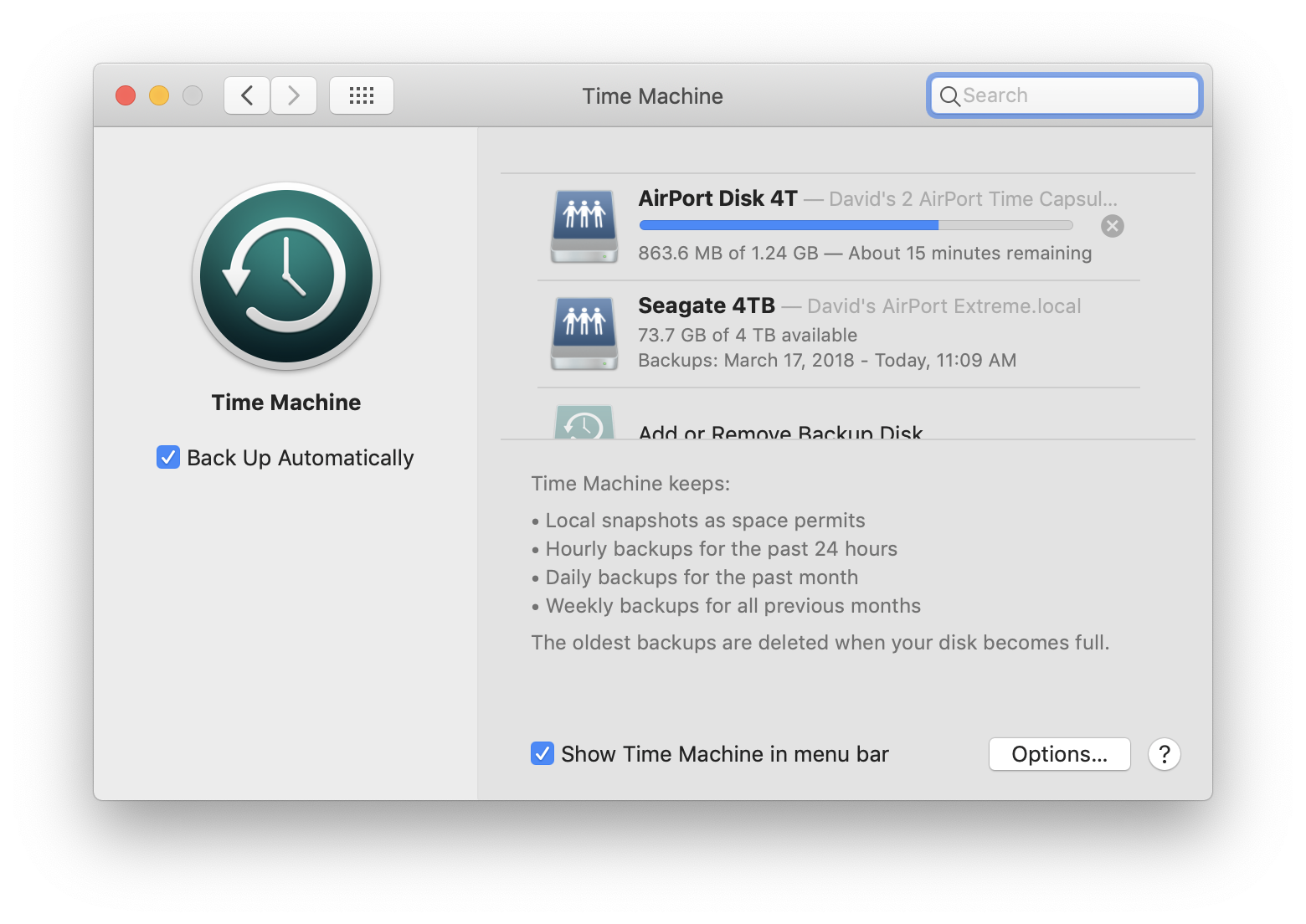

Should have taken this clean sheet opportunity to convert to Mac. :)
Apple added Time Machine to MacOS 10.5 Leopard in 2007. Automatically makes an incremental backup to designated volume(s) every hour. When the archive volume reaches capacity Time Machine weeds the backups every week so you only have one image per 24 hours. Then in a month or so weeds it down to one image per week. Then one per month. But always keeps the very first.
Can use a local HD as the Time Machine repository. Can use a NAS remote drive. Can pay for space on iCloud. Can use all of the above all at once. If you have 3 repositories it updates one at a time. One this hour. Another the next hour. Then the 3rd. Then goes back to the first to catch it up...
Apple used to make excellent Apple Airport WiFi routers. Later versions could be had in Time Capsule format with a built-in internal HD. The Airport Extreme had USB port supporting external HD, and probably printers. I've never tried connecting a printer.
With a large enough HD you can backup several Macs to one Time Capsule/NAS. The default archive size is 1.5T per machine, stored in a single disk image (optionally encrypted) to maintain ownership/access control.
When Time Machine was introduced I.T. professionals poo-pooed its simplicity. Time Machine copies the entire changed file into the archive, not just the parts which changed. "Terribly inefficient!" they said. But Apple's way does not require any special software to search or extract files from the archive. You can use Time Machine to view the archive for retrieval but you don't have to. If you want to know if it is working just go waltzing through the archive.
