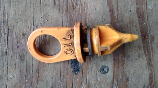

If the HST dipstick on your BX looks like this....
   / If the HST dipstick on your BX looks like this.... #1
brinet
Bronze Member
Jun 15, 2004
66

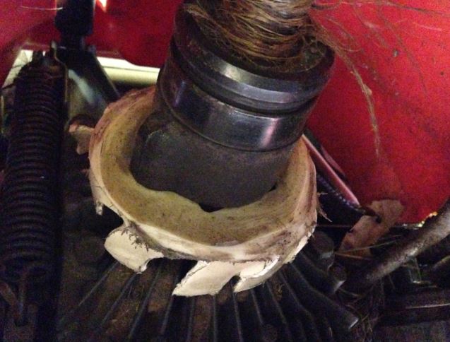

then your HST fan probably looks like this....
   / If the HST dipstick on your BX looks like this.... #2
Both invalid attachments
   / If the HST dipstick on your BX looks like this.... #3
Woah!
Everything works OK?
Everything seems to be working. Not my tractor and it's a mystery how it happened.
My question is "What is the melting point of the dipstick?"
This is why I'm working on a HST temp gauge and warning light.
   / If the HST dipstick on your BX looks like this.... #7
It's hard to tell from your pic, but I doubt the dipstick handle melted.
The fix might be to install a new fan and a skid plate; there is one already available; others here can tell you where to get one.
A temp gauge could be made from a oil temp probe installed into the HST oil pan, which would monitor and display the HST oil temp on a constant basis, and could be used to establish an acceptable operating range for the fluid.
It might even be able to be done through the dipstick port via a temp thermo-probe from a multimeter, without having to remove and drill a hole in the HST pan.
   / If the HST dipstick on your BX looks like this.... #8
I would bet that an in line sensor would be pretty easy to do, and they might have one from a different machine. Personally I always hated idiot lights, I want a needle with a background of numbers.
#9
The dipstick did melt. Owner is replacing fan, changing fluid and filter today. I'll update with any new findings after the repair.
   / If the HST dipstick on your BX looks like this.... #10
So the dipstick is plastic, in addition to the dipstick handle? What about a skid plate?
