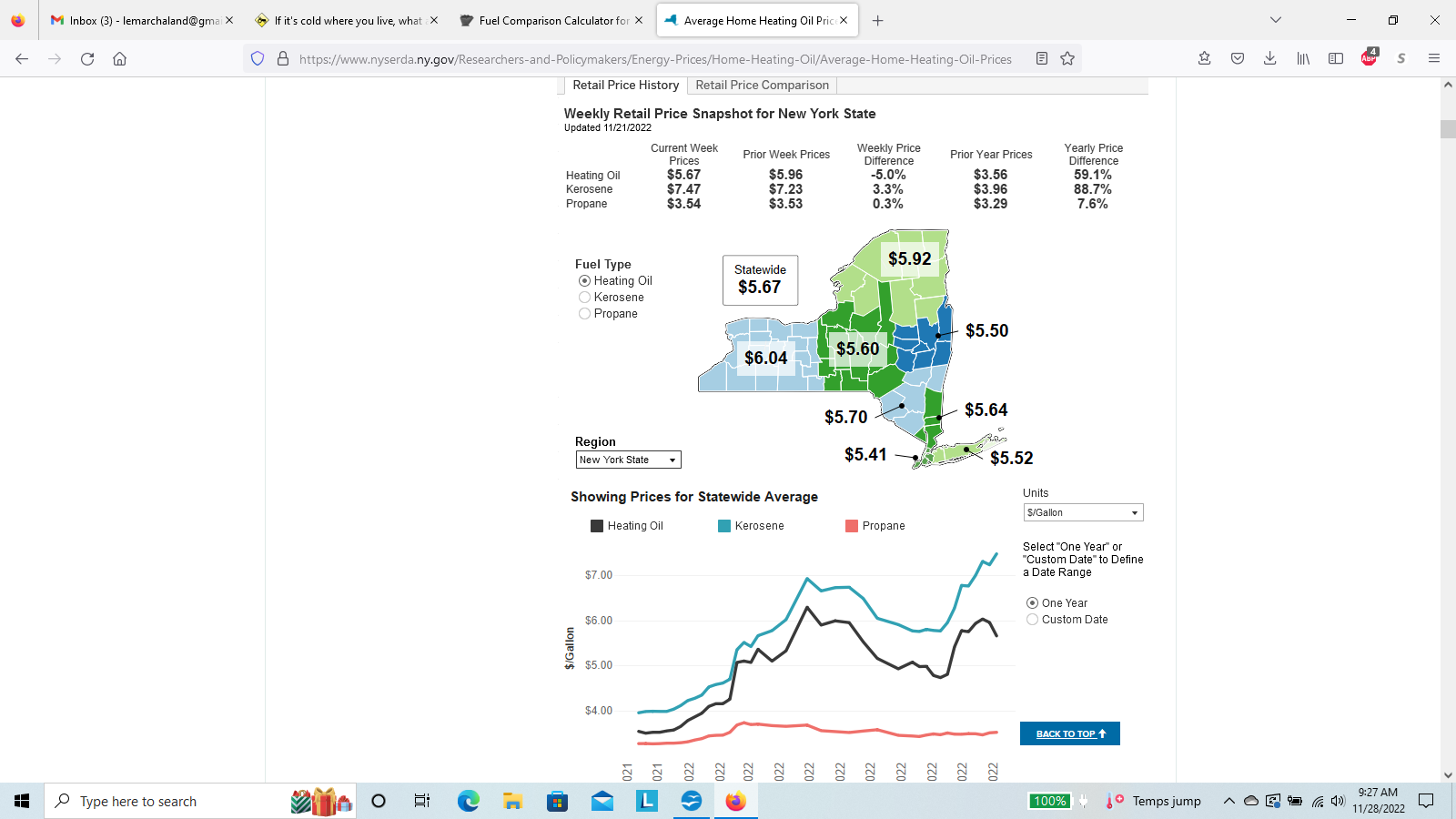

Fuel Oil No. 2 Gallon $ 5.50 138,690 btu/gallon @75% eff. $5,287.57 per million btu.
Kerosene Gallon $ 7.59 135,000 btu/gallon @95% eff. $5,918.13 per million btu.
Propane Gallon $ 3.12 91,333 btu/gallon @95% eff. $3,595.86 per million btu.
Propane Gallon $ 3.12 91,333 btu/gallon @85% eff. $4018.91 per million btu.
Electric (heat pump) kiloWatt-hour (kWh) $0.18 3,412 btu/kwh @250% eff. $2,110.20 per million btu
or my supplemental heat being coal;
Coal Ton(2000 lbs.) $550.00 25,000,000 btu/ton @75% eff. is $2,933.33 or just a bit more then my mini-splits
which are doing the heating at this time for me, coal will likely come on next week or so when it gets too cold for the mini-splits to maintain eff.
So yes this year propane would be less expensive then #2 oil,
So all I need to do is buy a couple of 1000 gallon propane tanks at $2500 -$4500 each,
And $2500 - $3500 for a new boiler plus installation and fill the tanks,
So for $10,000 to $15,000 I can have a new heat source that may save me $1500 a year
I paid $2.09/gallon of propane this year and the tank rental is included in the price. I've paid as low a $1/gallon in the past 10 years, that's cheap heat.

I think your decimal is off a couple of places. Those prices are for 100,000,000 btu

Example....electric heat pump at $0.18/kwh and 250% eff would be $21, not $2110 for a million BTU
   / If it's cold where you live, what are you heating with and what is it costing? #258
But using YOUR numbers for 100 million btu....
Firewood is a wildcard because of so many variables in wood type, wet or dry(quality) and stove efficiency. But....
Average cord of firewood is $250 and 23 million btu and 70% eff in my area.... So $1552 per 100M btu
And if you have an efficient geo like me pushing 350% but we will call it 300%, and $0.14 electric
That's only $1366 per 100M btu. Just can't justify burning wood
Still a lot cheaper than HHO or propane or even resistance electric. But not the best option
