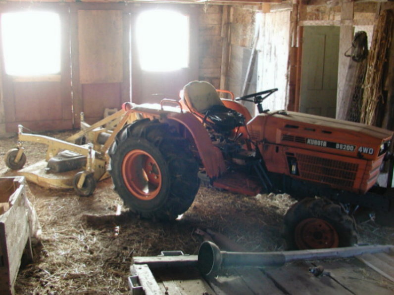

Ok, Can any of you tell me, where do I find the manufactures ID tag on a Kubota B8200 4x4. I'd like to find the serial # so that I can determine it's age.
Here's the story to date.
I just recently picked up a new client that just purchased a piece of property (more to follow). My business is Property Management and my job ( at least temporarily ) is to act as the caretaker (more to follow). With the purchase of this property came this B8200. It was with mutual decision, that it would be best to get rid of the tractor (more to follow).
So what kind of an education can you guys give me on a B8200 ?
I know it has no power steering, it has no ROPS.

Nope....can't keep it.....it has to come over here to Maine!
The serial number could ( I stress could ) be on the frame...try the left side.
If you call a dealer with that number he might be able to fill you in.
If you are going to drive that puppy you ought to see about getting a ROPS for it.
   / If it follows me home, Can I keep it ? #3
the info should be on the left side of the engine block, and my friend has a b8200 and it does have a rops

How can I tell which version of the B8200 this one is. I see that there are many versions, there is the 8200DT, 8200DT-2, 8200E , a HSE a HSD, a HST a HSTRED. It is a gear drive, so I know it isn't a hydrostatic version.

The tractor has R1's on it. It needs some TLC. The seat is wrecked, a few dings and dents, a good general cleaning would make a world of differance. It starts and runs, but I bet it hasn't been run or used in approx. a year. It has a Landpride finish mower on it that needs a little maintenance. But the tractor as only 895 hours on it. I will be bringing it home either Sat. or Sun. I don't necessarily want it for anything, but for the price of $ oooo.oo How can I refuse.

They normally were on the right or left side of the clutch housing. Yours would be a DT. New ones are on the left.

I know art said that mine would be a DT. What does the DT, designate? How does the DT differ from the DT-2 or the E. art, or anybody. Can you fill me in ?
   / If it follows me home, Can I keep it ? #10
DT =4x4 w/gear trans
E =4x2 w/gear trans
HSD=4x4 w/Hyd. trans
HSE=4x2 w/Hyd. trans
DT-2= newer version of the DT
