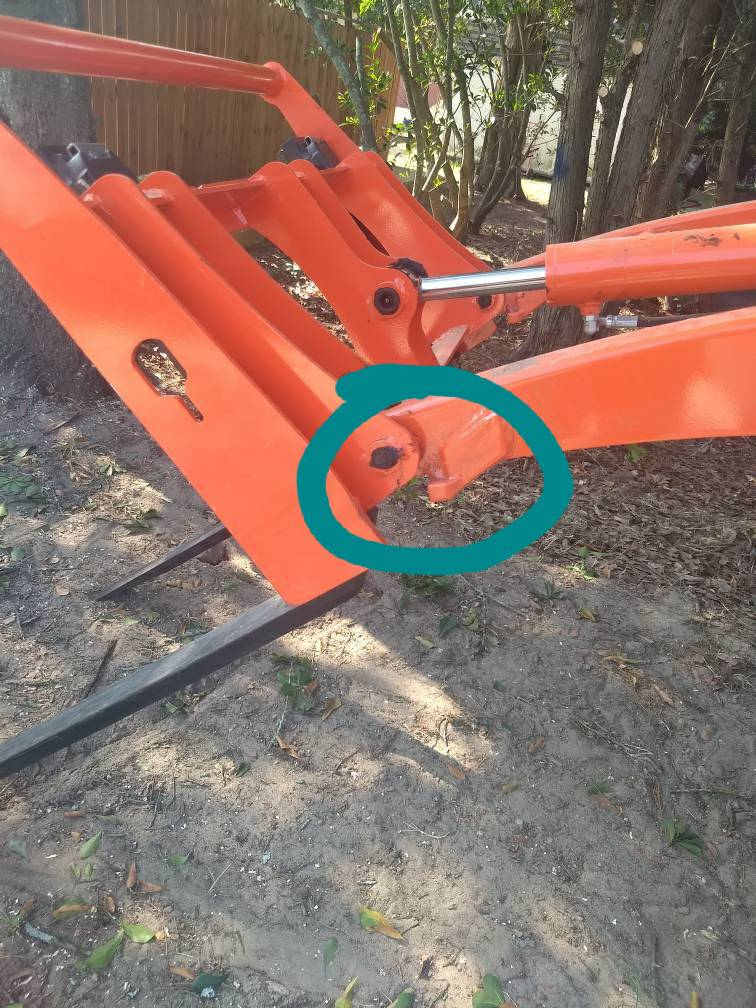

The stop is built onto the loader arm and contacts the bottom surface of the brackets for the lower pins. I can see the stops in the last picture

Ahhh. There in lies the problem. The aftermarket forks are not designed for the new loader. Look at the stops on the loader. Unless those are for the stand only.
Put a load on the forks. Let gravity pull them down a few inches. I think you’ll find once they drop a bit, it will work.
Did you specify your loader was an 80-Series when buying the forks?

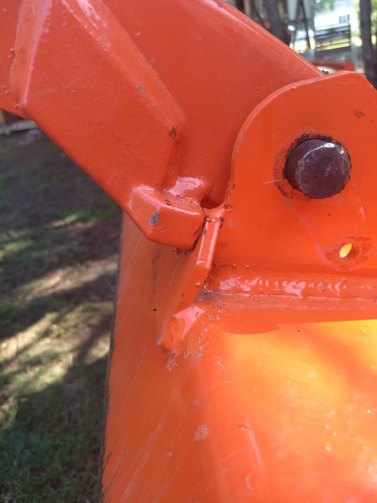

Here's the stops.
It appears there might be a difference in the stops between the swifttach loader and the standard loader, maybe that's the problem? Also why the stand doesn't work with the fork frame?

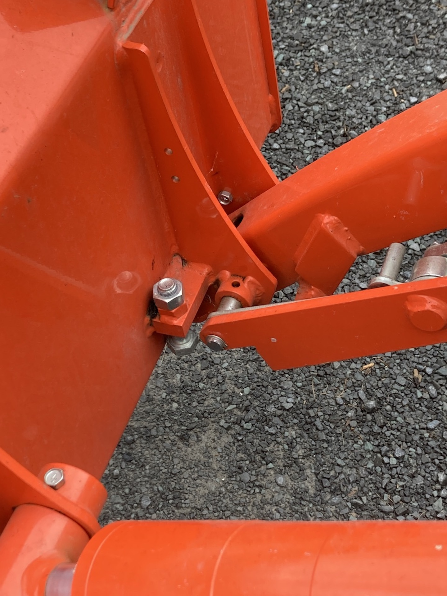

The stand doesn't work with the fork frame because it has no accomodations to mount the front part of the stand (by that I mean the end nearest the bucket.) With the front part not securely attached to anything the rear most part rolls out of the keeper and it all falls down.

So, it is designed for the new loader, but only "sorta" . My bucket is back on now and here is one side of the stops on the bucket for reference. All in all that wouldn't be terribly difficult to copy and fabricate.

Thanks for the help fellas! As soon as someone mentioned it extending to over center and no stops I thought that was probably it! Without y'all I wouldn't have known what to look for.

Yes, as mentioned that's the parking stand. With the bucket removed it just dangles.
So it attaches to the bucket? If so, it must attach at the same pivot pins the fork thing does. That is why i asked - wondering if that thing (stand) had anything to do with being a stop limt.

It's hard to explain but the stand attached to the bucket at the pivot pins and then is just very loosely attached everywhere else. It's hinged in the middle and has rollers in the back part that allow it to slide back and forth. I looked it all over hard to make sure it wasn't needed for anything aside from a loader prop before I pulled it off.

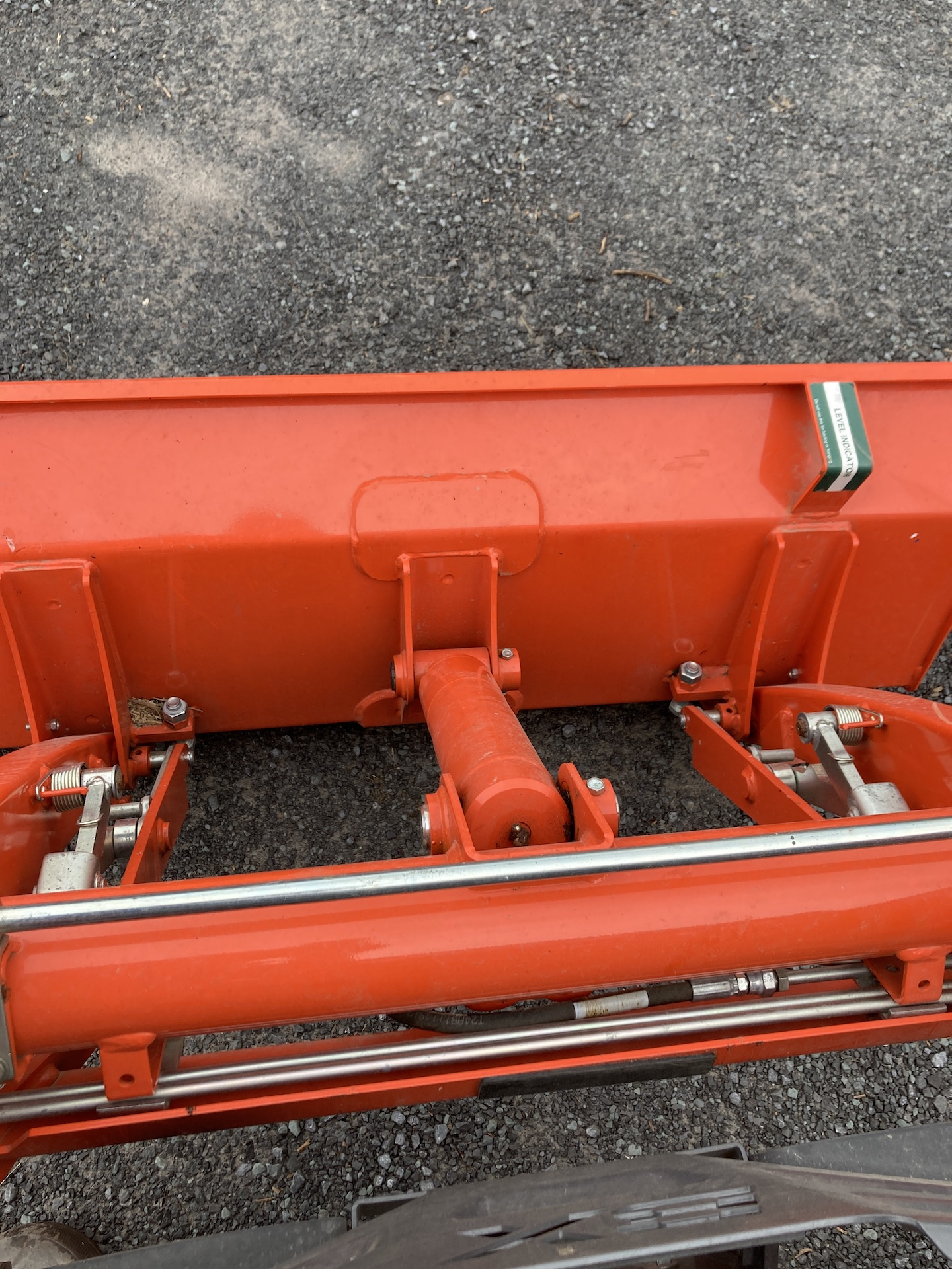

Here are a couple of shots of my LA344 with bucket and loader stand on. In case anyone wanted a reference on the stand.

Great pictures -- always a huge help in understanding/explaining.
