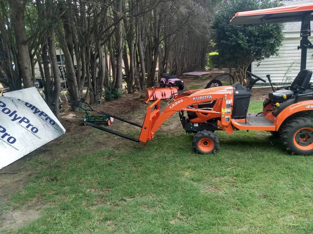

I have a new BX1880. 13 hours on it. I have a set of 42" Redline pallet forks. They weigh about 167 lbs, according to Redline, and they are pin on.
I've been moving brush with it. I've discovered that if I tilt all the way down vertical to dump a load, it won't tilt back up. I have to lower the loader arms until the fork tines are touching the ground, drive backward, and tilt up and once I get them to move a smidge then it tilts up fine again.
Any ideas? Is that center cylinder perhaps just not strong enough to pull that back in from full extension? I can't see that anything is binding. I can live with this and have figured out how to work with it (I try to just not tilt it quite far enough to do this) but I just want to see if anyone else has experienced this.

Sounds like the hyd cyl is going over center. The pin holes are not the same as your bucket or there is no stops on the forks. Might have to weld you in some stops.

I second this. I can almost guarantee that the spacing between the pivot and cylinder pin is just slightly closer than it should be allowing it to rotate too far. as an alternative to welding, you could put a limiting strap on.

What is that thing leaning against yor bucket?
This is what I was thinking about doing.

The thing leaning against my bucket is part of the parking stand. With the bucket off it just dangles so it has to be removed. Takes about a second and two screws.
