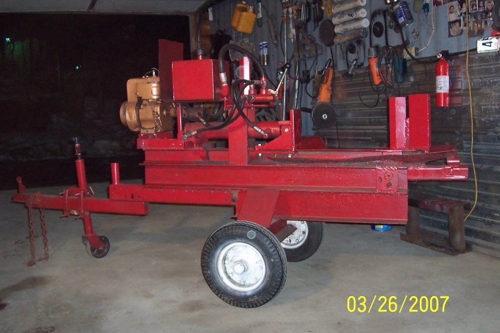

I Would have to know what i had in my future for projects,or repairs.If it involved alot of auto mechanics,then my choice would be torch.If it involved fabing a heavy duty tractor implement such as my thumb...than a plasma cutter.I have neither of my own ,but have access to them at work.In my own shop,its sawzall,but an even better thing i discovered in the lasT year,are these paper thin grinding wheelsfor my grinder.Ive tried alot of wheels in the past,bit the ones i buy now are the cats pajamas.can cut exactly on my marks ,quickly,through 1/4 inch angle,and just about any thing.There is no grinding when you are done its nice and smooth and even similar to a factory edge.Made by norton,cant recall what number sitting here:D If i got something major,like i just removed the wedge on my splitter,that 9 inch hf grinder made short work of it:D .I also cut steel in hard places with my welder:D .Bottom line is for most of what i do,having my own torches isnt sensible.The space they take up,and the contracts etc...i can survive just fine without for what i do.Thats why i have most every tool except my own torches.Heres a pic of my splitter i built with welder,grinders and a sawzall.
