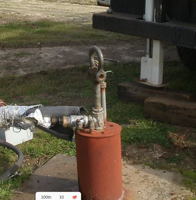

If any members here have a flexible well poly pipe, you must have this tool.

Exactly that was the reason I made this tool for emergency situations that no one could help to pull the pump.😄😄😄

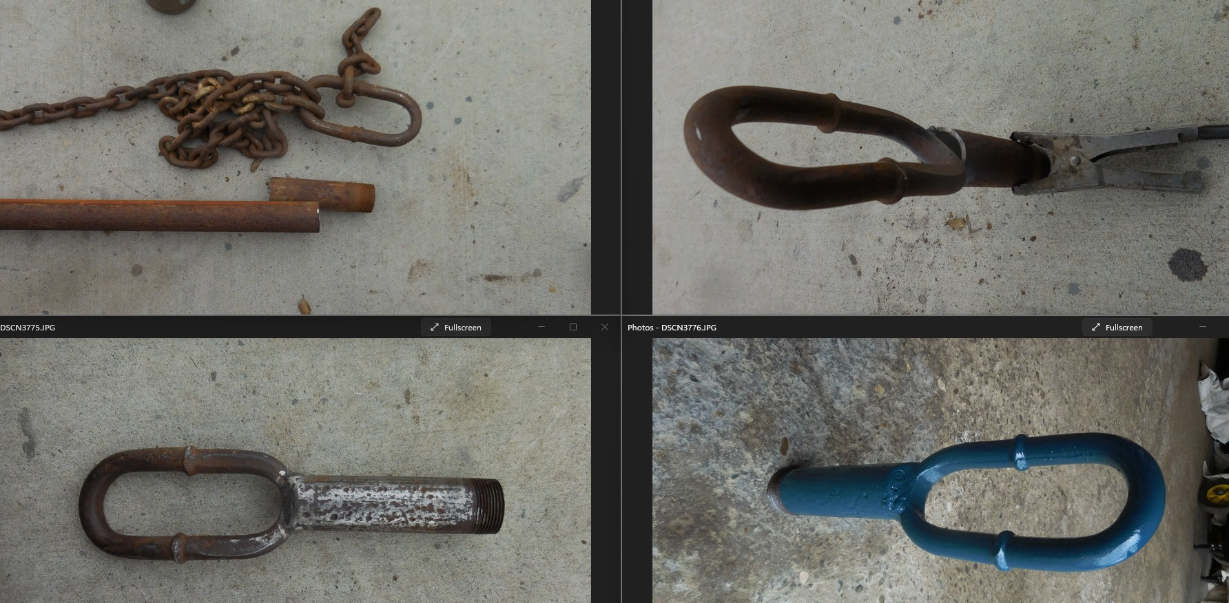

Last time when the drop pipe changed to the poly pipe from the galvanized 6 years ago, I saw an adapter the well guy was using to pull the pipe from the well casing.
It was very convenient for pulling the pipe.
I Just made pipe to pull it up out of the casing today from the recycled pipe and ring.
jkk
