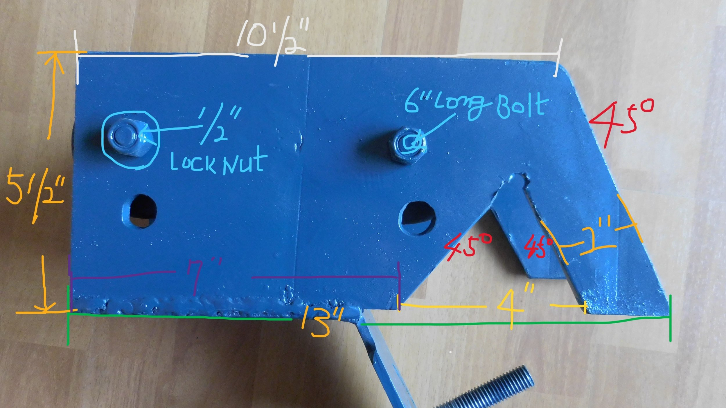

I know this video is not adequate on this site, but the tool is very important for people who have a flexible poly drop pipe and need to replace the pump in an emergency situation.
A Couple weeks ago, suddenly no water from the kitchen and bath faucet.
It could be a nightmare with no watering in the house and all the garden for a while.
First, I thought the well pump failed because the pump is 16 years old.
Fortunately, I found the cause was a broken main water pipe from the well and it was repaired by myself right away
It would be really absurd if the cause of the well pump failed.
Then I had to wait several days for a well guy to replace the pump even calling an emergency.
I don't even want to think about that situation.
I was really concerned about it and ever since I was looking for some tool for pulling the well poly drop pipe that I could pull the pump and replace the pump by myself in an emergency situation,
This video will tell how it solved the problem.
If you have any better thoughts, please share them.
Thanks
Jkk

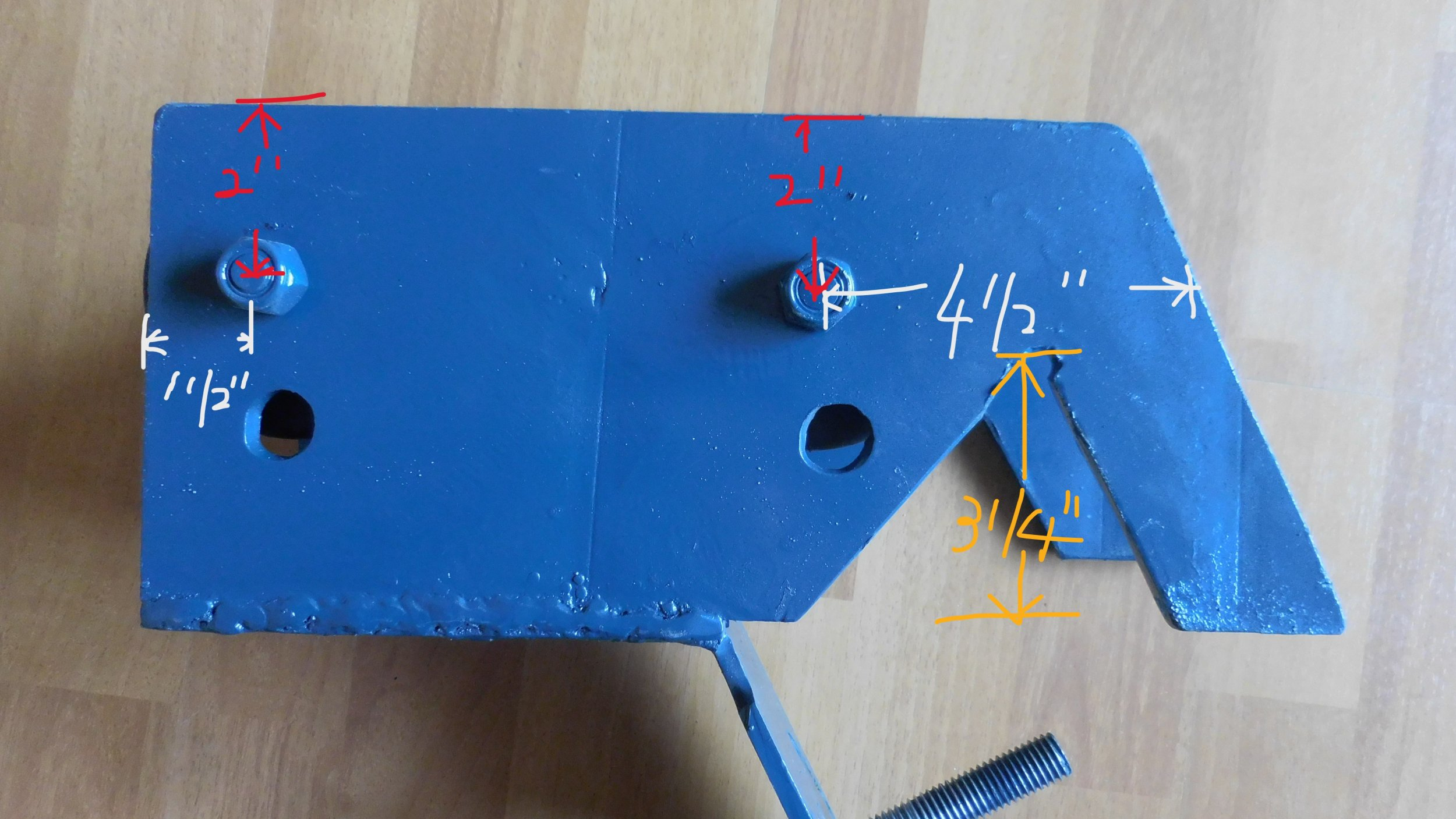

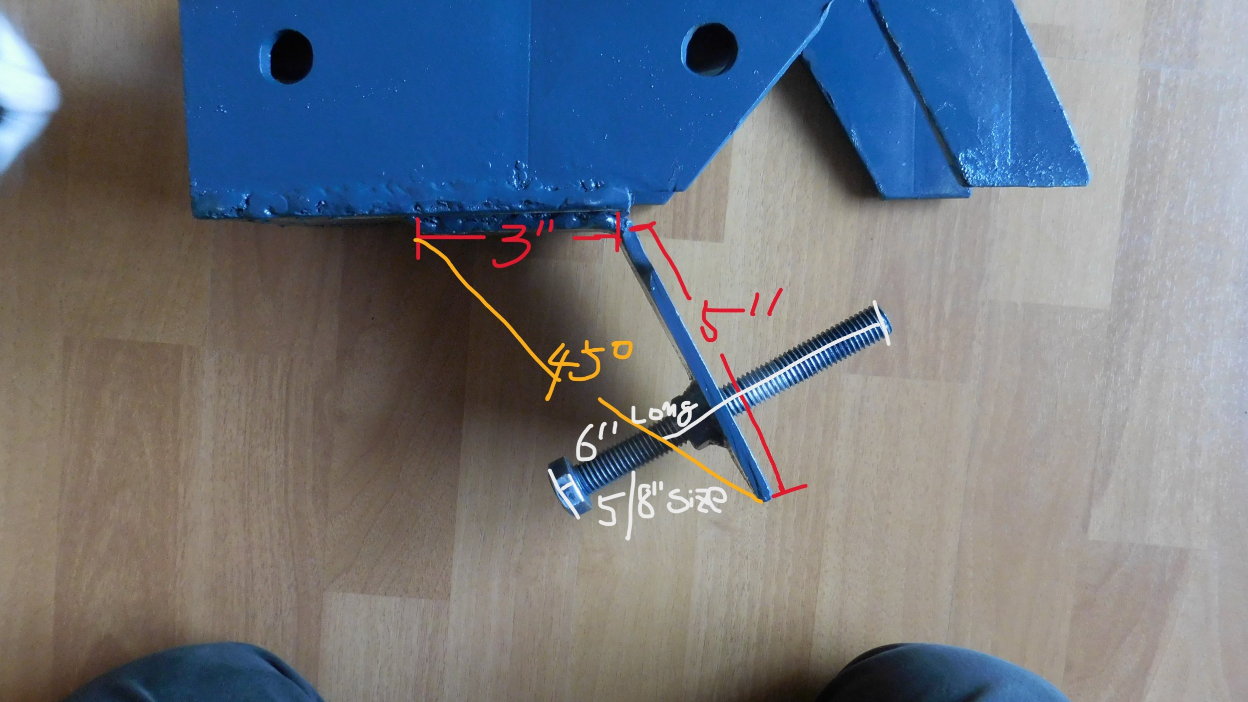

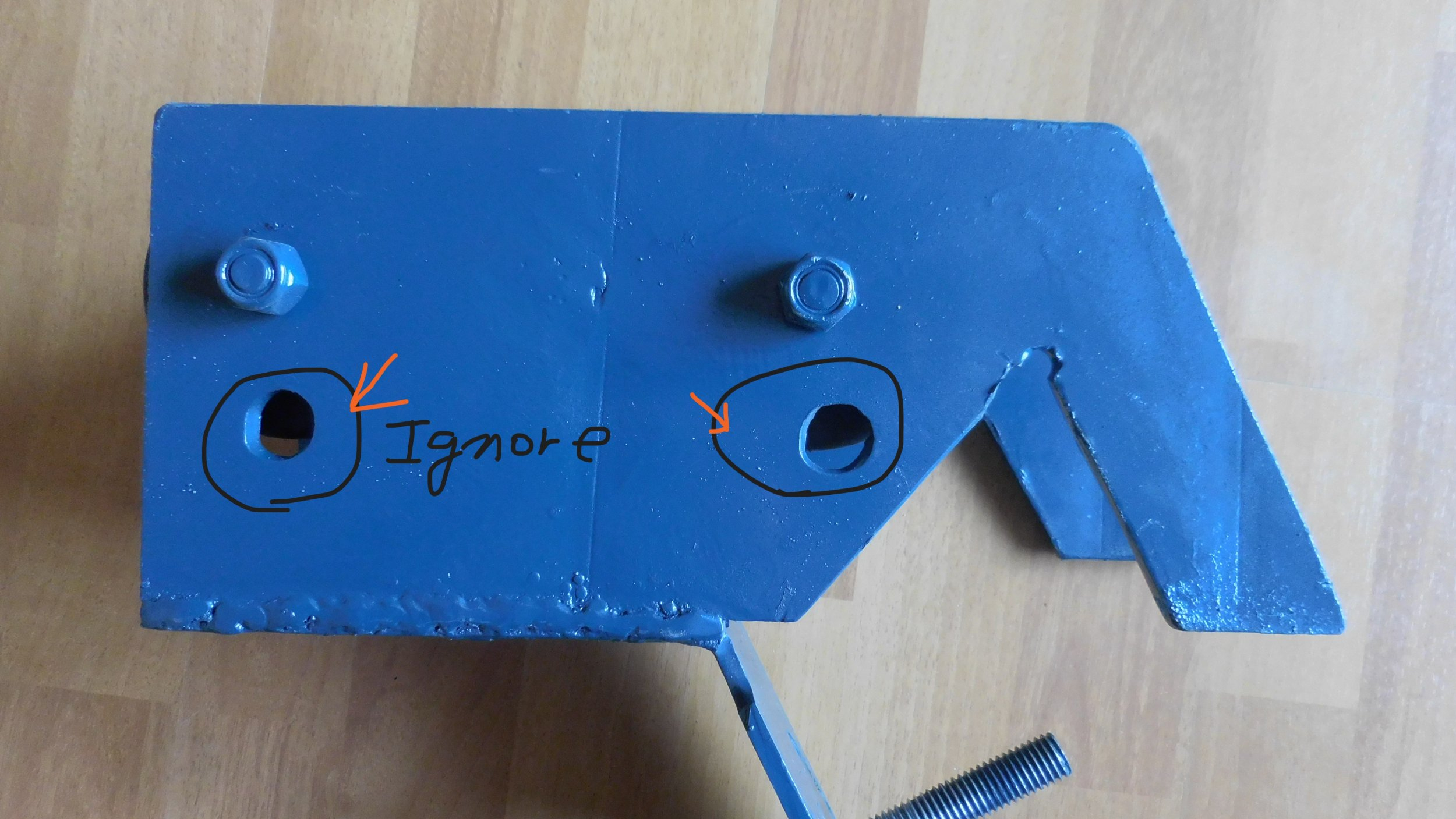

Could you attach a copy of the plan to make the puller.
   / If any members here have a flexible well poly pipe, you must have this tool.
I made diagrams for you 😉😉
The plate's thickness is 1/4" mild steel.
Please ignore the extra holes that were there when I bought..
If you have any questions let me know.
Thanks
Jkk

Anyway can you upload some pictures?
I love to see your tool.:giggle::giggle:

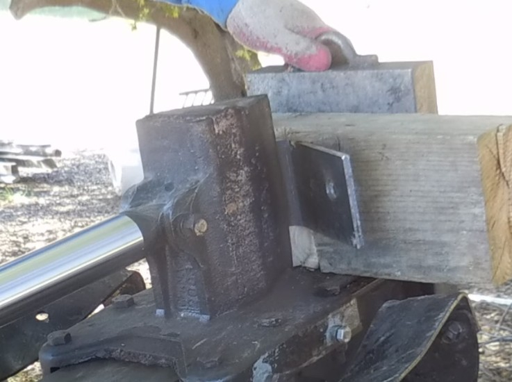

I don't need this tool, but I learned a way to straighten things with a wood splitter.
Not only way to straighten things with a wood splitter but to bend too...😋😋😋
