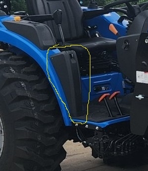

I'm hoping to become the owner of an MT242e tractor in the next few days. The economy models don't include this part as standard, but I'd like to add this cover to protect the cables. Does anyone know the part number for the cover for an MT242e? See picture below.
Update: I found this: Joystick cover Part # 40461663.

Looking at the diagram there is also a little metal bracket with screws and bottom screws for this piece. I'll be getting the same thing. Let us know how the upgrade goes!

I'm guessing I will have to get the dealer involved. I can't find the parts online anywhere. Unless anyone has any ideas?

As this is a brand new model, I'm sure the dealer is the only option at this time.
