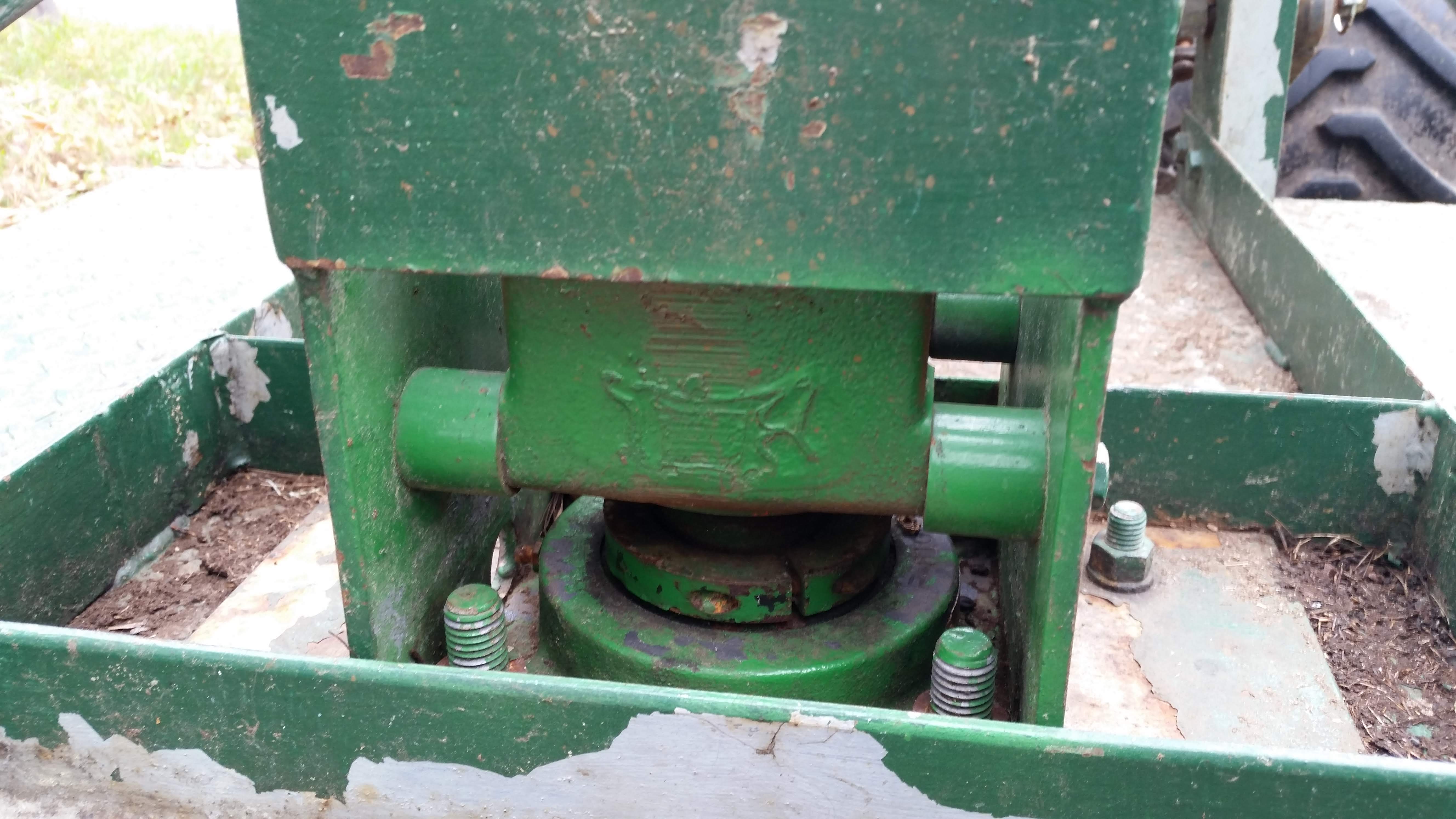

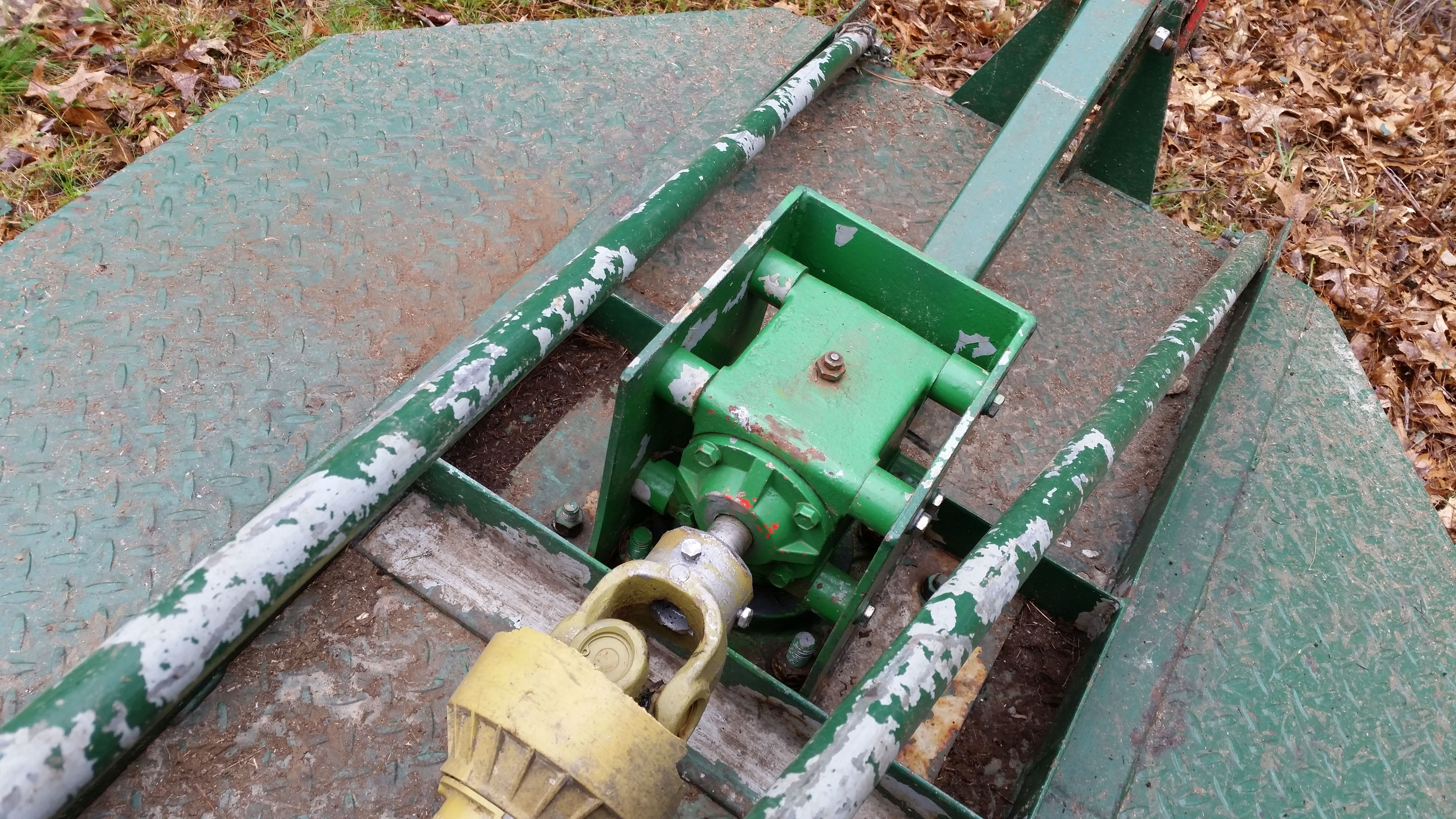

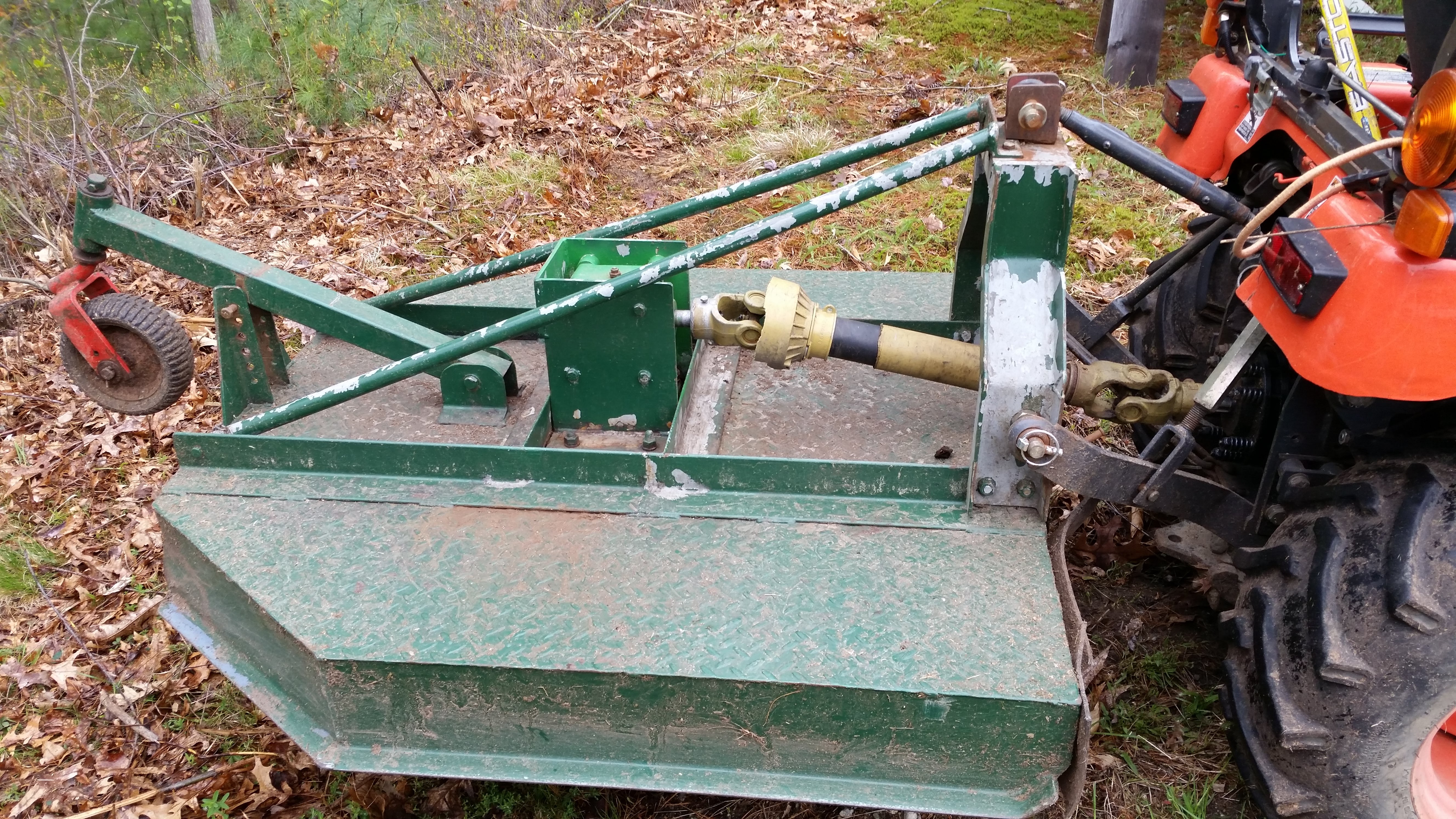

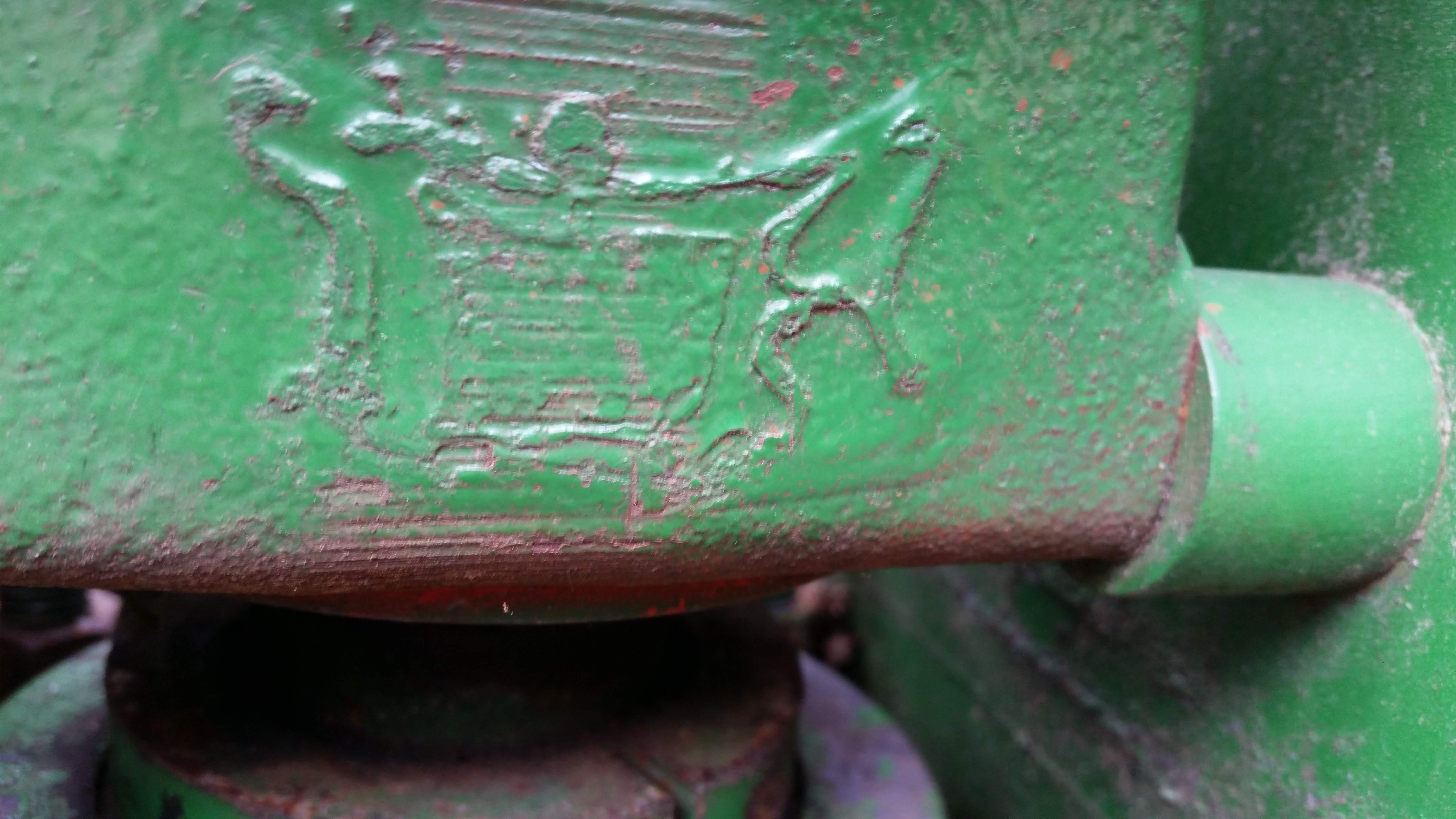

I have this drive system/gearbox on a flail mower. I think it came from a commercial finish mower. can anyone identify it for me? I hurt it getting to aggressive with stumps. looking to identify it to start with.

It's not a flail mower but a rotary mower generically called a "brush hog" and similar to many "Bush Hog" trade named cutters made by many manufacturers. All that matters is the gear reduction ratio (in case the gears are stripped or burned), or the bearings are shot from a lack of lubrication. Consider ebay as a parts and identification source.
/ Identify this if you can
Thanks for the reply. Figured someone on this site could identify what I have here. If I know what I have it will make the repair simpler to get going on.
RT
/ Identify this if you can #4
What is not working? Did you check for a shear pin? You might want to change the position of the pin on the trail wheel. You have it set to let the mower down as low as it will go. If you broke something on a stump, that may have contributed to the damage.
