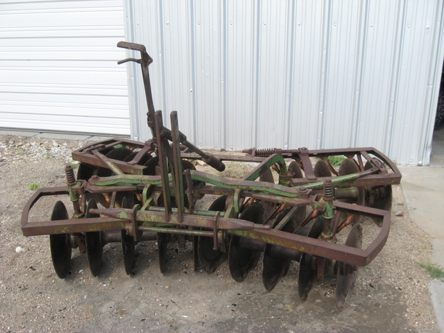

I can't tell you what brand it is, but to me it looks like it could be more than a 22hp tractor would want behind it, even with 4x4 and ag tires. Hard to tell how wide it is in the pic or how much it weighs, but with a 22hp tractor, you probably want to stay about 4 - 4 1/2 ft wide, but that's jmho.
/ Identify This 3PT disc? #3
The ad says it's 7' wide. There's no way a 22hp tractor would pull that unless it's so light weight that it wouldn't till the ground anyway. So, in either case, I'd say it's a complete no go.
/ Identify This 3PT disc? #4

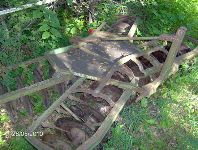

Not sure of the model, but it's a John Deere disk! I used to have one very similar to it I used with a JD 520 (35 HP) HPIM0793 (Small).JPG It would be way too heavy to use on a compact tractor at 7'!
/ Identify This 3PT disc? #5
Can anyone help me with any information on this disc? Particularly interested in approximate weight. Wondering if my 22 HP Kubota B9200 would handle it.TIA
3pt tandem disk - Nex-Tech Classifieds
I've seen 5HP per foot as a general minimum. That'd put a 7' disc at 35HP minimum. I think it's probably closer to 40 though, and maybe even 50' with large pans and heavy weight.
Definitely waaaaaay too much disc for your tractor.

Not sure of the model, but it's a John Deere disk! I used to have one very similar to it I used with a JD 520 (35 HP) View attachment 431897 It would be way too heavy to use on a compact tractor at 7'!
Yes I think they were made in mid late 50's and called/known as a JD KBL disc.
