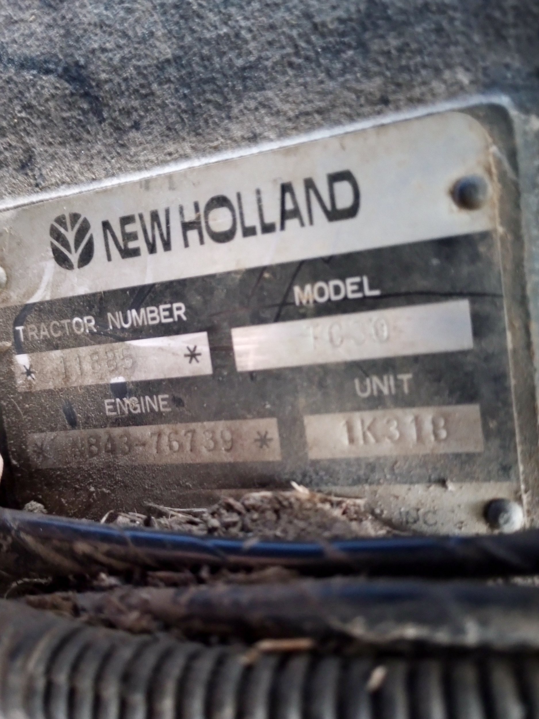

Dec 5, 2023 / Identification of my tractor #1 F FarmerBarbie New member Joined Dec 5, 2023 Messages 1 Tractor New Holland TC30 I have a TC30. I just found the identification tag, but have no idea what year it is. Can anyone help me?
Dec 5, 2023 / Identification of my tractor #2 Peter 315 Super Member Joined Mar 28, 2016 Messages 5,019 Location NH Tractor Kubota L3800 HST Kubota L47 TLB Tractor data shows 2001-2008...
Dec 5, 2023 / Identification of my tractor #3 A azbinder Gold Member Joined Jul 15, 2012 Messages 483 Location SE Tennessee Tractor Kubota B7800 Unit # says : 1K31B = Oct. 31, 2001, day shift
Dec 5, 2023 / Identification of my tractor #4 Avenger Veteran Member Joined May 16, 2018 Messages 1,506 Location North Idaho Tractor LS XR4145C I thought K was November? But Nov doesnt have 31 days... The first digit is the year, first letter is the month, then the day, and the shift.
Dec 5, 2023 / Identification of my tractor #5 A azbinder Gold Member Joined Jul 15, 2012 Messages 483 Location SE Tennessee Tractor Kubota B7800 Month JAN - A FEB - B MAR - C APR - D MAY - E JUNE - F JULY - G AUG - H SEPT - J OCT - K NOV - L DEC - M Day Numerical Date 1 through 31 Shift Midnight - A Day - B Afternoon - C
Dec 5, 2023 / Identification of my tractor #6 Avenger Veteran Member Joined May 16, 2018 Messages 1,506 Location North Idaho Tractor LS XR4145C Oh.... there's no letter I.
