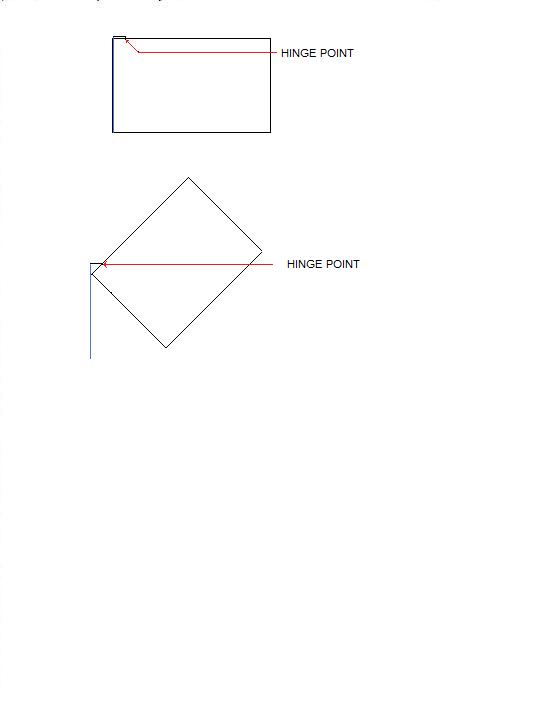

I had an uncle who used to manufacture ensilage gates that were automatic. No hydraulic or latches required . These gates were constucted with the hinge set a foot or more ahead of the rear of the dump bed. An 90 degree angle iron frame positioned the gate at the rear of the dump The gate's weight against the bottom held it closed. As the bed was raised, the center of gravity moved rearward causing the gate to open. The function of the gate relied on a pretty step dump angle. He sold a lot of those gates and many people copied them. I will try to find a picture. May even try to make a drawing, but it will probably be pretty low grade. You may be able to see on the drawing (if I got it attached) that the longer the distance between the hinge point and the back of the dump box the higher the gate will raise. Also height of dump box will matter also.

I like that idea and it would be easy to accomplish. Then I would only need the one cylinder to dump it. Keep the ideas coming
